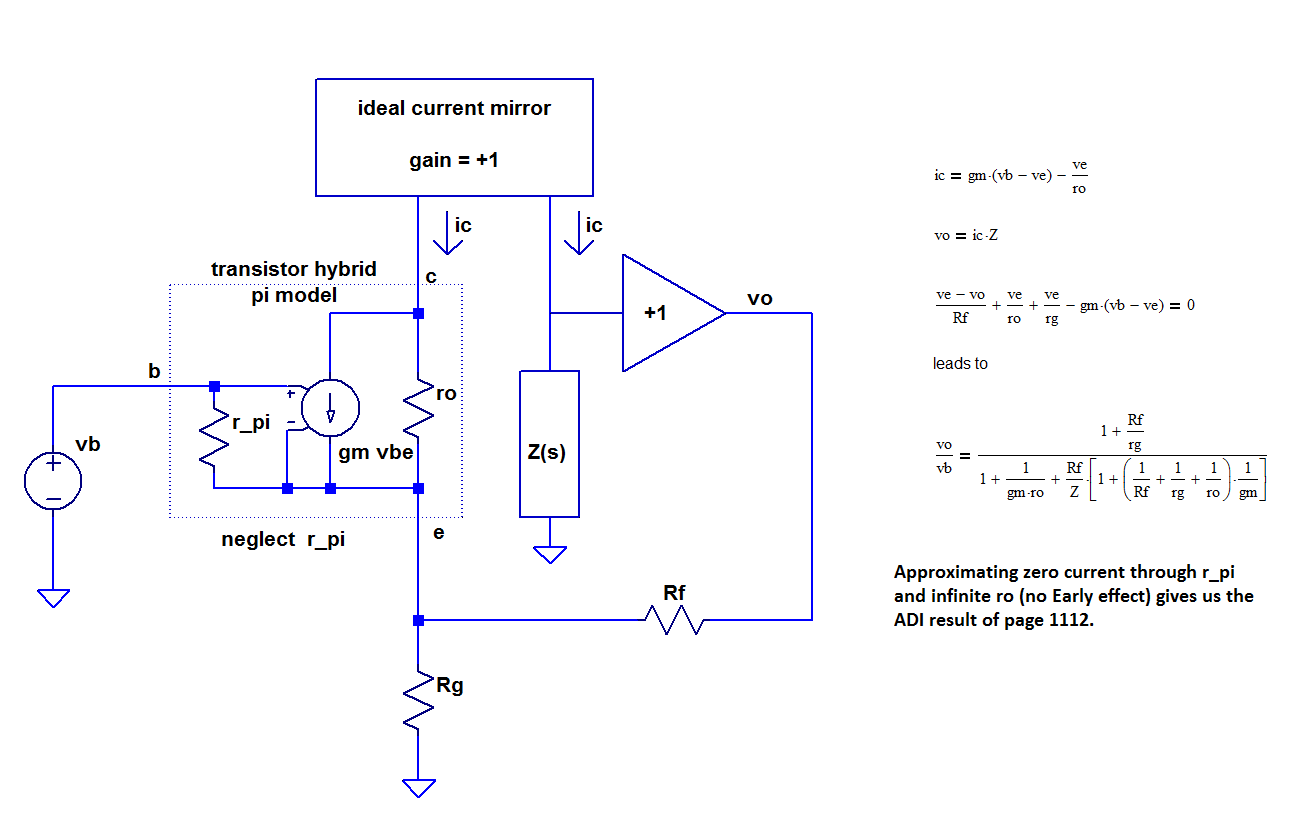

Please recall the hybrid pi model of a transistor with its vbe-controlled gm current source output in parallel with a resistor ro. It is derived for small signal operation directly from the Ebers-Moll model. ro and 1/gm combine to make up the Ro in the referenced post. I am not going to derive this; there are numerous sources on the web that you can find that will show you this if you are unfamiliar with it.
Now, you don't like sims. Will you next ask me to perform a bench test for you to demonstrate that there is a current that flows when Vce is held constant and vbe varies, and another one that flows when Vbe is held constant and vce varies?

And I hope you have considered after viewing post 1028 the possibility that the ro of the Early effect can be significant in determining AC collector current in the input transistor of a closed loop CFA.

The post demonstrates that the loop gain drives the AC value of vbe to such a low level that the AC current due to variations in vce (Early effect) becomes significant in comparison to gm vbe.
It is first found to be curious that the ratio of the AC parameters ic/vbe is noticeably different from IDC * q / (kT).
The discrepancy is resolved when we examine an input transistor alone under identical bias conditions and measure the AC ic/vbe at constant Vce, and AC ic/vce at constant Vbe.

Here's the math you requested.
attachment.php
