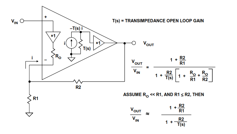

The consequence of the imperfection is that with a realistic, non ideal, input stage, we can't keep the input stage transconductance out of the game.
Absolutely correct. Here is the transfer function, courtesy of ADI. You can see how small the effect of Ro is, since for audio frequencies, the denominator of the expression is a very small amount larger than 1, akin to the error due to the finite open loop gain of a VFA.
attachment.php
To which I say, so what? What's your point? The signal current flowing in the input stage collector is still almost exactly equal to and almost exactly is, the current flowing from outside of the input stage through its emitter. Therefore, we have current feedback.
As if that were not enough, as I showed in post 1028 to which you still have not responded, the transistor is hardly acting as an ideal transconductor. In that post's simulation, the resistive element R_early between the collector and emitter due to the Early effect carries half the current that the voltage-controlled current source does. The high loop gain drives vbe to such a small value that the effect of the transconductance is significantly reduced. But that same loop gain can do nothing to reduce vce, and so that resistive element becomes significant.
You can say that the output stage causes a current to flow through the feedback network which interacts with the transconductance and R_early to create a voltage v_e at the transistor emitter which interacts with the impedance of a current mirror input to cause a current to flow through R_early and add to another current which is the result of the interaction between v_e and a voltage at the non-inverting input driving a transconductance.
Or you can say that you have current feedback.
