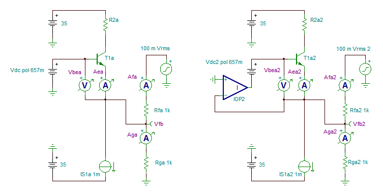

These days I was thinking of the transistors of the inverting output : can they be considered as operating in common base. My conclusion is that they can be common base only if the inverting load is a current source or if they are ideal.
Today I reread some texts I somewhat forgot on the topic.
Among them, Sergio Franco
https://www.edn.com/electronics-blo...ansistor-?utm_source=Aspencore&utm_medium=EDN
Your statement 'Whether feedback is called "voltage" or "current" is misleading' does not hold in the case of Fig. 6b. If you ground the input (Vi = 0), break the loop at the CFA's output, and inject a test signal into the feedback network to see what comes back to the CFA's inverting input, you see just a current - no voltage is fed back, as the input buffer keeps Vn fixed at 0 V. So, you can only refer to this state of affairs as "current feedback". You then easily see that the forward gain is zc, the feeback factor is 1/R2, and the loop gain is T = zc/R2. In practice, the input buffer is not ideal as in Fig. 6, but exhibits some small non-zero output impedance zn.
Sergio Franco, Walter Jung and many other authors are conscious of the imperfection of the buffer.
I simulated Franco's above proposed experience with my simplified CFA input stage. On the circuit on the right, the transistor is made ideal using an ideal op-amp. The currents and voltages make very clear that real CFA occurs only with unrealistic ideal transistors which allows a null impedance inverting input.
Certainly we do not live in perfection but I think that, there, the imperfection is noticeable enough to contest the current feedback concept.
I do not understand why the lack of an ideal CFA input stage debunks the claim of current feedback anymore than the lack of an ideal VFA input stage debunks the claim of voltage feedback.
