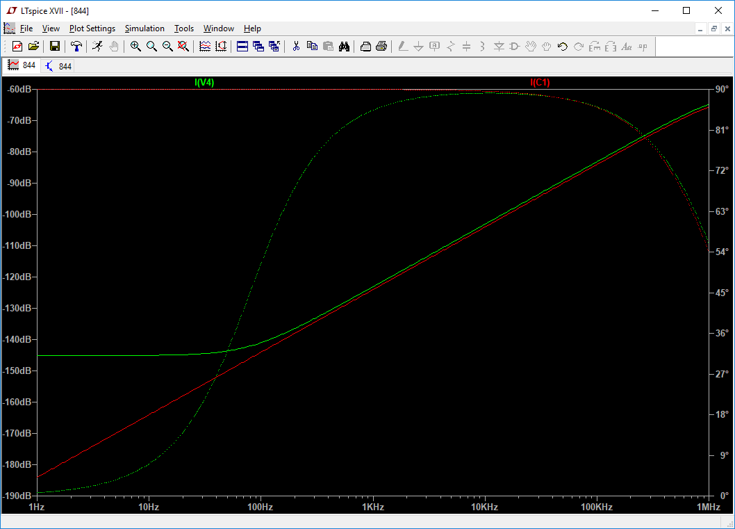

I spent (hopefully not wasted) my time this morning making a little sim. This is the simplified CFA circuit very similar to the one on the AD844 datasheet, made with BC550 and BC560 transistors (because I just moved stuff around on something else I was working on). This does not really matter.
This is connected as a voltage follower with a 1K Rf and the amp is compensated with 100pF so that the parasitic capacitances don’t matter. The inverting input current is monitored by a series voltage source. The green plot is current in the inverting input and the red plot is current in the compensation capacitor. The green plot is the open-loop transimpedance analogous to the open-loop gain in a VFA. You will see a DC value of -144dB (~15.8Meg transresistance) this is totally determined by lost current due to process beta and early voltage, super cascoding and other tricks like base current recovery could raise this considerably (see for instance the AD846) and move the low frequency break point around. It is at 0 degrees so it is not “positive feedback”. If I turned it into a VFA with 1K degeneration I would get an Aol of ~15.8k.
The two curves join as frequency is increased and the two currents are equal and at 90 degrees i.e. the current into the inverting input fully accounts for the displacement current in the comp cap and there is virtually nothing left over. You can eyeball about -104dB at 10kHz and do the math (2Pi*f*C). The point is the low frequency break point and DC value are essentially as unimportant as the DC open-loop gain of a VFA and its break point. A VFA voltage follower with an AOL of 10**7 is not 10X better than one that has 10**6.

Can you forward the spice file?

Certainly I could build a CFA IC out of 2N3904 and 2N3906 transistors, although I might not want to.
Why in post 1028 is ic/vbe so different from IDC q / kT?
And why is that difference so easily explained by examining that single transistor biased identically as it is in the sim, and first subjecting it to the AC vbe it saw but with VCE constant, and then holding VBE constant and varying vce?
Because these issues are like trying to figure out why does my amplifier have an open-loop gain of 1,000,000 and his has 10,000,000. So maybe the beta*VA product is 10X better. BTW the hybrid pi model misses the fact that changing the Vce also changes the base current in a real transistor.
