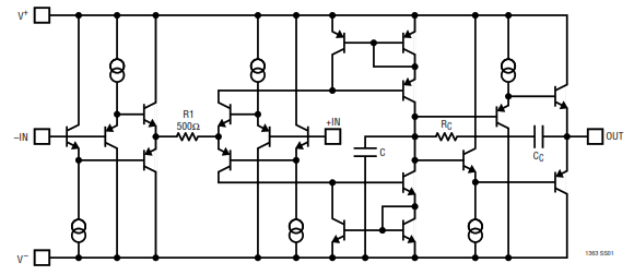

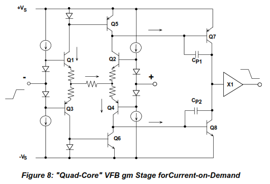

From the OPA690 datasheet:
"Typical differential input stages used for voltage feedback op amps are designed to steer a fixed-bias current to the compensation capacitor, setting a limit to the achievable slew rate. The OPA690 uses a new input stage which places the transconductance element between two input buffers, using their output currents as the forward signal."
In other words I guess its a H-Bridge inputstage.;)

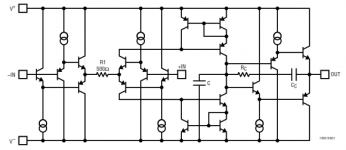

I know what an H bridge is in an enhanced VFA. What circuit are you calling a "double diamond buffer"? The input stage of this?

I'm not sure this is the point to take away from the above. Raw speed/power is usually related to the process in some way and the benchmark usually ends up being related to signal fidelity.
As was pointed out the statement above relates to a very specific case. A very large customer asked me to convert one of our CFA DSL drivers to VFA and with the same internal degeneration as Rf and tweak of the compensation the performance was essentially equal and set by the power/speed budget. The extra buffer is usually a trivial amount of the total power budget. I'll remind folks again that the heavy degeneration in the VFA usually brings degradation of DC specs like Vos, Aol, etc. just like with the CFA (of course not the -in current noise).
If you look at a classic LTP VFA vs CFA on the same process compare the AD811 to the AD797. If DC precision is what you want you can use tricks and matching but usually you would only bother in a VFA (different applications). Some will remember the long gone AD846 which was an attempt at a "precision" CFA which failed in the market.
