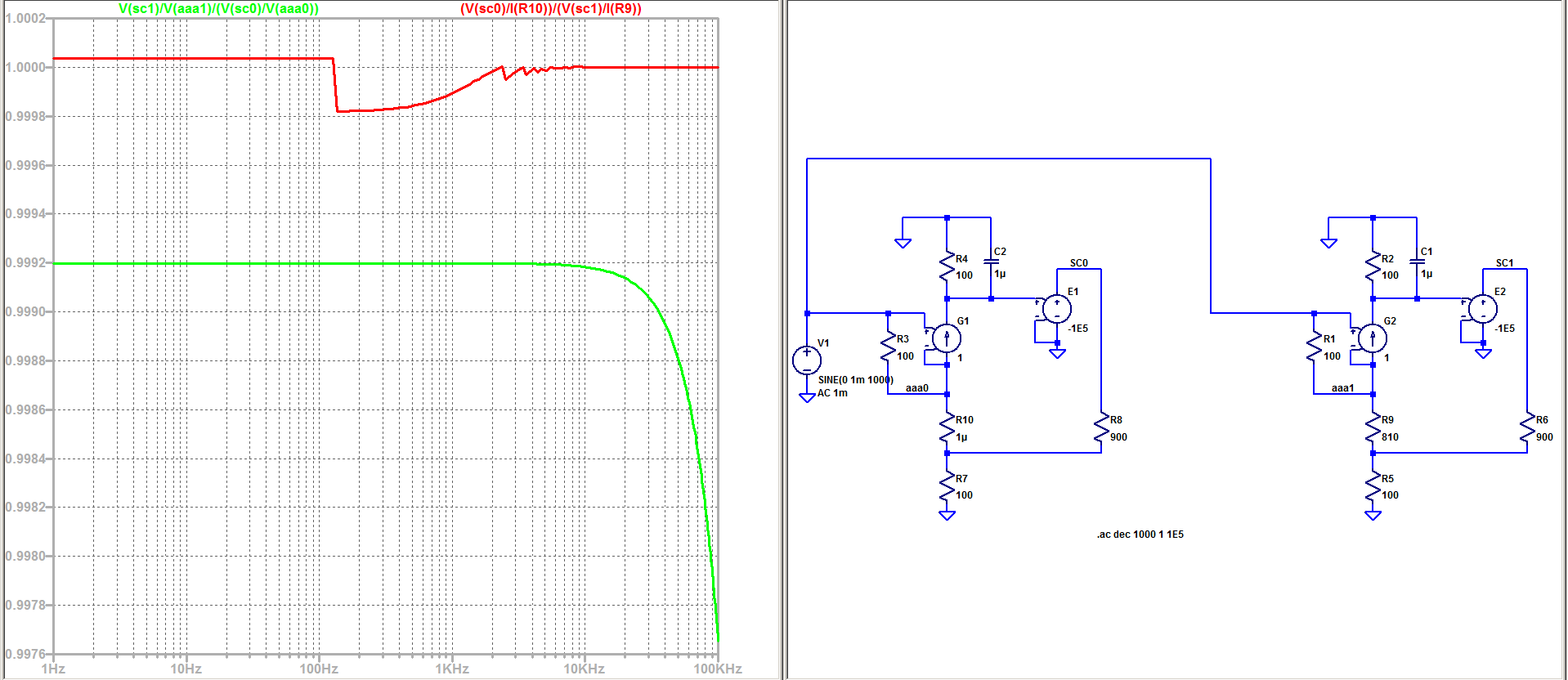

All,

All,
I did some simulations on a little "CFA" scheme in order to try to have the revelation of the true truth of death that kills on the nature of feedback in the "CFA".
There are 2 schemes, the only difference between them is that on the second I add a resistor between the 1st transistor emitter and the feedback network.
I have replicated and tested your circuit.
You will note that below 1kHz, only about 1nA flows through R9 and R10. Even if all that current flowed through R1 and R3, the voltages at aaa0 and aaa1 would be 1mV – (1nA x 100 ohms) = .9999mV. Of course the voltages are equal!
Now let’s test whether it is more accurate to describe the circuit as a transresistance amplifier or a voltage amplifier.
As you can see, despite the fact that the simulator is having some numeric issues, in this case, the transresistance model is more accurate.
Now please, no more diversions until you comment on post 956.

Strange, Jan - I can. Thanks for letting me know. Here it is embedded in case anyone else is having the same problem.
