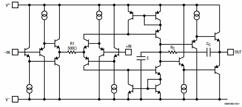

And as I said before I find it useful to look at the LT1364 schematic where we can see that the added buffer and 500R degen resistor isolate the FB network impedance and present a new, fixed OLG "gain" impedance. So I wouldn't agree that a whole lot has changed except that the "gain" impedance is fixed and constant and not depending on the FB network impedance... and that's just about the only difference of VFA vs CFA: the CFA's OLG depends on the external node impedance of the -IN, whereas in a VFA it doesn't.
But would you agree that in the non-buffered state the input device output current (ic) comes from the feedback network, while in the buffered stage it comes from the tail current, assuming a morph to a traditional LTP input pair by adding a single buffer device?
Not sure that your 1364 is morphing a CFA to a VFA though, its more adding another CFA rather than 'just' inserting a buffer; that would morph it into a regular LTP stage.
BTW I would give a lot if they had those R1 pins on the 1364 brought out to the package. The possibilities!

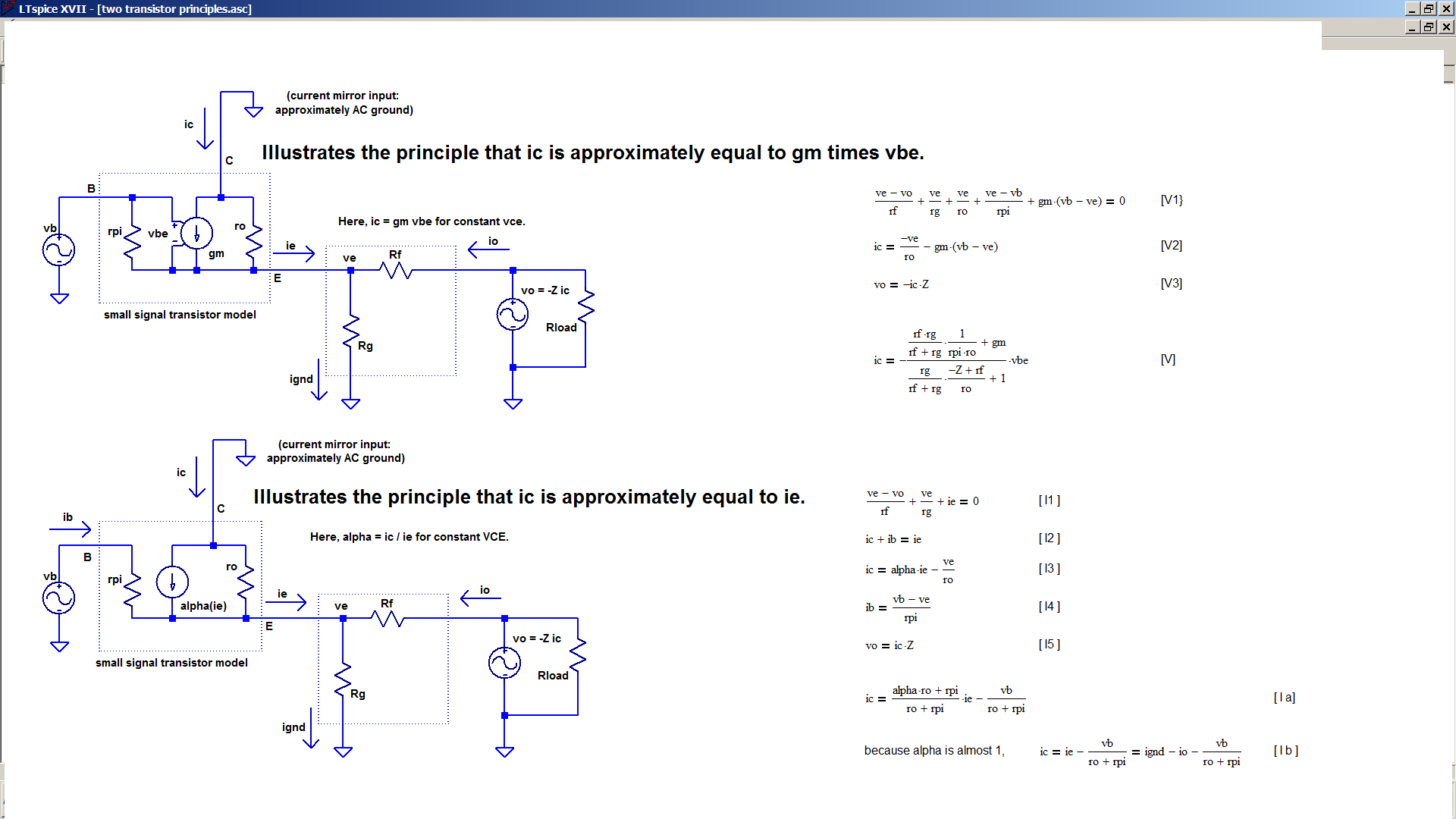

Some of those in this thread have focused like a laser on the fact that ic = gm x vbe. This has perhaps led to ignoring another fact: ic = alpha ie, where alpha is a dimensionless parameter slightly less than 1.
Fortunately, there exist well-accepted small signal transistor models that reflect each of these principles. In the attachment, nodal current equations of closed-loop CFA schematics are written by inspection and then solved for ic. The results are reproduced here:
Note how difficult it is to simplify the coefficient of vbe in comparison to the fact the coefficient of ie is approximately 1. For this reason alone, I prefer the ie formulation. Add to that the fact that ie = ignd - io, and we can now formally mathematically confirm the extent to which input stage current is in part output stage current.
Clearly, part of output stage current feeds input stage current in a CFA, just as part of output stage voltage drives one of the inputs of the VFA input stage.
In both cases, there is a feed "back".
In a straight forward application of language, VFAs experience voltage feedback and CFAs current feedback.
If you still contest this claim, you must believe that there is a flaw in this logic. It should be easy for you to point it out.
Will you?
Re #946 / LT1364 --- The 500 Ohm resistor is known as a series peaking R. The chosen value uplifts a slow HF roll-off and extends the -3dB Freq response . flat further.

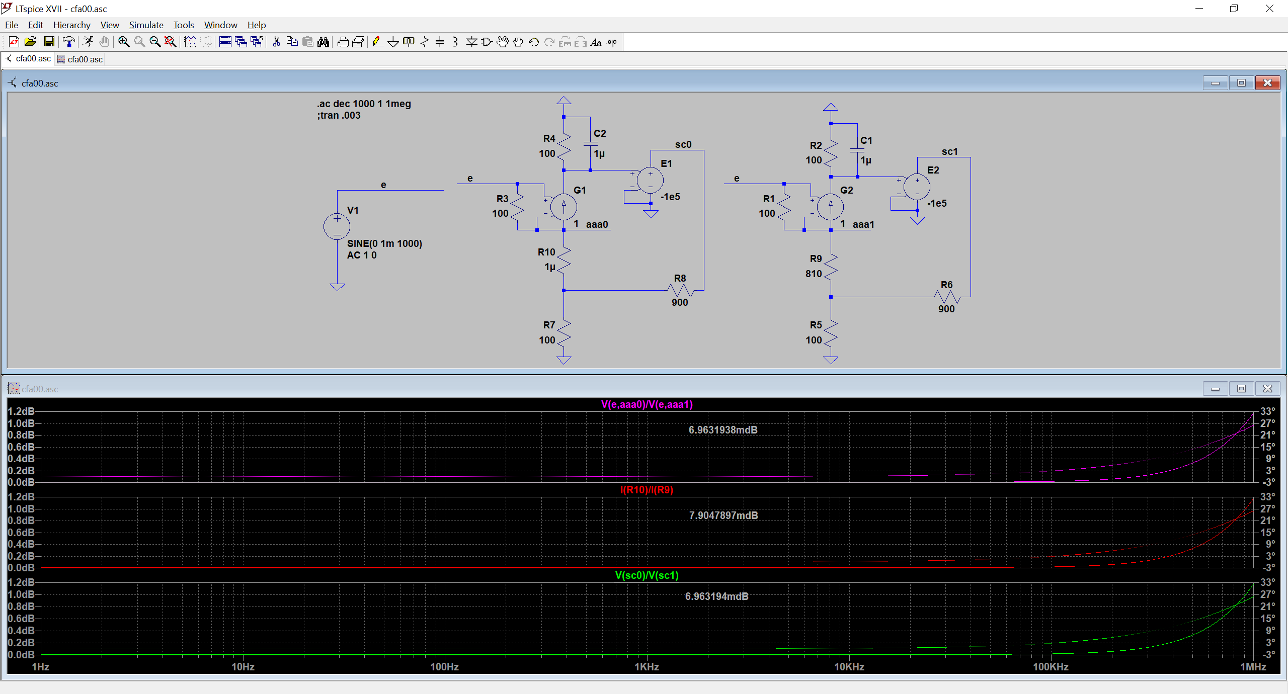

All,
I did some simulations on a little "CFA" scheme in order to try to have the revelation of the true truth of death that kills on the nature of feedback in the "CFA".
There are 2 schemes, the only difference between them is that on the second I add a resistor between the 1st transistor emitter and the feedback network.
1) This doesn't change very much the gain which is around 20dB
2) I plot :
- the ratio of the output of each scheme
- the ratio of the emitter current on the first transistors
- the ratio of the Vbe of the first transistors.
We can read that output are not exactly the same, that is not so surprising.
The ratio of the emitter current of the first transistors is not equal to the output ratio.
The ratio of Vbe of first transistors is exactly the same as the ouput.
I am pretty sure that inexperienced beginners ignoring 3.5 billions years of audio electronics history would conclude that we are not in presence of "current feedback" but may be something else.
But you are not inexperienced beginners ?
In a black-box approach the innards are totally irrelevant, aren't they? With a black-box all we need to observe is a strong dependancy of OLG vs -IN node impedance, or in other words look for non-zero current in/out of the -IN in open-loop conditions (other than bias current) with that current being "in sync" with the input differential.Interesting. For me that would be THE difference that makes a CFA a CFA.
Never heard of that term but the effect is indeed quite obvious. Effectively 500 Ohms seems a bit too low for a perfect flat (Butterworth) unity gain response but Mfgrs live off of BW specs so they opted to compromise phase margin at unity gain.Re #946 / LT1364 --- The 500 Ohm resistor is known as a series peaking R. The chosen value uplifts a slow HF roll-off and extends the -3dB Freq response . flat further.
