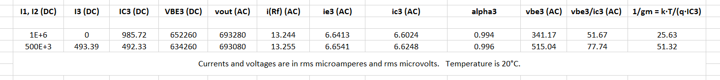

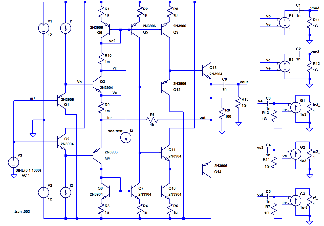

I have some simulation results that appear to invalidate something I once thought was at least a legitimate statement about CFA operation: I had believed that the transfer function of the inverting input transistors is a simple transconductance.
No more!

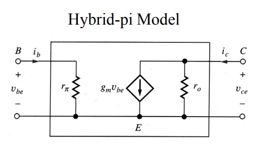

The collector-emitter output impedance ro becomes a significant player when the loop gain drives the AC vbe to very low values. Allow me to present some data to support this claim.
The first attached schematic and LTSpice file is a discrete transistor simulation of the “simplified schematic” found in the LT1395/LT1396/LT1397 datasheet. I have replaced the input transistor (Q1, Q2, Q3 and Q4) bias components with simple DC current sources I1 and I2. Varying these allows experimentation with input transistor transconductances. Source I3 compensates all other transistors for these variations and holds their biases and therefore operating points constant. Accordingly, the circuit’s demand of ic3 AC current is also held constant. The five simple circuits arranged vertically on the right support the measurement of the AC-only signals vbe3, vce3, ie3, ic3 and i(Rf). I’ve collected data for two different sets of biases. Results are in the table below.
As expected, the transconductances as calculated by the reciprocal of vbe3/ic3 differ noticeably due to the change in operating point – by a factor of about 1.5 - but the AC voltages and currents and the alpha ratio of ic3/ie3 differ hardly at all – by no more than 0.4%, and typically much less than that. Significant variations in transistor transconductance simply have no effect on the rest of the circuit’s performance (except for the amplitude of vbe3!). It is the transimpedance of the total gain block which is critical.
This point alone does not support the surprising claim at the beginning of this post. But there’s another issue - the mystery here: why are ic/vbe calculations so different from those of the standard transconductance calculation IC·q/(k·T)? The answer is the transistor resistance ro between the collector and emitter, which is in parallel with the vbe-controlled current source. In many cases we can ignore ro in comparison to gm·vbe. But as we shall see, not in this one! The high loop gain drives vbe to very small values, and vce/ro becomes significant in comparison to gm·vbe.

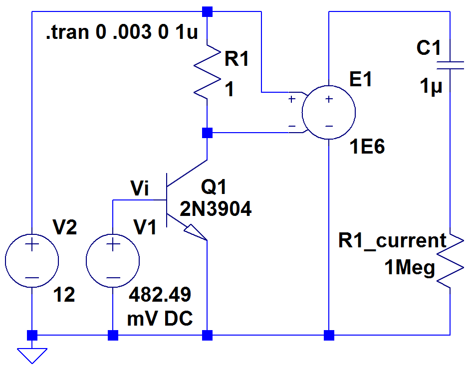

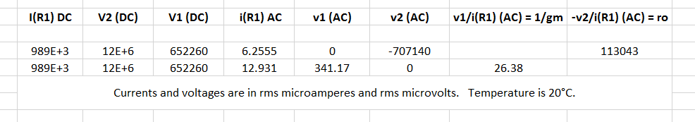

Consider the second schematic and LTSpice file. Here, to calculate gm, we simulate the AC collector current produced by the AC portion of the vbe voltage when VCE is held constant at 12V. We then calculate ro by simulating the AC collector current produced by the AC portion of the V2 voltage when VBE is held constant. Both AC voltages arise in the first schematic from the application of a 1kHz 1 volt peak Vin signal. Here are the results:
Now we see that the transconductance reciprocal v1/i(R1) (AC) in the second table is much closer to that calculated from the IC3 DC current in the first table. And, since the two AC collector currents in the second table subtract rather than add, we calculate the total current to be 6.6815uA, which gives us something very close to the AC collector current ic3 of the first table.
The conclusion is clear: The transconductance paradigm alone cannot explain the operation of this particular CFA, and therefore cannot be counted on to do so reliably for any other. And so, the voltage feedback explanation of CFA operation fails. But the current feedback explanation is untarnished by the results of this investigation. Nor will the ratio of these two currents in any other CFA sully it.

Maybe you can help me a bit in explaining your findings. gm is Ic.q/(k.T) at Vce = 0 Volt only. And ro is (Va+Vce)/Ic, where Va is the early voltage of the transistor.the mystery here: why are ic/vbe calculations so different from those of the standard transconductance calculation IC·q/(k·T)? The answer is the transistor resistance ro between the collector and emitter, which is in parallel with the vbe-controlled current source. In many cases we can ignore ro in comparison to gm·vbe. But as we shall see, not in this one! The high loop gain drives vbe to very small values, and vce/ro becomes significant in comparison to gm·vbe.
When replacing the 4 input transistors in your model with 4 generic transistors, having a Va at infinity, the two calculations vbe/ic3 and k.T/(q.Ic3) are exactly the same at 52 (with 2*0.5mA + 439.39uA) Placing resistors par. to Q3 and Q4 to simulate ro, a value of 200K has to be used to get the vbe/ic at 77, being the value that LTspice calculated for the 2N3904 and the 2N3906. 200K=(Va+Vce)/Ic, giving a Va = 89Volt, which is quite good.
So as far as I'm concerned, everything behaves like expected, but you mention to have found some discrepancy in the voltage feedback explanation that I haven't understood. So maybe you can give some additional info to explain why the VFA explanation is crippled by this ro.

In posting #1037, I had only given Q3 and Q4 an output resistance ro. When also giving Q1 and Q2 the same output resistor ro, I come to an even better Early Voltage calculation of Va=132 for the 2N4904/2N3906. So the ro of Q1 and Q2 also contribute significantly the equation. Also inserting even more accurately a base resistance Rbb, up to 100 Ohm, hardly makes a difference at all.
But the Early Voltage Va either being 89 or 132, my question from #1037 remains the same.

Maybe you can help me a bit in explaining your findings....

Hi Hans, I'm glad for the chance to explain myself better.
Let us approximate the current mirror input that terminates the CFA input stage transistors to be an AC short.
Suppose we opened the CFA loop, applied an AC voltage source Vin to the non-inverting input, and applied a second source to the inverting input.
To see what happens, let's consider a transistor small signal model:
![sst.png sst.png](https://www.diyaudio.com/community/data/attachments/656/656951-6b7c69c91c7a4a09b53439257fdb99b9.jpg)
If the second source were a voltage source V2, the collector current would be gm (V1 - V2) - V2 / ro (approximating rpi as a short.) One set of folks claims that the transistor acts as a simple transconductor gm (V1 - V2). But this is only true if |gm (V1 - V2 ) | >> | V2 / ro |. In closed loop operation, however, the high loop gain drives (V1 - V2) to be very small, but does nothing similar to -V2. And so the inequality is no longer true. So now we have the actions of a transconductor driven by one voltage combined with that of a second voltage divided by a device resistance. It's certainly no more the simple transconductor that has often been claimed.
But if the second source were a current ie, the relative values of V1, V2, gm and ro simply wouldn't matter. ic would always be alpha times ie. And the value of alpha is rather stable under all conditions, being slightly smaller than unity.
In a CFA IC, vo = ic T(s), where ic is the input stage output current and T(s) is a large impedance characteristic of the IC. This means that regardless of loop gain, vo = alpha Z ie. There is no single voltage associated with the input transistors in a closed loop CFA that is part of a similar relationship to vo.
I think you are over complicating this. The fact that in the real world beta and VA are finite is an inconvenience, in fact their product is a basic process metric telling you, for instance, things like the maximum voltage gain you can get from a single common emitter stage. That is basically DC parameters like Aol, CMRR, PSRR, Ib, etc.
The hybrid pi model is only really useful for small signal analysis around a single operating point. No simulator is based on this model, Ebers-Moll would be a better start.
