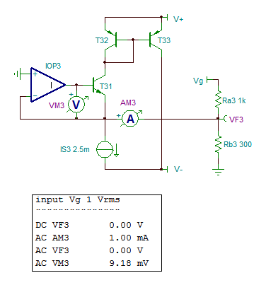

Now say there is a distortion mechanism internal to the whole amplifier, well there is identically zero volts across the + to - input so the error appears totally as the voltage caused by the CURRENT through Ra1 into the - input.
OP3 is hoped to be a VFA....
OP3 inverting input which has a high impedance controls the voltage at T1 emitter (which is at low impedance) and across the Rb3 forcing it to be almost null, i.e. making them an almost perfect virtual earth.
But, despite the apparence, it is not the current in Ra3 which controls the circuit but the minuscule voltage difference (justifying the underlined almost above) between the op-amp in+ and in- inputs. Once again the feedback process is seen to rely on a voltage difference, the circuit is under the control of th VF op-Amp.
In the above circuit,
- discarding Tr3
- connecting the op-amp outpu to in- and to the output to the common point of Ra3 and R3b
- sensing the current circulating in the power supply connections
gives an equivalent which is sometimes seen.

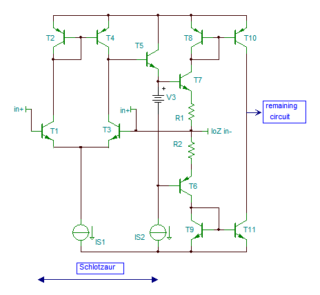

I thought of such a circuit, something like below. The input stage is based on a Schlotzaur circuit. Of course, I won't never describe the complete amplifier as being a CFA because it is controlled by the voltage difference between the in+ and in- inputs.
The Schlotzaur circuit has very low distortion, but the current mirrors may compromise the overall performances.
