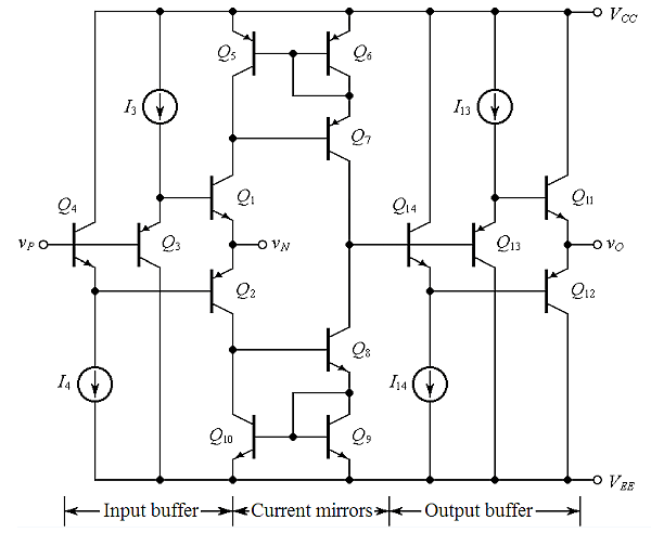

It is not global feedback, the loop is broken.
The circuit can play the role of a non-feedback virtual earth.
Approximately.
Come on forr. This is a standard and well accepted analysis technique - see Middleton

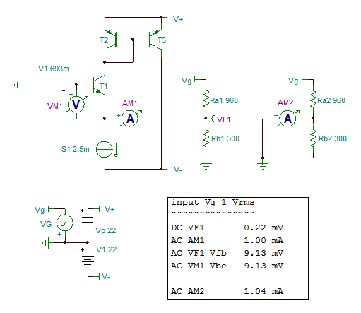

Here, inspired by figure 3 of S. Franco's article,
In defense of the current-feedback amplifier | EDN
here is a simplified CFA input stage with the injection of a current at the inverting input (emitter of T1) which has been set to 0 DC by V1.
Ra1 was adjusted so as to obtain an AC current of 1 mA entering the inverting input. The quiscent current of T1 is 2.5 mA, defined by constant current source IS1. This leads T1 to present an impedance of about 10 Ohm on its emitter and a transconductance of 100 mA/V
As the non-inverting input is connected to ground, the inverting input is expected to behave like a virtual earth, without presenting any AC voltage. Ideally current sensed by AM1 should be equal to current sensed by AM2, voltage across Rb2 being null. Here these currents are respectively 1.00 and 1.04 mA.
AC voltage at VF1 is equal to the Vbe of T1, and is 9.13 mV. It is in good accordance with the AC current of 1 mA sensed by AM1 and the transconductance of T1 of 100 mA/V.
Conclusion : the correlation between the input stage AC current (Ie of T1) and the AC voltage accross the inputs (Vbe of T1) is high.
This is in serious contradiction with the notion of current feedback.

Hint: think of local feedback in the 1'st stage through feedback resistors beyond "ideal" operations, i.e. when OL gain decreases and phase shift increases with frequency. ;-)
