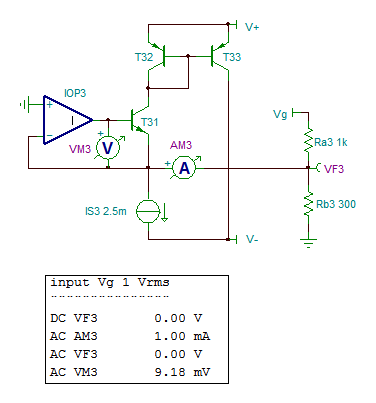

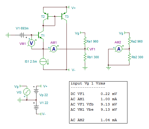

Referencing to post #447 ( Current Feedback Amplifiers, not only a semantic problem ? ) we see that the inverting input at emitter of T1 does not constitute a very good virtual earth :
631898d1503611912-current-feedback-amplifiers-semantic-amp_nocfa-9-vbe-png
However (in simulation and at low frequencies) this can obtained by using a local feedback using an op-amp to drive T1 which becomes T31 in the next schematic :
attachment.php
Inverting input AC voltage VF3 is now 0V, it's an ideal earth input.
Ra has been slightly modified to get an emitter AC current of 1 mA for T1.
The AC load of T1 emitter is Ra3, passing a current modulated by Vg.
AC voltage of T1 Vbe controls the required AC current to this load. Its value VF3 at 9.18 mV is very similar to V1 at 9.13 mV in the first schematics.
It occurs to me that considering the Vbe voltage to deliver the required current to the emitter load of V1 is, in all cases, the best way to correctly analyze this kind of input stage having a low impedance inverting input.
Ironically forr your last diagram illustrates the point perfectly. As an op-amp the inverting input stays the emitter of T1 while the non-inverting input becomes the + input of IOP3. Now say there is a distortion mechanism internal to the whole amplifier, well there is identically zero volts across the + to - input so the error appears totally as the voltage caused by the CURRENT through Ra1 into the - input. Notice further that the voltage across Rb1 follows the input exactly so all errors are referred to output via Ra1 independent of closed loop gain. This includes noise current and any displacement current in the compensation capacitor.
The diamond transistor arrangement is simply an imperfect current conveyor, the addition of the op-amp makes it almost perfect. The GBW is still determined by the feedback network and now obeys the CFA behavior even more. Yes this arrangement can have some compensation issues but that has nothing to do with the fundamental operation. I have built these with IC's BTW and they can work.
