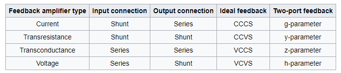

Forr, to save us time: are you familiar with the 4 basic feedback topology classifications like in the attachment? I mean the 'traditional' classifications before the advent of the 'CFA opamp'?

That is sometging that also leads to recurring confusion here. Indeed, in the original 4-class classification, current feedback denoted feedback representing output current, but the feedback signal itself is a voltage (normally).
In the 'modern' CFA term, it denotes feedback that represents output voltage, but is returned as a current - or this is the claim.
The discussion raging now is whether, as is claimed, the feedback is returned as a current. This is separate from the classification issue, which I believe everyone accepts as an unfortunate state of affairs, but will not go away. ADI, TI, LTC, who have you, will not change their term CFA in the modern sense.
So we are debating: is the feedback returned to the inv input a current or not.
Unfortunately, when cornered, people like MK switch to the 4-classification issue again and again to cop out of the CFA discussion when it is not going well for them. A clear sign that they are not interested in solving the issue but more into arguing for it's own sake.
Such tactics will keep it going indefinitely.
