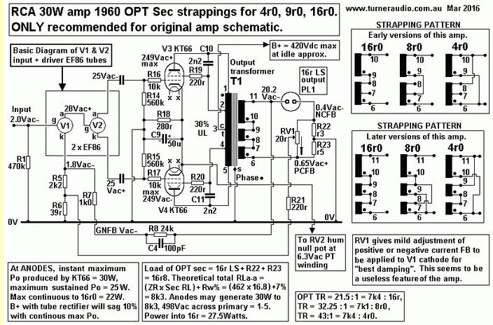

Here you have pos. and neg.CFB, also (neg.)VFB.All going to the cathode of the first tube = called CFB today 😕
So there is voltage to current feedback and current to current feedback 😀
Mona
Mona
Feedback is based on subtraction of two signals. In your valve amp, it is realized by V1 which senses the voltage between g and k to control the current though it. You can do a lot of things with the feedback networks, the fundamental, physical, law to which V1 obeys is unique.
