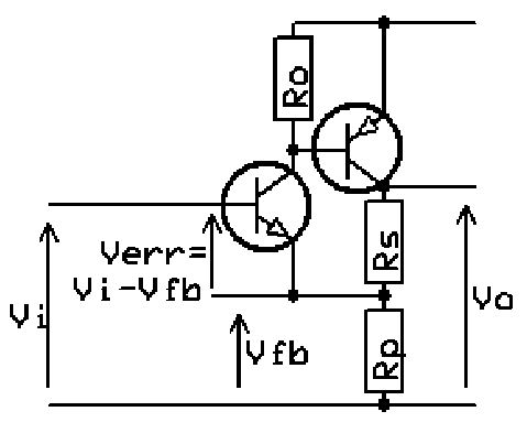

Current Feedback Amplifiers, not only a semantic problem?
So called CFB, all voltages 😀
Supose the first transistor has no (internal) Re resulting in a infinite transconductance.Output voltage = (really)100% Input voltage.That is Vi=Vfb and Verr=0.With no voltage to amplify you can hardly speek of feedback.That's why i insist on an Re in simple representations.
The error voltage is develloped over Re witch is current dependent, introducing new distortions 🙁 .
Mona

You will have non-zero error with or without Re due to finite gain.
Jan

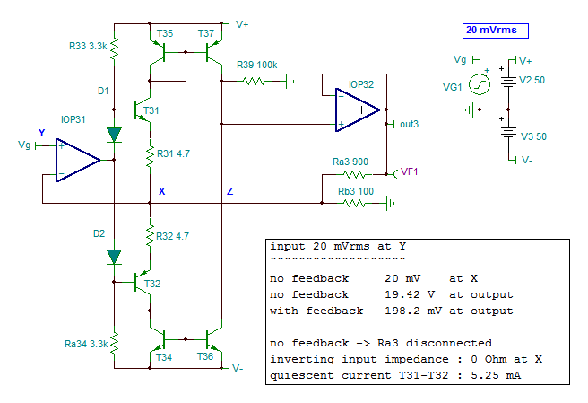

Here is a circuit with a null impedance at the inverting input (I called the circuit a Nulliiia).
The open loop gain is limited because of the degenerative resistance R3b.
Rb3 is an integral part of both the open loop gain and the closed loop gain.
The open loop gain is around 60 dB mainly defined by R39/Rb3.
The loop gain is around 40 dB and the close loop gain very close to 20 dB.
attachment.php

If there is no Re the transconductance is infinite and that makes the gain also infinite.
Mona
The overall loopgain of your circuit does not tend to infinity when the transconductance of the first stage tends to infinity. You need an infinite current gain of the second stage. Just look at the transfer around the loop from the collector current of the second stage, it is always smaller than or equal to the hfe of the second transistor. In fact for a gain equal to the attenuation of the feedback you need infinite current gain in the second stage and infinite voltage gain in the first stage.
By the way, I forgot the impact of Ro, that is, I assumed current source rather than resistor biasing.
Has nothing to do with the kind of feedback.Ro set the current in the first transistor, has to drop 0,6volt for the second transistor to function and also influence the open loop gain.Could also be a current source for max gain.
Mona
It indeed has nothing to do with the kind of feedback, but with Ro, my statement that the overall loopgain goes to infinity when the current gain of the second stage goes to infinity is not necessarily correct.
By the way, from a more practical point of view, I think that using a current source can improve the distortion significantly. Analysing the circuit anti-causally, the current through Ro has a logarithmic type of distortion on it while the base current of the output transistor hardly has any distortion, so I expect using a current source reduces distortion in two ways, by preventing loss of loopgain and by improving open-loop linearity. This again has nothing to do with the type of feedback, of course.
