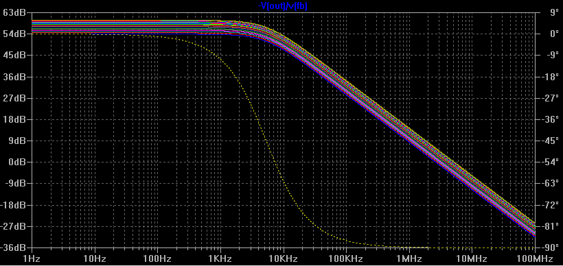

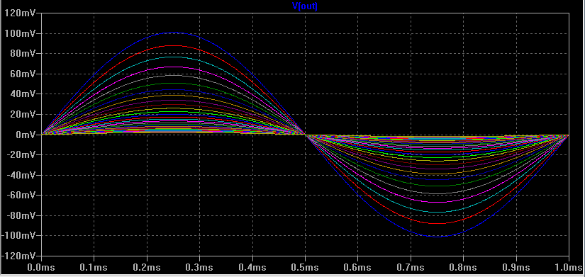

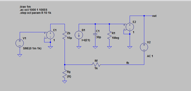

In the ideal case (infinite open loop gain and an input buffer with a perfectly zero output resistance) if Rf is a fixed value and the closed loop gain is set by varying Rg only, then the closed loop bandwidth will not vary.

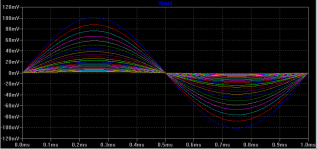

I've attached a simple simulation for demonstration purposes. An idealized CFA is modelled and the closed loop gain is stepped logarithmically from unity to ~100 (a 40 dB range) by varying Rg only (cfa2.png). If the output resistance of the input buffer (Zb) is negligibly low (say 10u) then the closed loop bandwidth essentially does not deviate from 5.3MHz over the full gain range at all (cfa3.png).

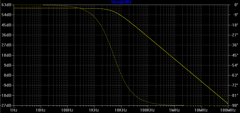

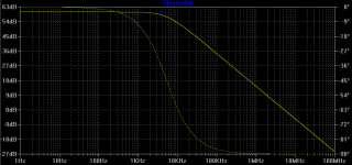

Increasing Zb to 10 ohms to demonstrate the effect of a non-ideal buffer, the close loop bandwidth exhibits far less gain independence, but still only varies over a ~2:1 range for the 100:1 variation in range for the closed loop gain (cfa4.png); this is exactly as one would expect as at the highest closed loop gain Zb at 10 ohms essentially = Rf||Rg, effectively halving the transconductance of the input stage. Obviously still a great deal better than a comparative VFA model.
The LTspice *.asc file is also attached for those that would like to play.
A minor correction: make that from 2 to ~100 (a 34 dB range).

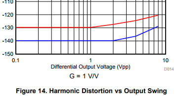

It's one of these new super chips with 0.3A max Iout and 40V supply. I am not at liberty to disclose the type.
Here's another snipped: THD at 100kHz!
It seems safe to say that CFA distortion figures can hold their own, at least, against those of traditional CFA chips.
