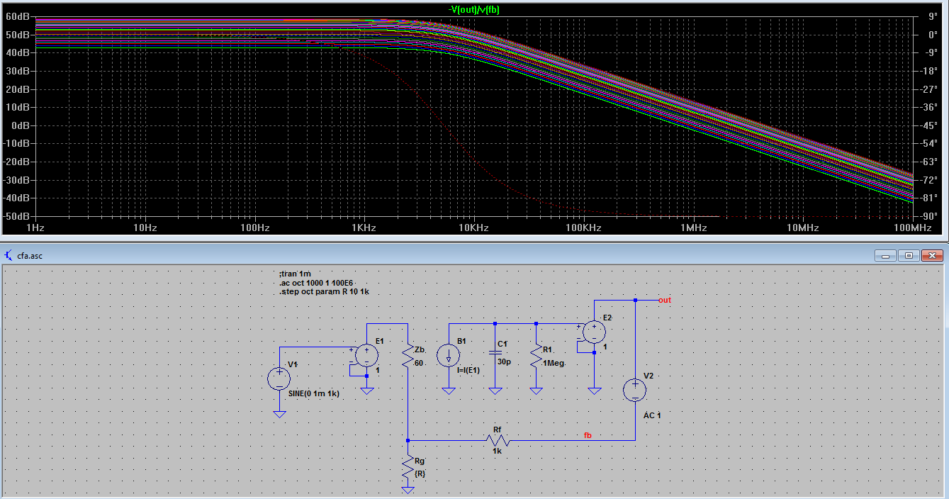

Take say 250uA collector current
OK. So that's a little-R e of 26mV/250uA = ~100 ohms, right? For a small signal analysis of a primitive "diamond buffer" I guess we have two re's effectively in parallel. Lets be generous and make the buffer output resistance 60 ohms.
I re-ran my simulation with the 1k Rf with a 60 ohm Zb. stepping the noise gain from 2 (6 dB) to 101 (40 dB) the closed loop bandwidth goes from 4.7 MHz to 750 kHz.
That's a 6.3:1 variation in closed loop bandwidth for a 50.5:1 variation in closed loop gain. Far from ideal but still a bit of a stretch to describe it to be "pure VFA behaviour".
And another thing just for curiosity's sake - when applying integrated CFA op-amps there is no reason to stick to the optimal specified value(s) of Rf if your bandwidth/distortion requirements don't require it. Suppose that you have an switched-gain instrumentation application that requires a 2 MHz bandwidth. Just pick a 20 MHz op-amp and use a ~10x higher Rf. Now you have much more room to play with Rg and the influence of Zo of the input buffer has been reduced by an order of magnitude.

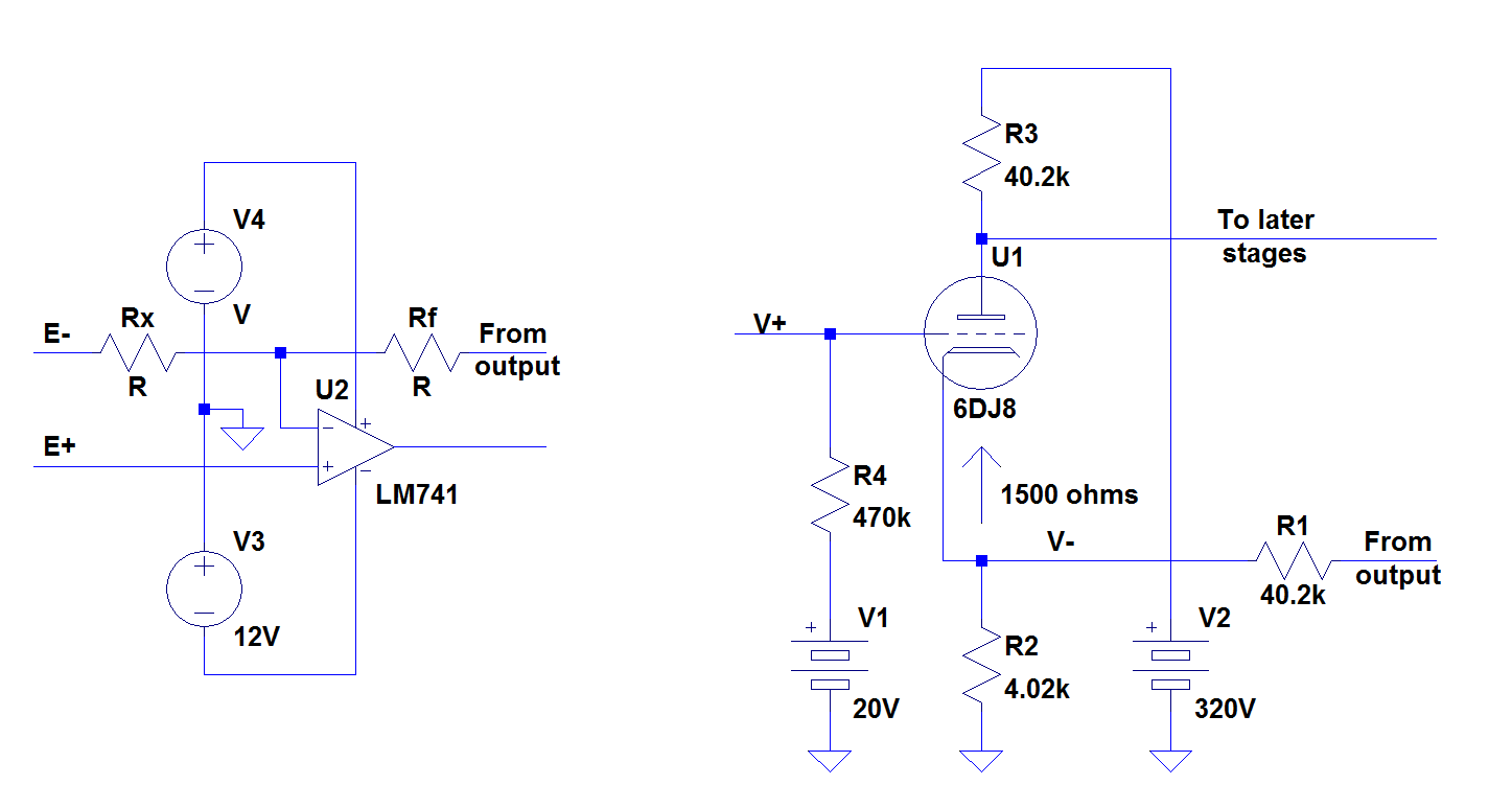

Is it time to start at least partially summing up?
There seem to be at least two discussion threads here. One is about nomenclature; the other about the operational characteristics of certain IC’s.
On the nomenclature topic, we might consider the feedback topologies of complete amplifier circuits as well as some characteristics of the amplifiers at the heart of these networks. These are really two separate issues.
I think we all recognize that there are four feedback topologies, sometimes referred to as series derived, series applied; series derived, shunt applied; shunt derived, series applied; and shunt derived, shunt applied. Whatever the historical precedent, the term CFA if applied here is ambiguous; does the “F” refer to derived or applied feedback or both? It is not inherently obvious. For this reason, we should shun its use to describe a feedback topology.
The characteristics of the amps at the heart of any of these four topologies are independent of those topologies. The amp could be like an old familiar friend with a traditional input stage such as the hoary LM741, or like a single triode whose cathode is the inverting input (see the schematic below.) For the ‘741, we would expect the inverting input impedance Z- to be greater than Rf || Rx and in such cases, we would say that voltage feedback predominates. But for the triode in the schematic below, the inverting input impedance is less than R1 || R2, and here, we would say that current feedback predominates. Why? Z- sees a feedback network whose Thevenin equivalent is a voltage source V in series with a resistance R. If Z- < R, a simple calculation shows that it is more accurate to say that a current V/R flows through Z than that Z sees a voltage source V. The situation is reversed if Z- > R.
Should amps fall into one of two different classes named CFA and VFA? Don’t hold your breath; I’m not going to argue for or against. But at least we can see a reason for choosing these terms to describe certain feedback network ( not feedback network topology! ) and inverting input impedance combinations.
It should be clear that amplifier / feedback network combinations which “see” either predominantly voltage or predominantly current feedback could be used in networks of any of the four feedback topology types. These two matters are independent of one another, unlike what was claimed in a certain (in)famous article.
