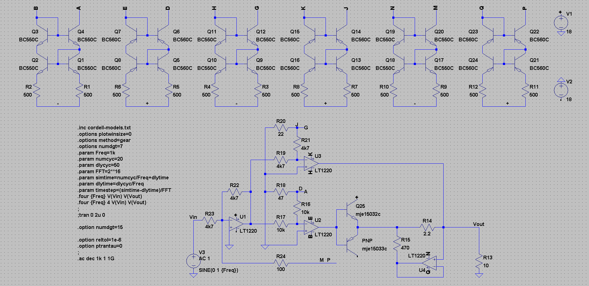

Seems it has not yet been referenced,
Current amplifier using error feedforward
by Wilson, known for his 3 and 4 transistors current mirrors
which were described at the beginning of this article
Current mirrors, amplifiers and dumpers
published in Wireless World, december 1981 :

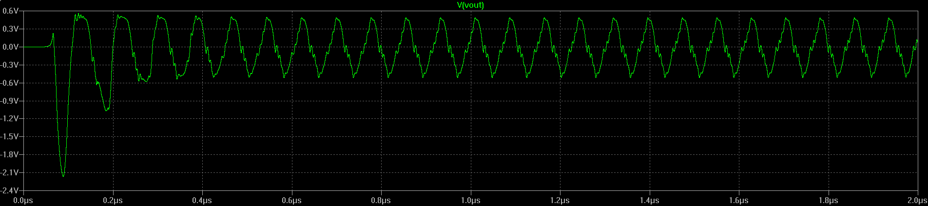

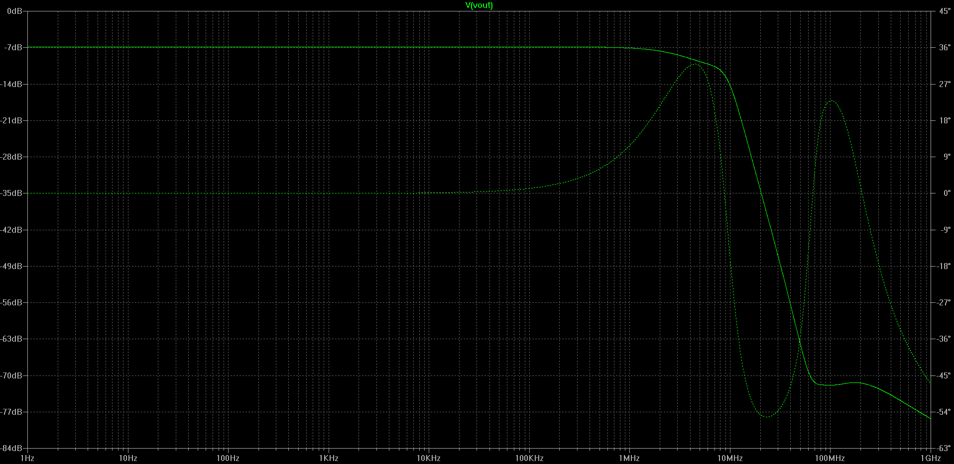

Nice article.

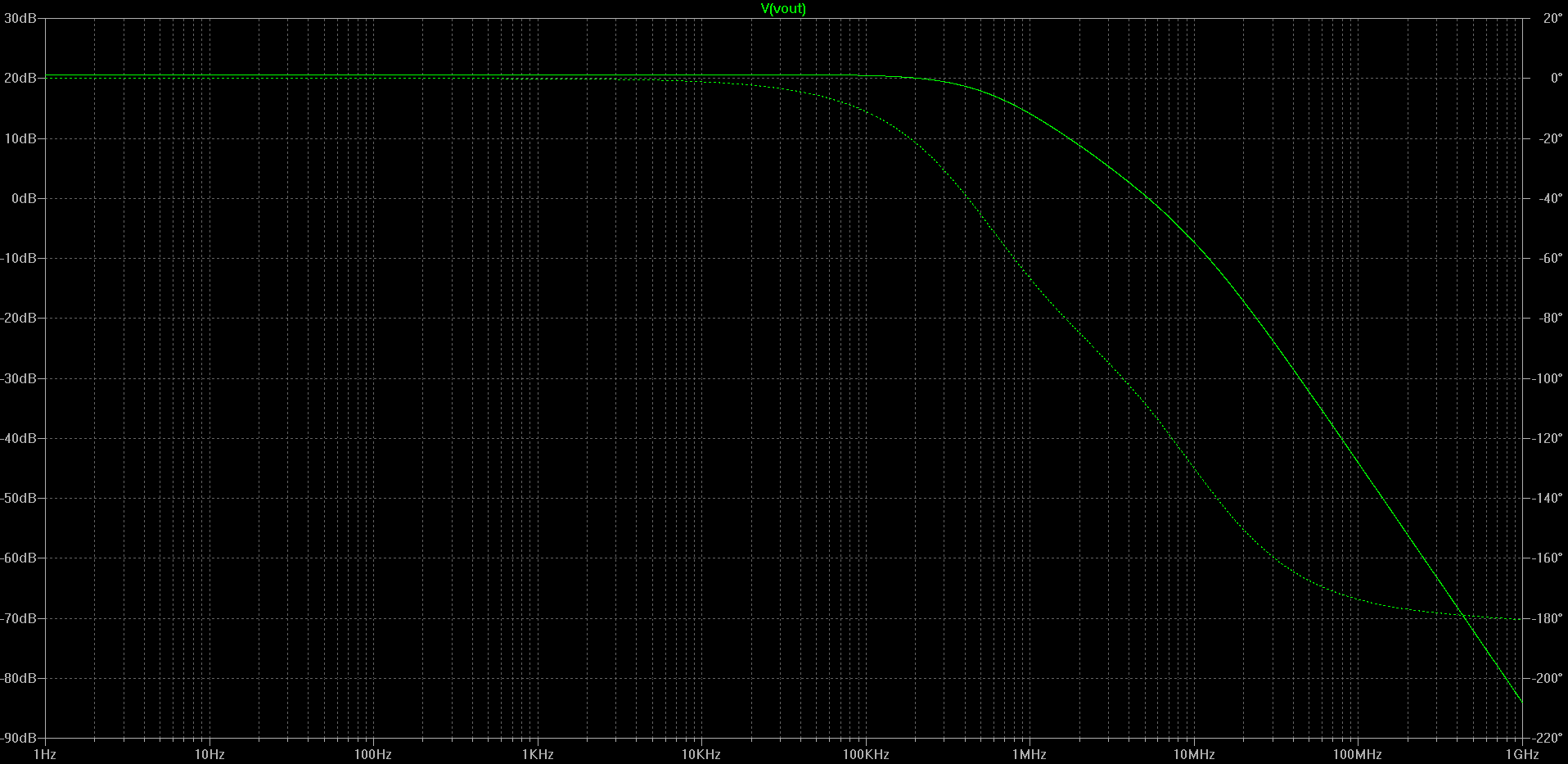

seems to be working...
... however I do not have the models of the opamps from this article.
Could anyone propose which LT opamps will be working without the oscillations in this circuit?
Attached sims and asc file for play, cheers!

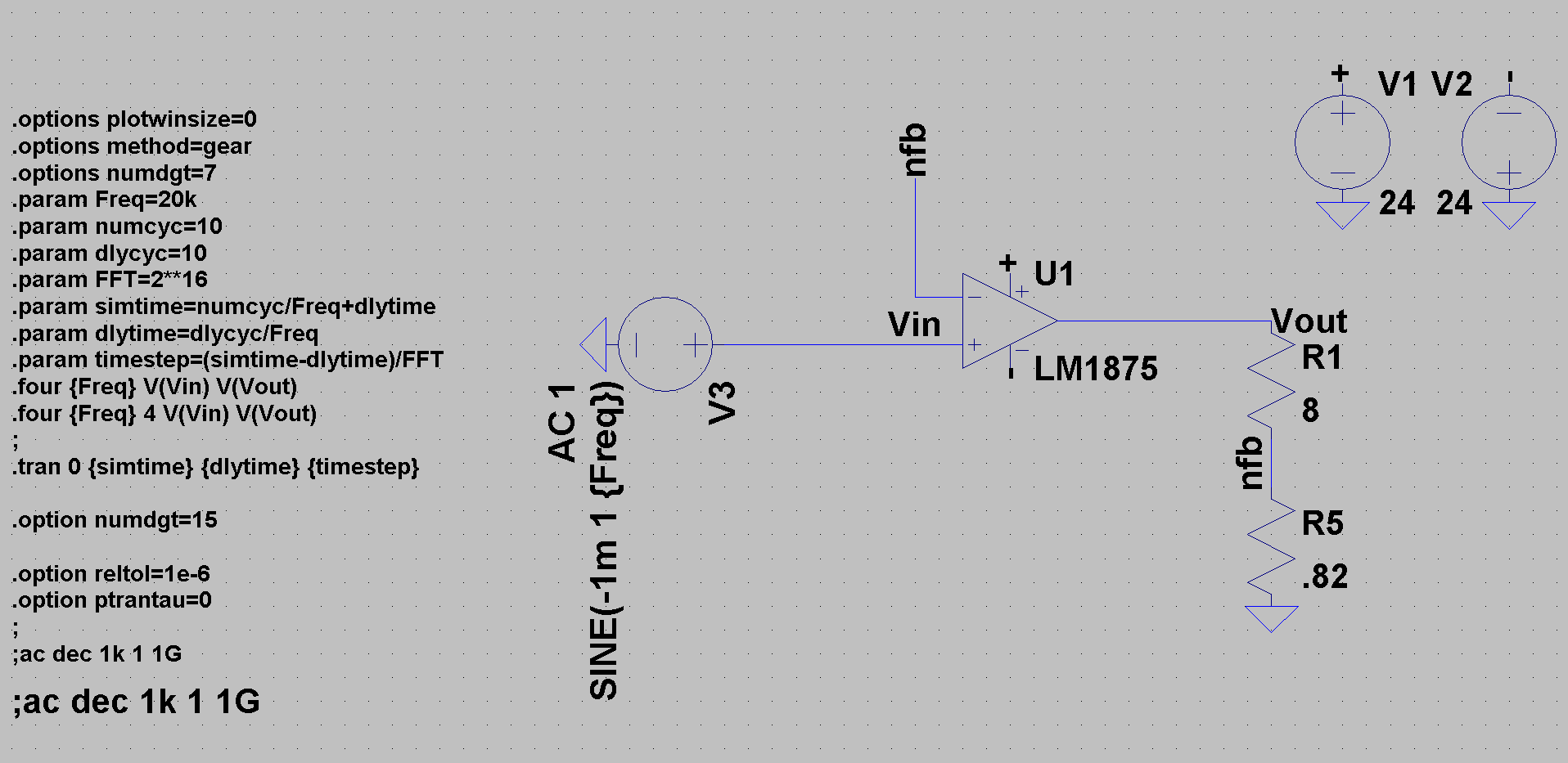

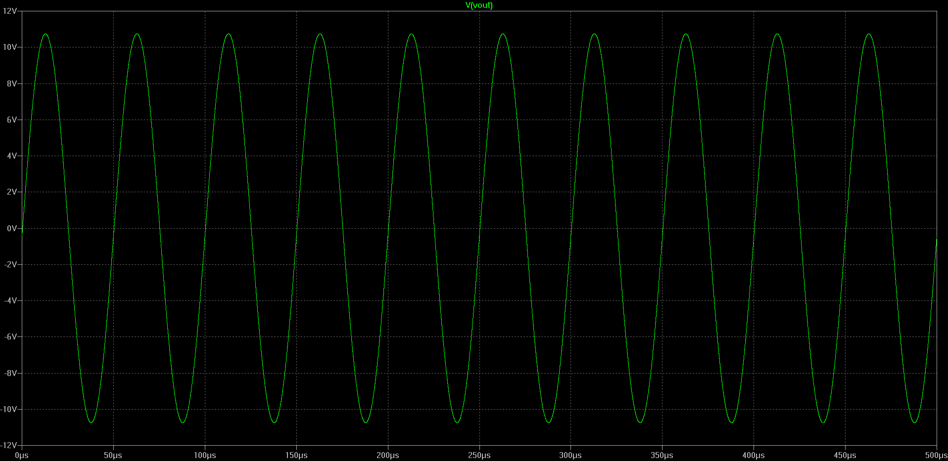

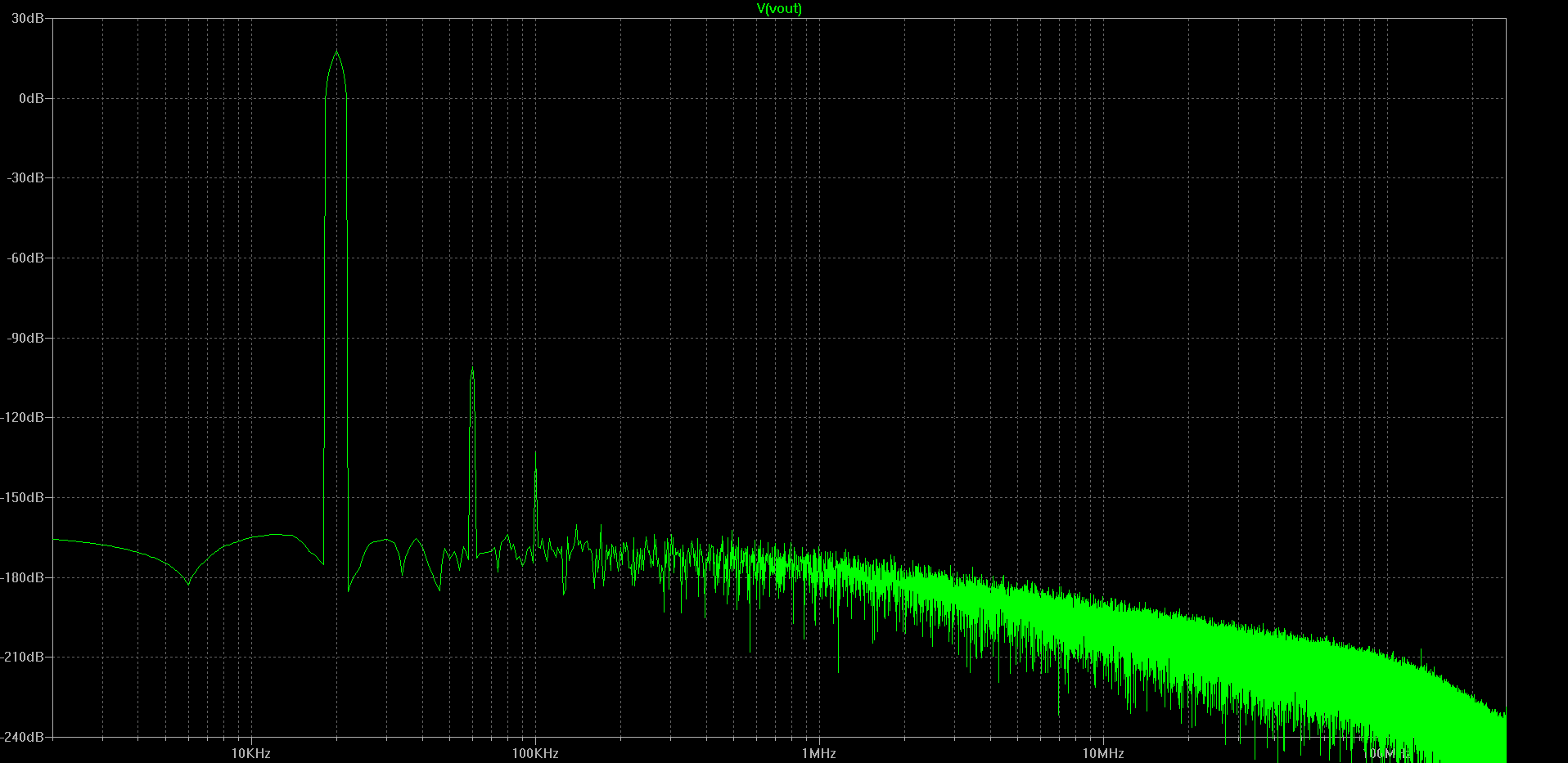

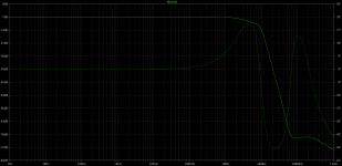

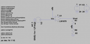

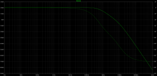

LM1875 - is it true?
Hi
I found a model for LM1875 and simulations attached bellow are showing its great potential as trasnconductance amp.
If the model is true, it will outperform all of the rest chipamps
Hi

I bought some kits but finaly decided to use them without the "current feedback components", not finished yet.
I think the original idea was to produce some bass boost at the speaker f0
you sure can use it with 16 ohms driver with less effect
I would suggest to simulate in LTSPICE with universal op amp as lm3886
these are my parameters (I am not an expert)
good enough to adjust feedback resistors and check output resistance:
you change Rload and measure Amps in Rload
Prefix X
InstName U2
SpiceModel level.2
Value
Value2 Avol=0.5Meg GBW=8Meg Slew=19Meg
SpiceLine ilimit=10 rail=0 Vos=0 phimargin=45
SpiceLine2 en=0 enk=0 in=0 ink=0 Rin=1Meg
