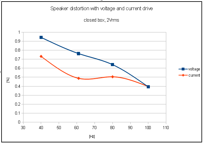

Thank you, do you mean something like this?
Thank you Richard, I believe that measurement with a driver without passive crossover (3-way box) would show improvement even above 100Hz, I am planning to make more measurements.
My experiments were with a single drive unit in sealed box.

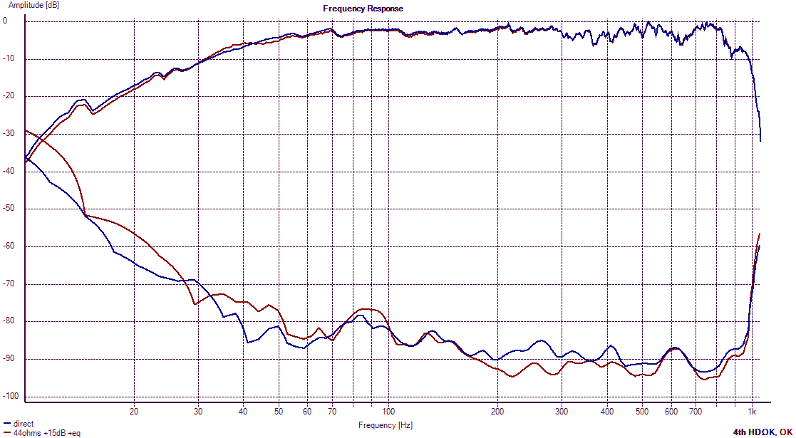

I found quite the opposite regarding woofers: the midband odd order distortion was much reduced whereas the low frequency distortion (mechanical) was not.
With current drive you could more clearly see a trend where the disotrtion was slowly rising when going down in frequency, as if the "distortion floor" was lower in midband.

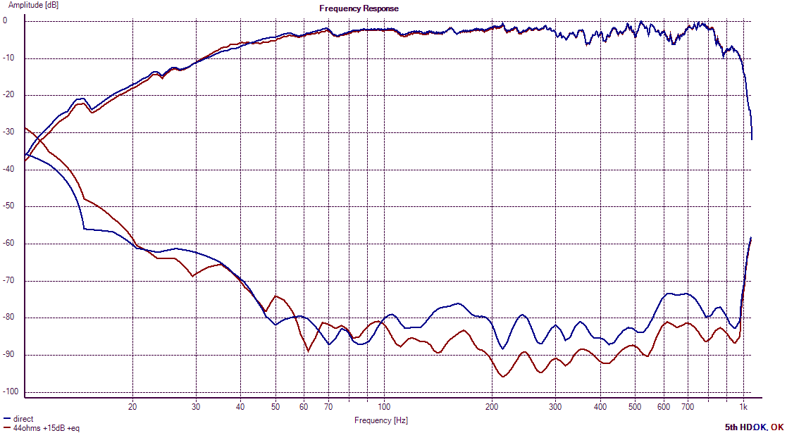

You will find attached the 3rd, 4th and 5th distortion measurement of a TAD TL1801 18" driver in a 230L closed box.
Blue is voltage drive, red is with a 44 ohms series resistor, with EQ and gain matching to get the almost exact same response (a big notch around the resonant frequency was applied...).

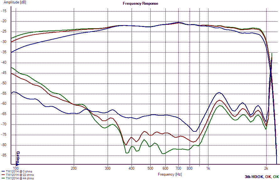

Now with a TM1201H mid woofer, with 0, 22 and 44 ohms in series.
No EQ this time, so the rising in distortion down low is simply due to the rising in response level (that was verified, but I have no measurement)

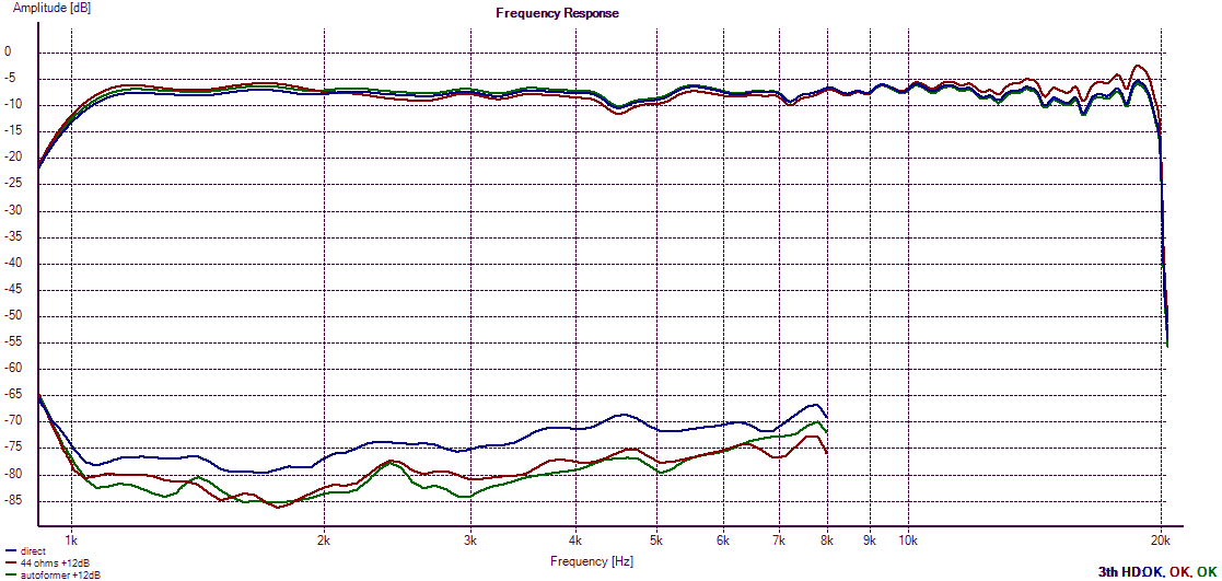

And now with a compression driver.
Here there is no gain in distortion from the current drive per se: the same reduction can be obtained by simply reducing the gain at the output of the amplifier (and of course increasing input level to get a matched SPL) with an autoformer used as a lpad
So this distortion comes from the amplifier (this was nbot the case for the woofer measurements).
blue: voltage drive
green: voltage drive with a lpad on the output and +12dB of gain to match output level
red: 44 ohms series resistor and +12dB of gain to match output level (no EQ)
