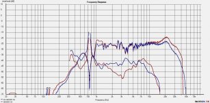

As many working with speakers may have noticed, padding down a tweeter can make it sound sweeter. Since I am presently developing a series of active speakers, normally one would not pad down any of the drivers.
Curious to find out whether that would nonetheless be a good idea, I decided to do some measurements today. After all, putting a resistor in series with a tweeter makes it partially current driven, so according to theory and observation, this should drive distortion down..
Time for some bloody evidence.
The brown curve is a 4 Ohm tweeter with a 10 Ohm resistor in series, the blue curve without. In both measurements, the input to the driver was adjusted to provide approximately the same acoustic output.
In the critical band between 2 and 5K, the distortion is appreciably lower with partial current drive, up to 15 dB improvement. However, there is a cross over point, where partial current drive provides more distortion. But frankly, this doesn't bother me to much, because at this point, the distortion products are at the verge of ultrasonics anyways.
Another effect that is obvious, is the 6 dB rise between 10 and 20 K. The reason is that this tweeter has no shortening ring and thus has a fairly high inductance. It was engineered to be straight with voltage drive. Easily remedied by putting a small cap in parallel with the tweeter.
The difference in distortion is mainly in the third harmonic.
Note: the distortion figures are normalized to a 0dB signal, as those familiar with Holm impulse will know.
