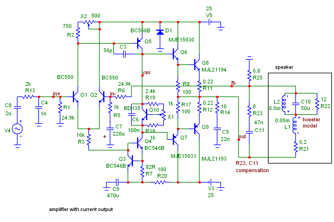

I have only built a functional sample of the current output amplifier, based on simple modification of the usual voltage output GNFB amplifier to V/I converter, as shown on my webpage. It works very well, and distortion of output current, feeding the speaker as a load, is about 0.002% in most of the audio band, not exceeding 0.008%. The only care to be done is to compensate for inductive load at high frequencies, which is easy achievable with R-C net similar to Zobel, in parallel wit speaker. This amplifier is enough for measurement purposes and I believe that the same concept may be used for a real life amplifier with current output.

I have also tried to show how easy, in principle, is to build an amplifier that has output current proportional to input voltage.
Current drive of speakers and speaker distortion
In fact, it is a trivial task.
Current drive is just one necessary condition how to decrease speaker nonlinear distortion, however, it is not any satisfactory condition. You will measure linear speaker current with current drive, but you are interested in acoustical output. You will linearize Le(x) nonlinearity effect, but Cms(x) and Bl(x), plus other sources of nonlinearity would remain unsolved. You will have to check every speaker, at acoustical side, if there is any improvement with current drive. And, you have to pre-equalize input signal to keep flat amplitude response.

Pavel,
On that schematic you just posted I see the RC network on the speaker terminals to correct the impedance rise. Now a friend of mine insists that a RCL network is what he would use to do this rather than a simple RC network. What difference is there between the two in end results? Does the RCL tank circuit have an advantage over the RC network or are they truly equivalent? Also I assume you are flattening the general rise from lowest to highest frequency range and that you are not attempting to kill the resonance peak at speaker Fs, is this correct. Would there be a problem in trying to correct both functions, would one filter shift the other or are these two separate issues that can both be tackled?
