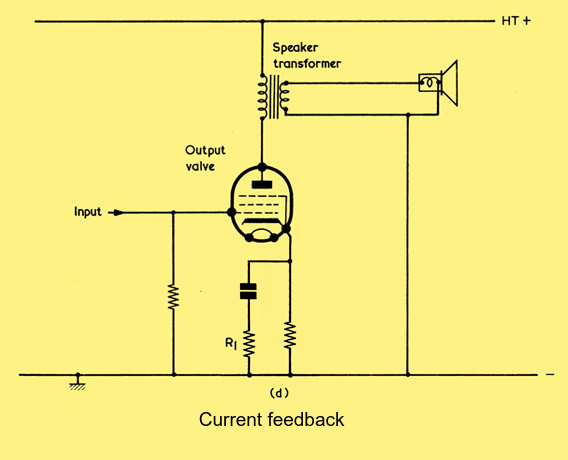

The simple feedback option
One can choose how much feedback is good, and there is also the option of using very simple cathode feedback.
The hint is: don't use feedback if you if you want to exploit the intrinsic advantages of pentodes.
Feedback and pentode
That is the method, regardless how long feedback is used. But the resistor may be placed either side of the load if the ground contact goes with it. See the drawing at the beginning of this thread.
Also a pentode looks like a natural candidate for a transconductance amplifier.
Add one more low ohm resistor between the speaker and the ground. And take feedback by current from this resistor.

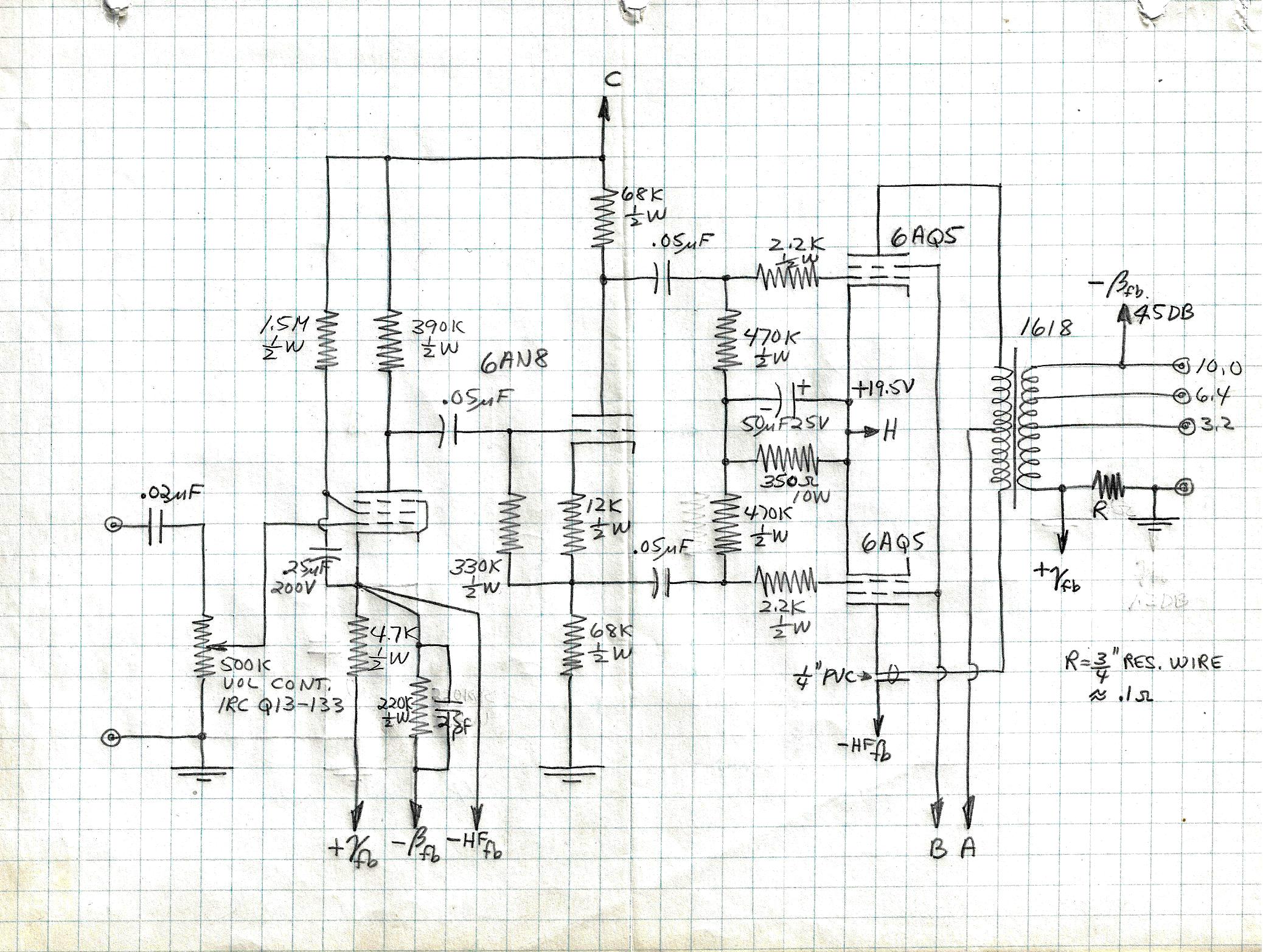

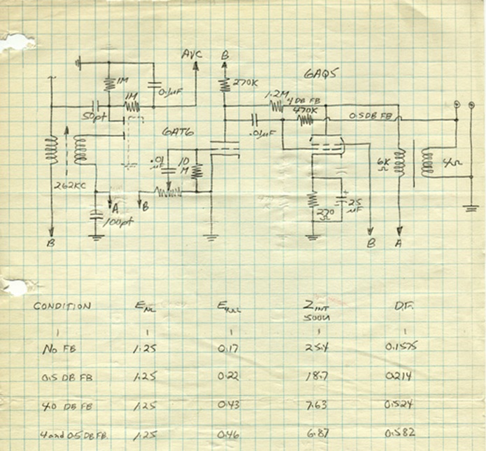

Early PP 6AQ5 Amp with Voltage & Current FB
The back page on this one tells me I built it Aug 1956. It went to a former Luftwaffe pilot I met while working at DeHavilland, an aircraft factory in Canada. He eventually became a dentist & practiced here for many years.🙂
Other than the positive current FB sensed by a short piece of resistance wire this amplifier is very ordinary. Positive current FB reduces the output impedance. The connexion to the current sense could be just as well hooked up the other way round in which case the current FB becomes negative & output impedance would increase. Or a low value resister on each side of the common with a pot across the pair & the FB can be adjusted from positive to negative. That is how Electrovoice & others did it.
Negative output impedance can be easily had which cancels some of the speaker voice coil resistance. The speaker resonant peak inverts, too much FB & the circuit becomes unstable.😱
All the iron is Hammond. The OPT is meant for a public address amplifier, only limited NFB is possible. The Hammond 1600 series today is much better.

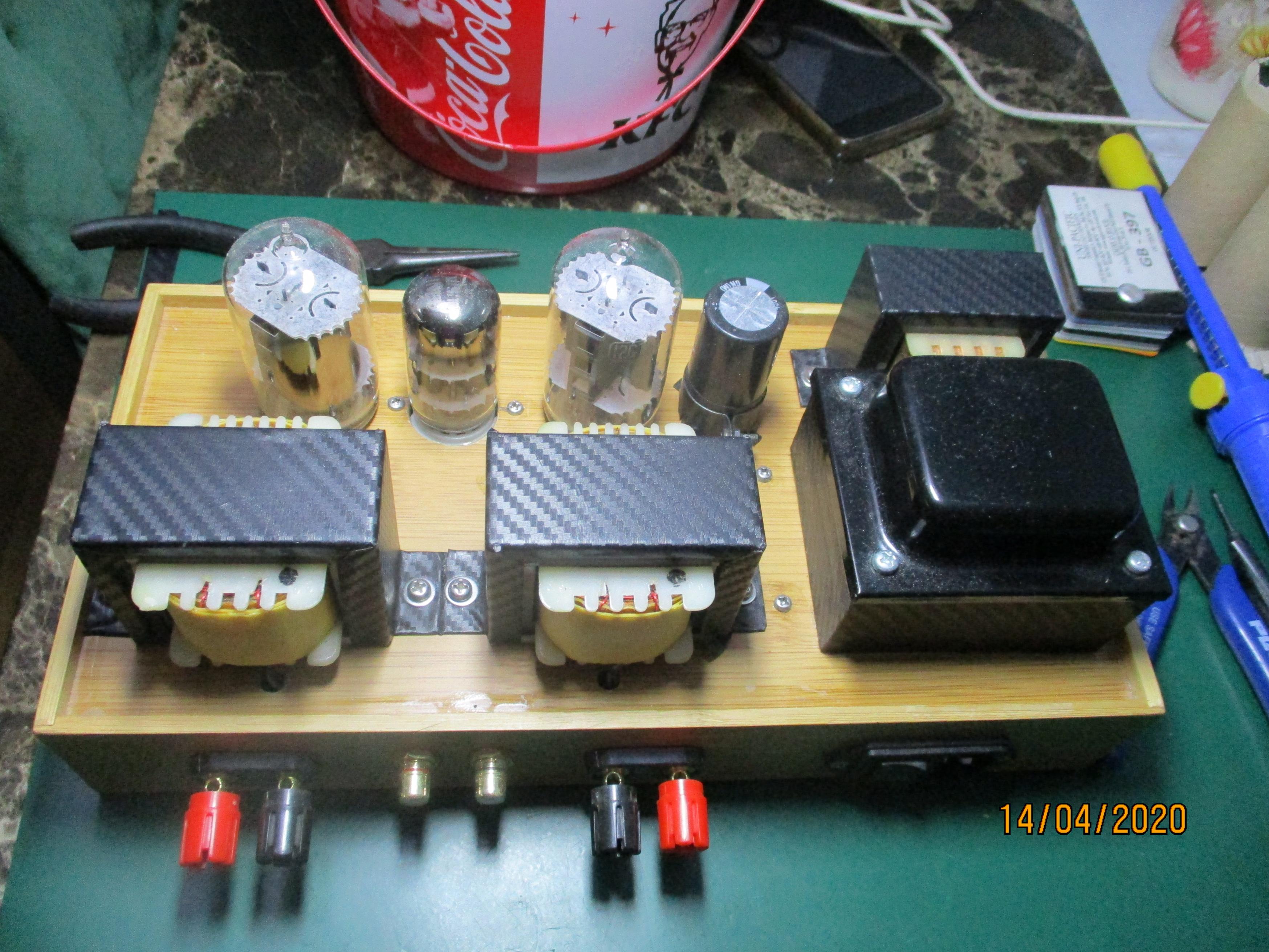

In another experiment I tried limited NFB on the tubed amplifier in my 1953 Ford auto. The car was used when I bought it, no radio. I was interning so money was always a problem. I found a partial Ford radio in a surplus shop & finished the build. The output was a SE 6AQ5 driven by a 6AT6. So I tried NFB from the OPT secondary to the preceding grid. It measured only 0.5 db. That was on a 3R secondary, so an 8R secondary would get a little more than One db of NFB. I mention this since about the same degree of FB could be attained with a direct secondary to cathode connexion as suggested in this thread.🙂
6AQ5 PP Amplifier with Positive Curent feedback Output Stage.jpg556.6 KB · Views: 206

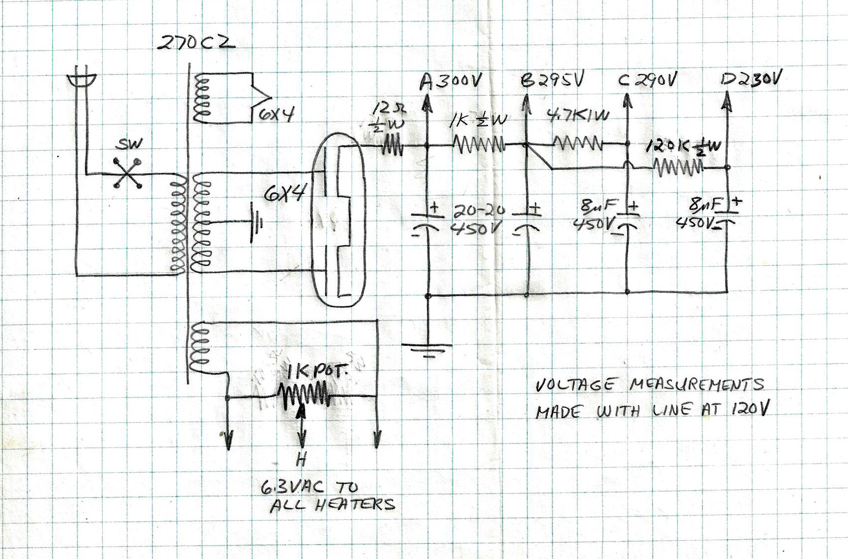

6AQ5 PP Amplifier with Positive Curent Feedback Power Supply.jpg425.1 KB · Views: 211

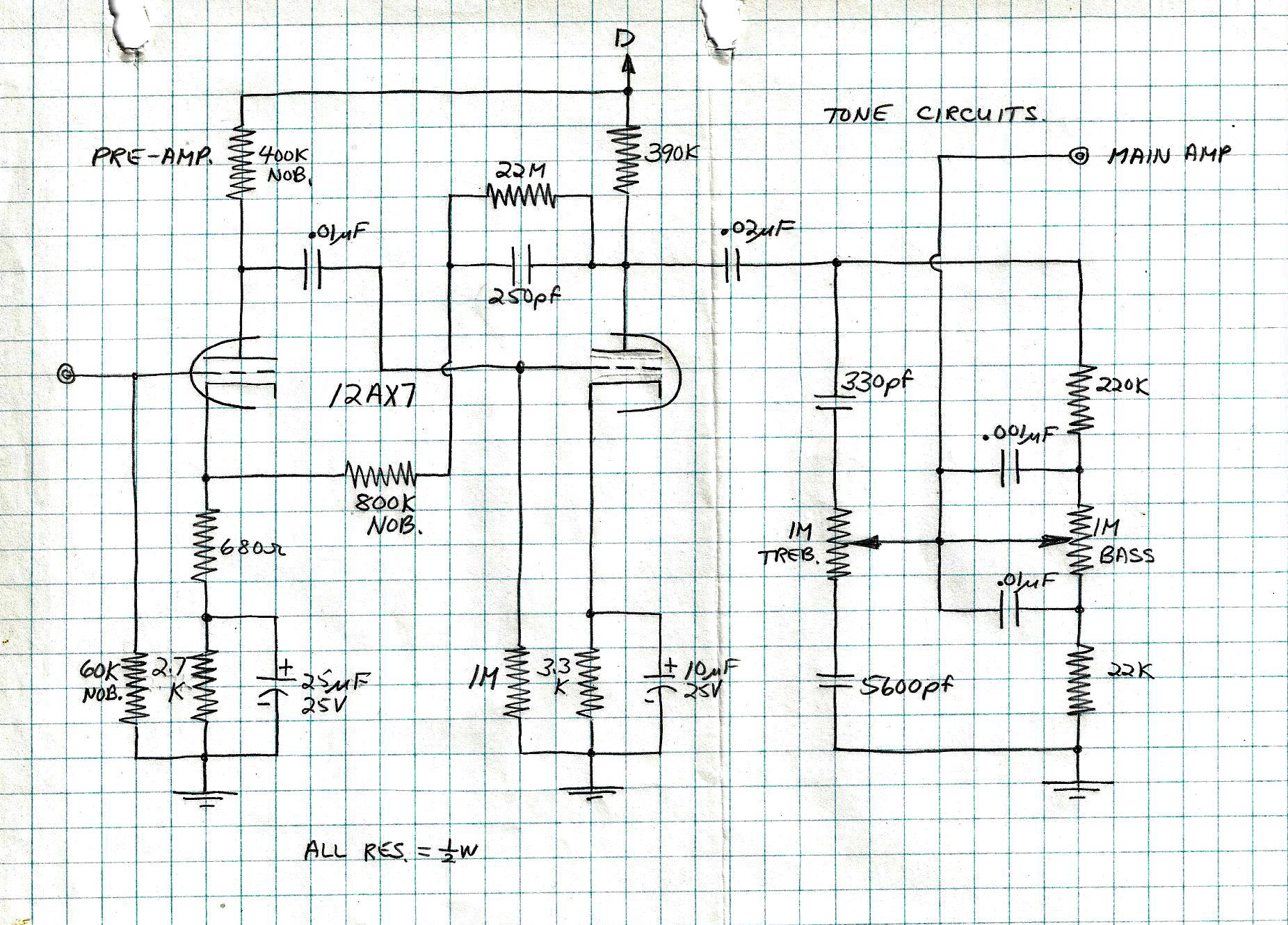

6AQ5 PP Amplifier with Positive Curent Feedback Preamp & Tone Controls.jpg586 KB · Views: 206

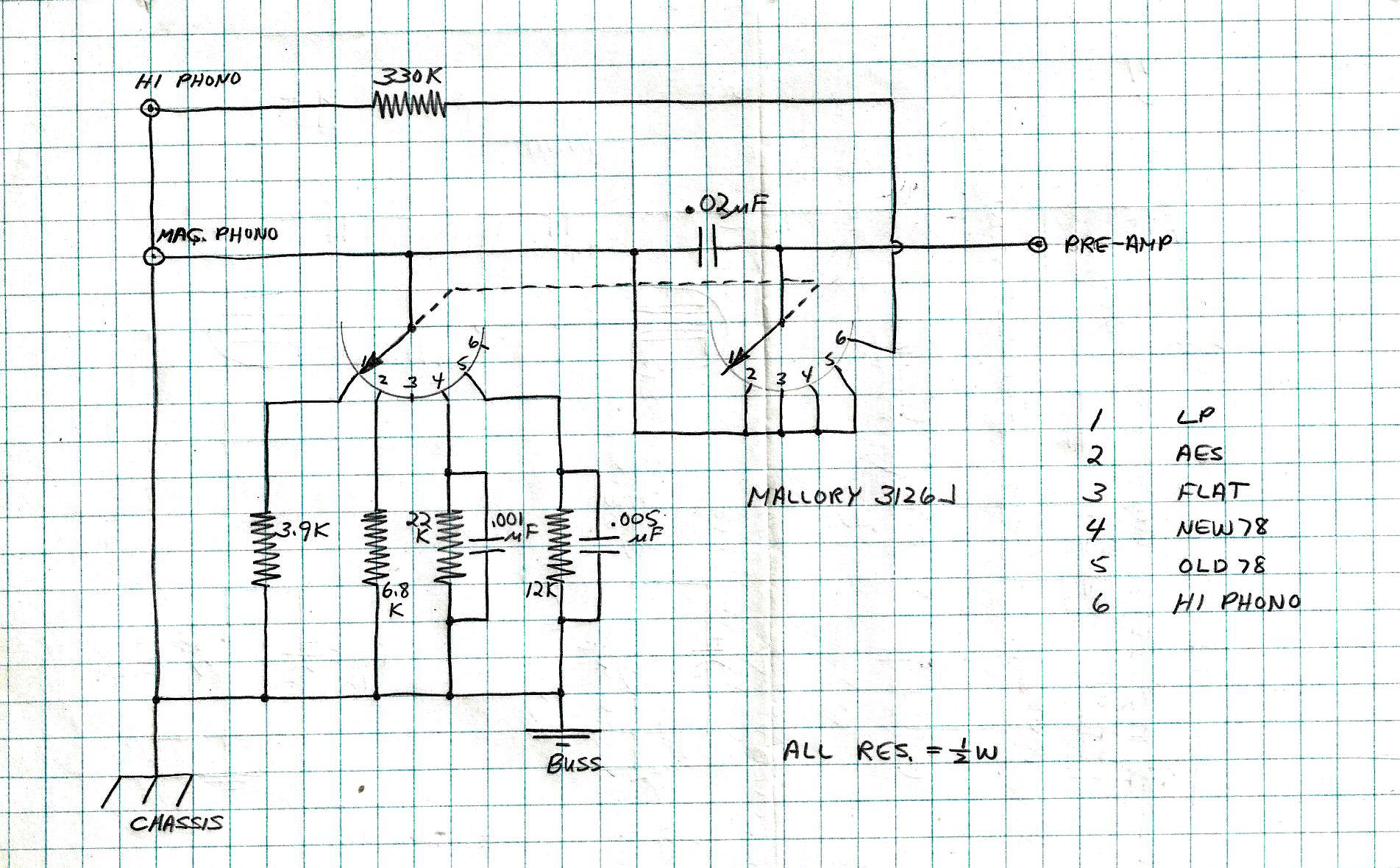

6AQ5 PP Amplifier with Positive Curent Feedback Input Selector.jpg469.8 KB · Views: 206

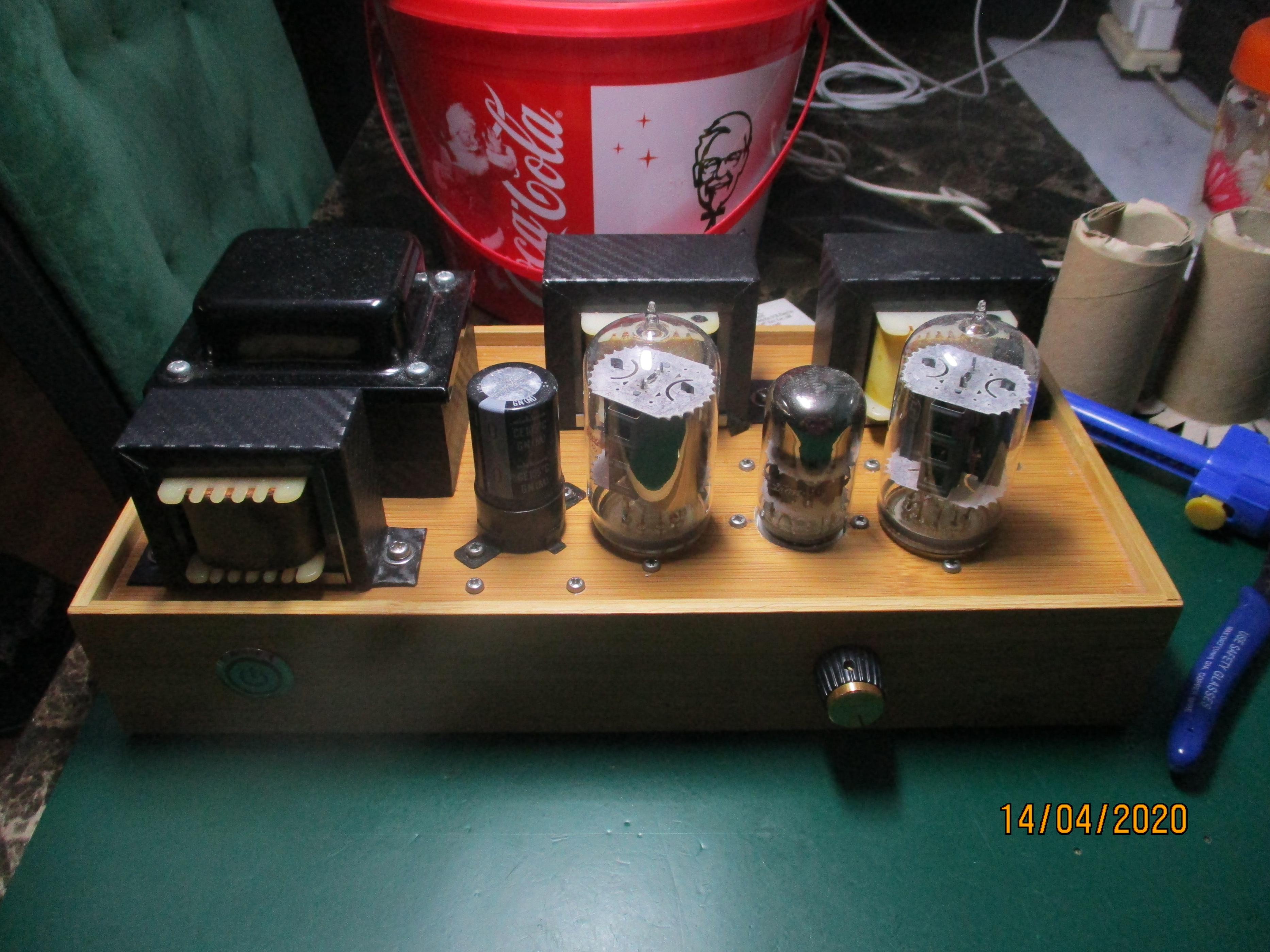

Structure of Wavebourn magic
In Constellation-3 triode push-pull amp I took feedback by current from cathodes of output 6S19P triodes. Now I figured out how to add it to the amp with negative feedbacks to output cathodes from speaker outs...
