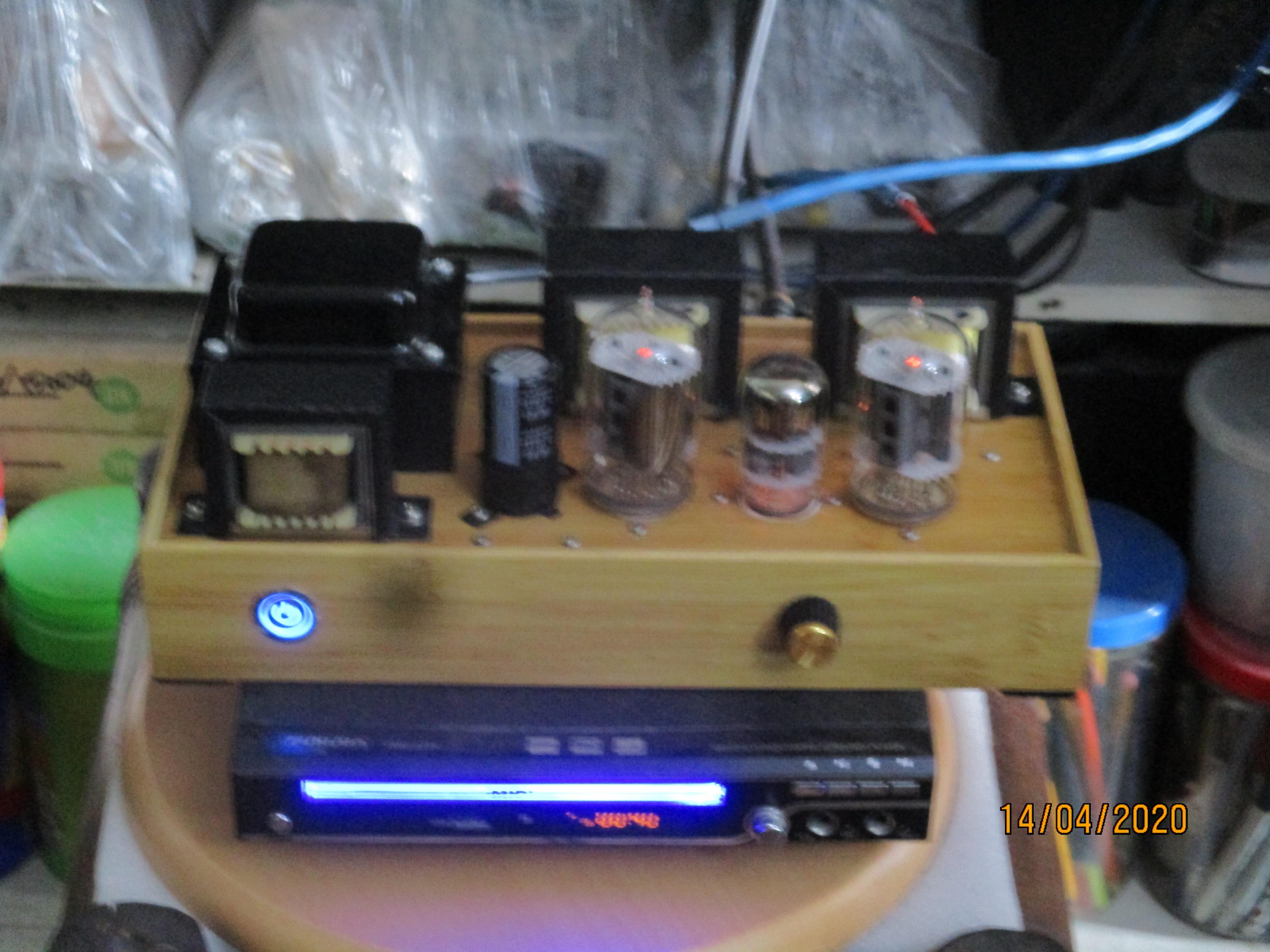

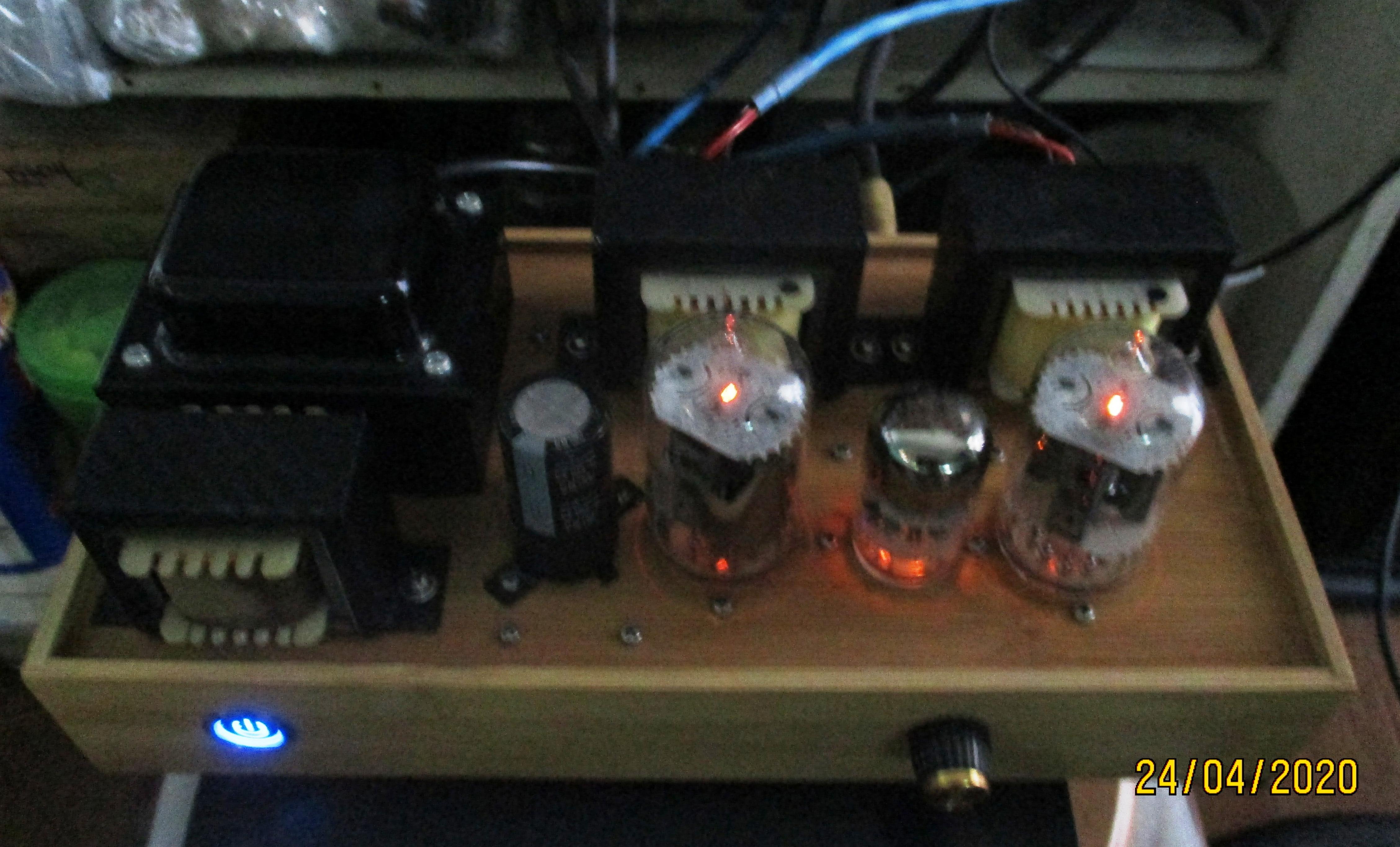

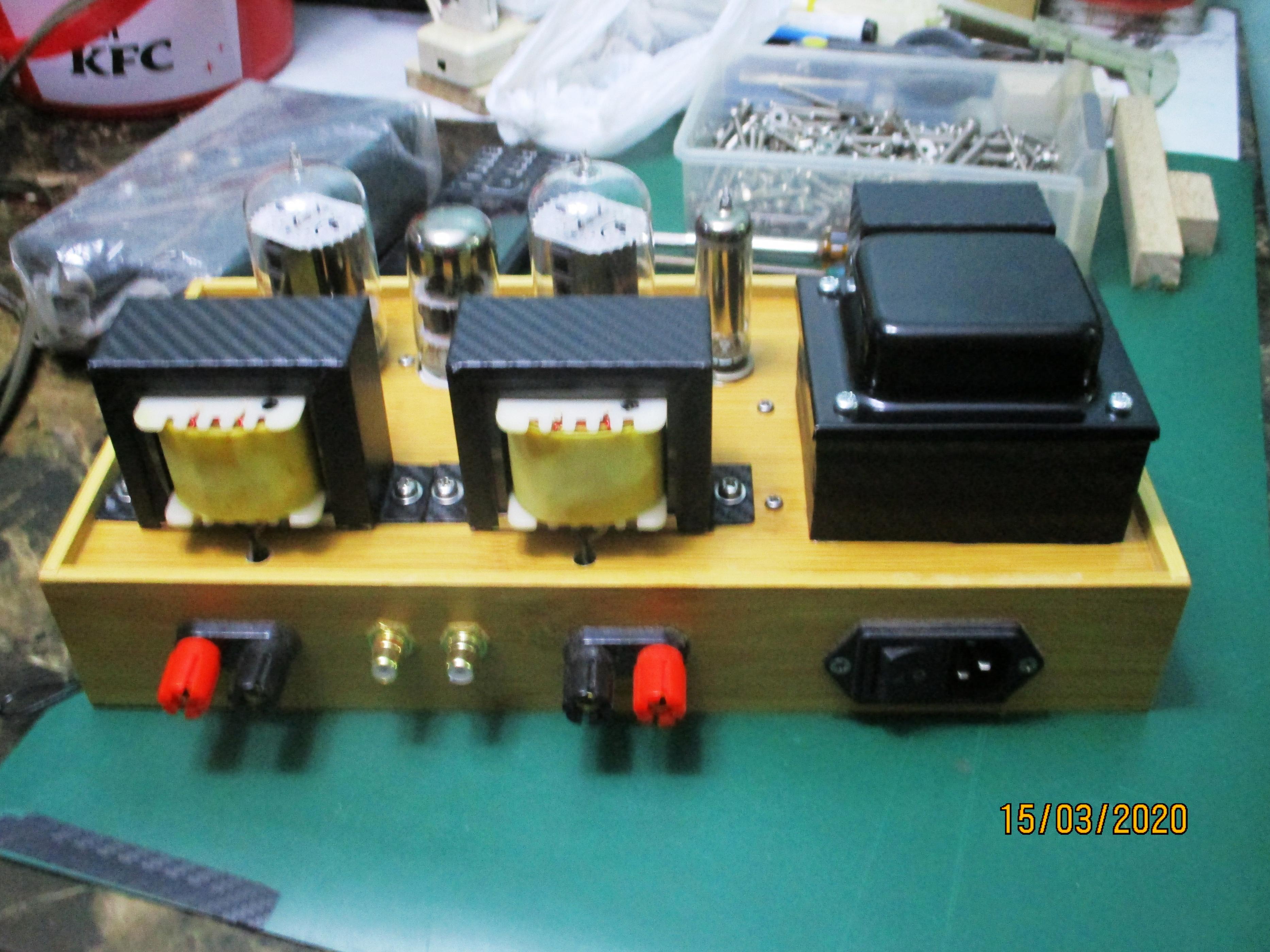

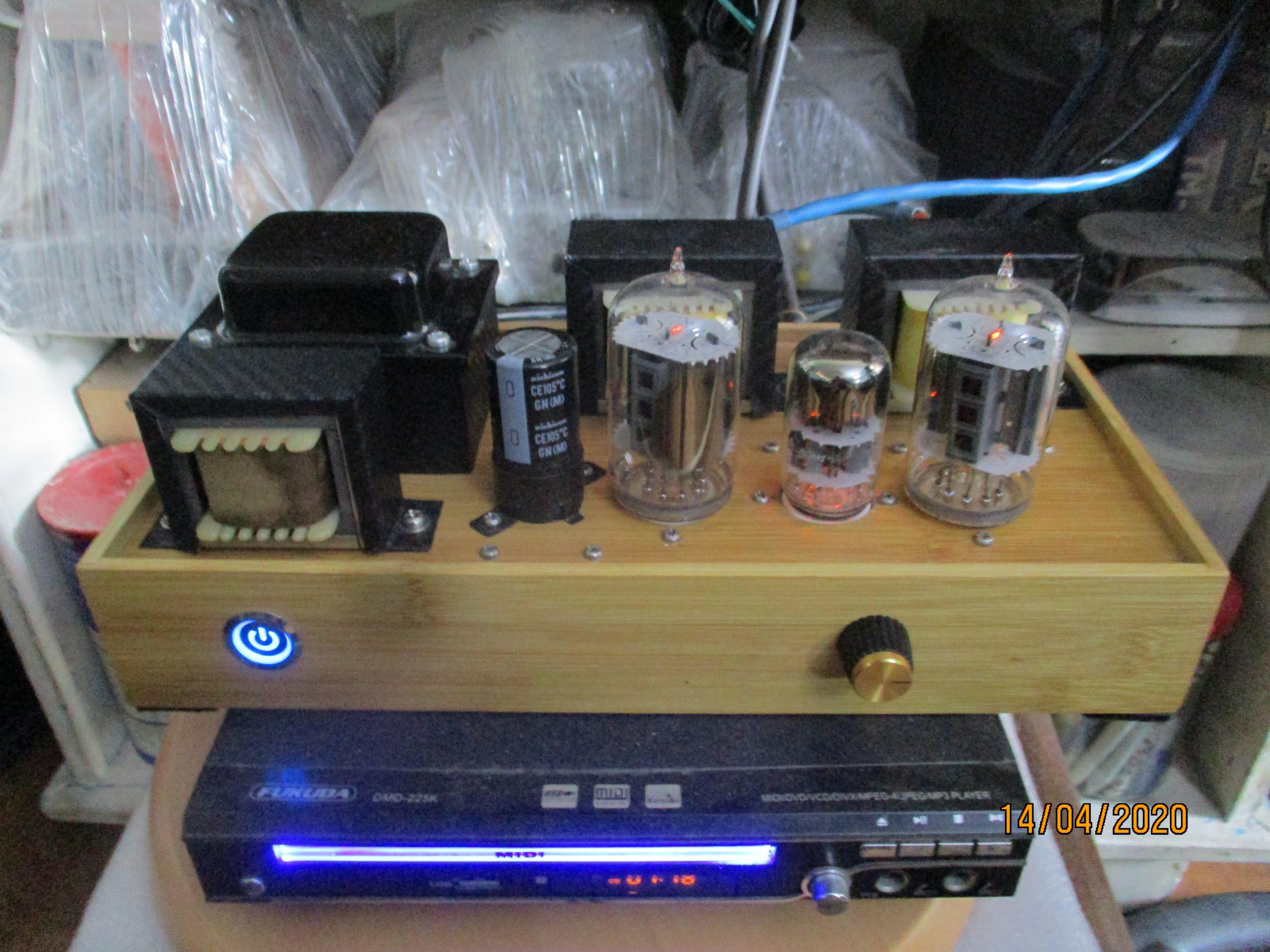

this is a 12gt5, 6bn11 all pentode single ended amp with no global negative feedback....G2 is fed by a CCS using depletion mosfet, Schade local feedback used....
i can not complain about the sound....you should try sometime...
but i guess having a filter cap at the output of the ccs made it a gyrator yes?

i forgot to say, the output of the CCS is tethered with a 150 volt zener string...

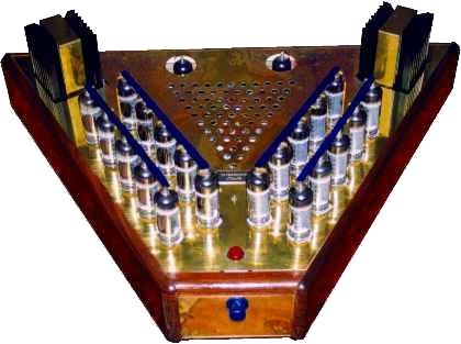

This is the amp Ultrasound once built...on request only as it was expensive.
OTL with tubes only. Zout= 200K and output peak current up to 8A. No feedback!
The other amps, more affordable, were 100% solid state or hybrid with SS output.
