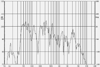

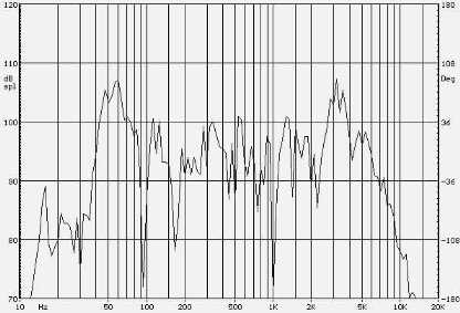

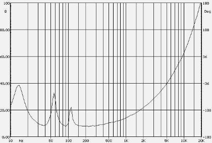

The bass resonance is not a problem at all. It#s just metropolitan legend. Ultrasound made 2 kinds of loudspeakers: their flagship using double transmission line and the rest was bass reflex. I listened to those loudspeakers many times and they were spot on, especially with current drive. The Alias model also won a price in the US, the EISA 2001-2002.
To show the performance of their current drive, Ultrasound did not use their speakers. The one below is a reasonably economical 8" with whizzer cone in bass reflex. On the left frequency response if voltage driven, in the middle if current driven and on the right impedance curve. Which one looks better?

At the end of the day, I have made my personal experience and stick to power drive be it triodes or pentodes with moderate feedback. There are other areas where the performance of a stereo system can improve dramatically, starting from the listening room.

Most of the impedance curve is classical for a single full range driver.
Dual impedance peaks (either side of the port tuning).
Rising impedance due to voice coil inductance.
But . . . what is the cause of the resonance at 15Hz?
I never saw that 3rd resonance before on a full range driver.
