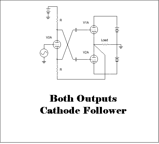

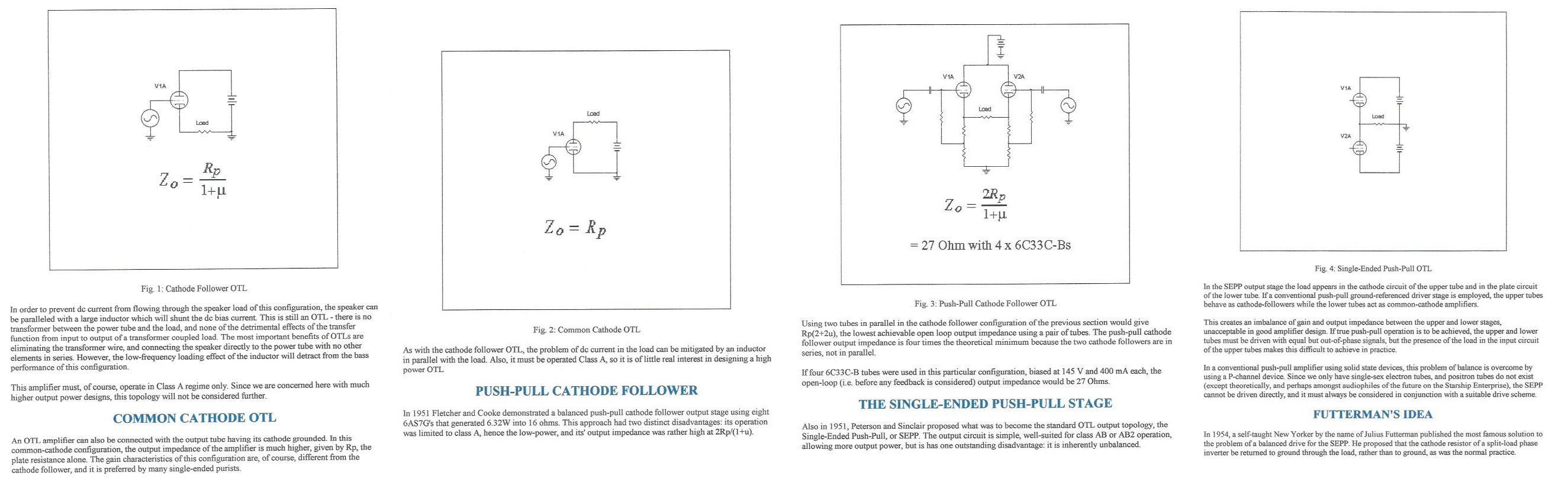

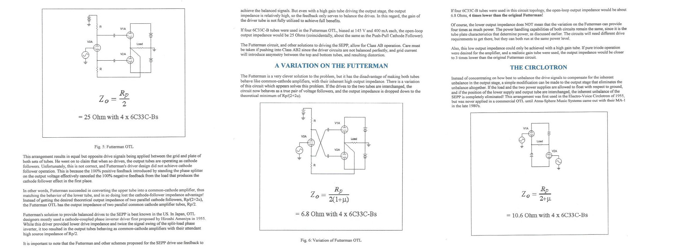

... But it can not be a totem pole output, because one of the two tubes in the totem pole is cathode output, which is a relatively low impedance...
Not necessarily so,
the original Futterman H1 has a bootstrap (i.e. positive FB) from output to the lower leg of a cathodyne splitter, hence both outputs run grounded cathode
most modern totem pole OTLs use a scheme to correct this "flaw" (sometimes tagged "Inverted Futterman") which runs both outputs as cathode follower
but I agree, my notion of starting with an Atma-Shere output is also flawed because its a circlotron, so cathode follower ...
Doesn't that make a case for OTL ?
Circlotron, no FB, something like an ATMA-Sphere 60, but with Pentodes in pentode mode, screen grids cross connected as in Electro-Voice's A50 ?
Maybe a single pair of EL509s, MOSFET driven into grid current, could do the job of three pairs of 6AS7s but with 300V supply rather than the usual 150V ...
Not many watts though but more than 20ohm output impedance and not limited by OPT reactance ...

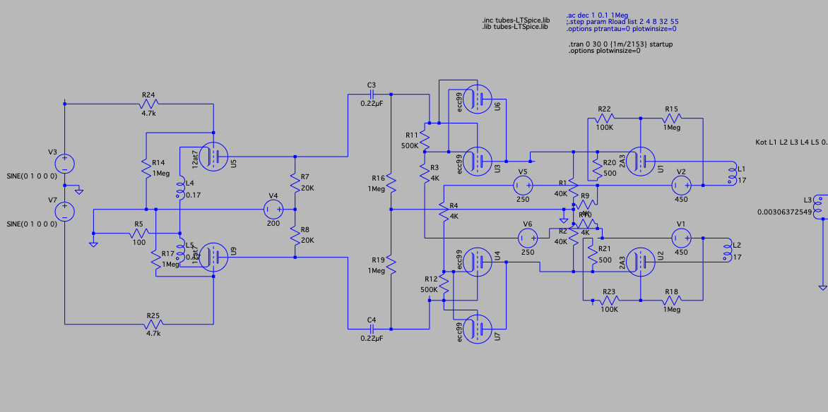

I wondered if it’s possible to make a circlotron that included the pre stages. I modelled a circlotron, with the differential prestage criss-crossed. The issue is operating two biases with just the two floating supplies.
The m60’s output impedance means the speaker needs careful selection. It uses differential voltage feedback. Without voltage feedback it would make it more difficult.
You could do a circlotron with a output transformer, If you’re running an output transformer, I wonder if a current feedback secondary could be used on the pre current..

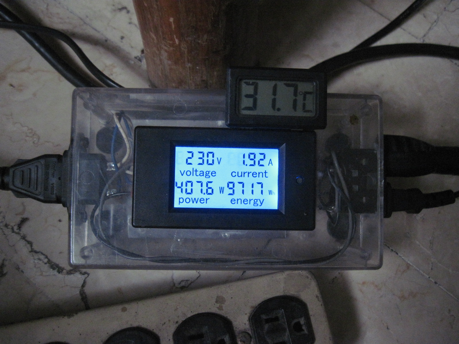

OTL amps indeed are very inefficient, my Tim Mellows OTL draws 430 watts from the 240vac power lines for an output power of merely 20 watts per channel...

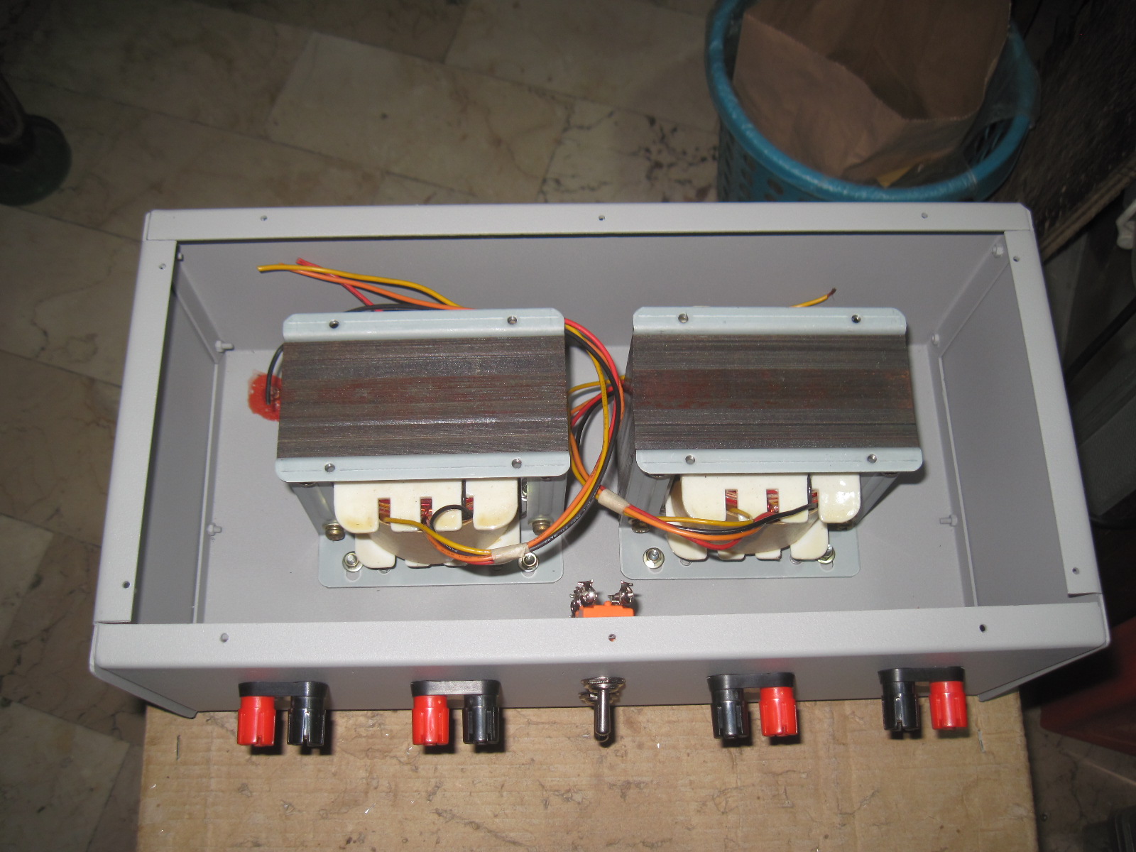

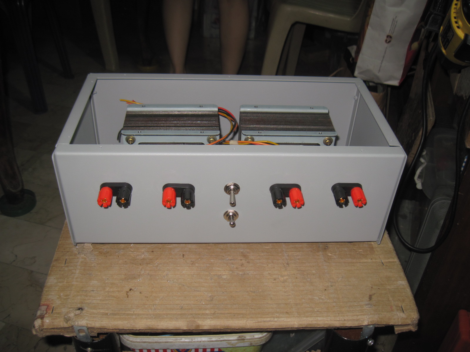

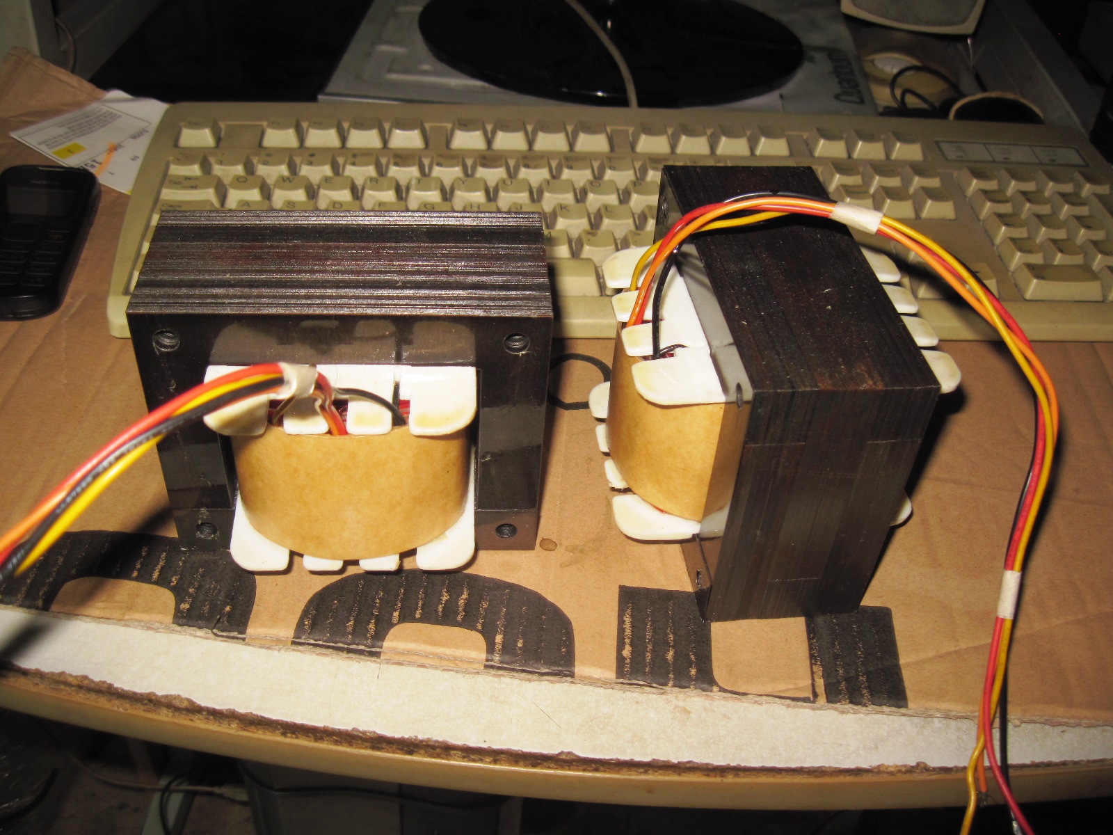

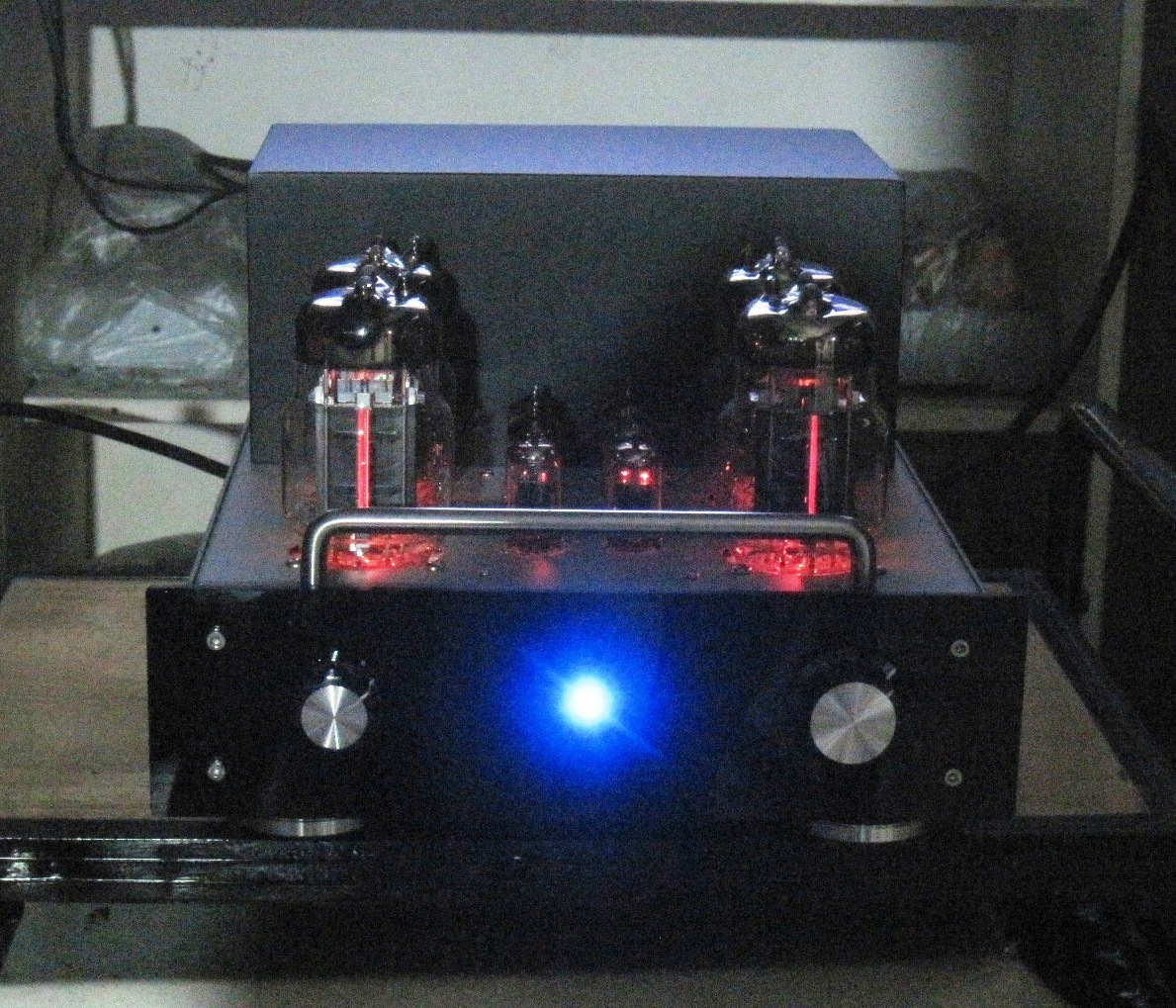

i have designed and built autotransformers for my OTL....
TonyTecson,
Looks real nice! Transformers and case too.
I never had the desire to wind and build my own transformers.
What is the inductive reactance at bass frequencies of the autotransformer's 8 Ohm output windings?
Is it high enough to be a current source output for an 8 Ohm speaker (or at the 4 Ohm, 16 Ohm, etc. output tap?
Also, now the amplifier is no longer really an OTL.

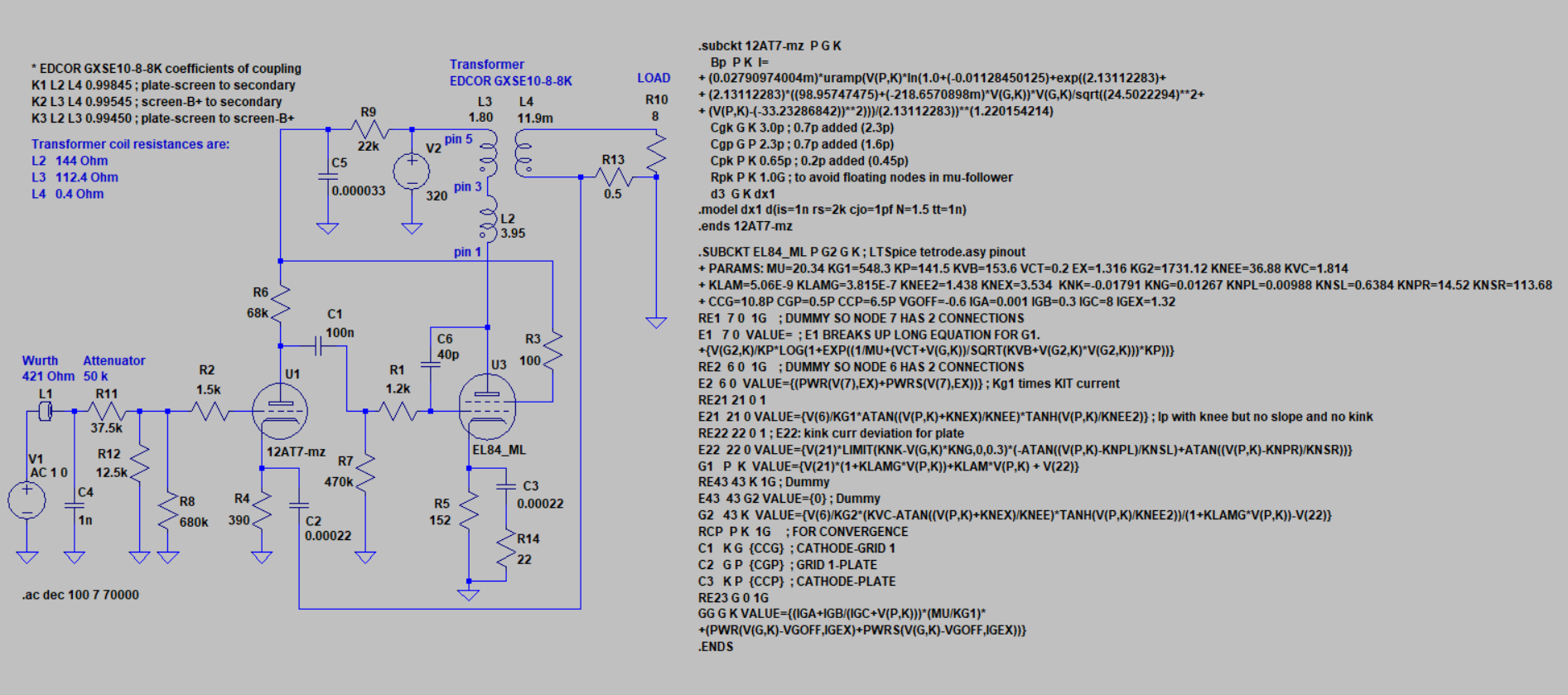

I approach the idea with a drawing. I borrowed some graphics from W. G. Morley.
(a) A voltage feedback circuit is a good starting point. The feedback may be brought to the cathode of the output valve, a pentode in this case. Resistors R1 and R2 are there for feedback only.
(b) A pentode left without feedback is actually a kind of transconductance amplifier, but not very good one due to distortion. Otherwise it is nice and simple.
(c) A resistor is required for current feedback, so it must be series connected with the load. The amount of feedback may be adjusted by choosing the resistor.

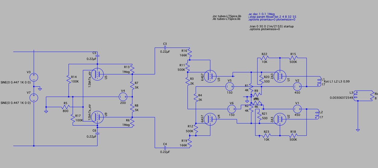

Simulations look encouraging but what next?
According to above mentioned idea I found an interesting schematic of a tube amplifier candidate and modified it with LTSpice. I already simulated gain, frequency response and harmonic distortion, and so far results look encouraging. I was wondering what else should I simulate?
So I guess it may be better to bring the feedback to the preceding amplifier stage. Then, I suppose, the current sense resistor may be kept small and feedback sufficient. Playing with resistance values becomes simple.

By the way in my simulation the pentode runs too hot. By mistake I was using wrong supply voltage.
