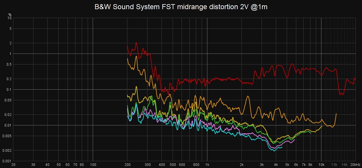

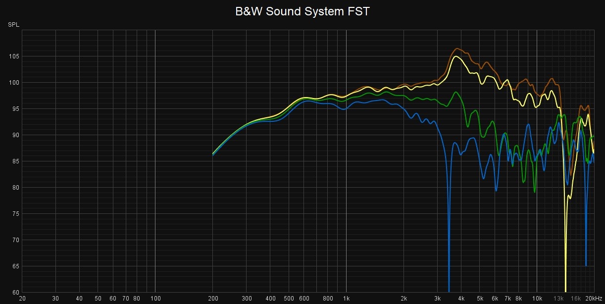

I have some experience with a custom B&W midrange driver here:
note this is 2V only applied into a 4ohm driver; measured at 1m, on and off axis (0/15/30/45/60 degrees)
also supplied is distortion.
Note the scale:
HD2 ~ 0.2% = -54dB
0.05 % = -66dB
0.02 % = -74dB
That combination of high sensitivity (100dB) and low distortion (below noise floor) cannot be surpassed with a smaller driver
the downside is that it start to beam soon after 1KHz. I would take it up to 1.6-2.5Khz, but B&W take it out to 4…:unsure:

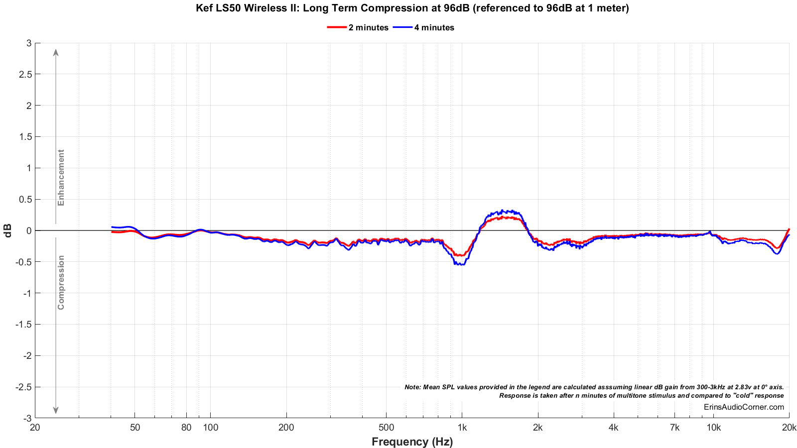

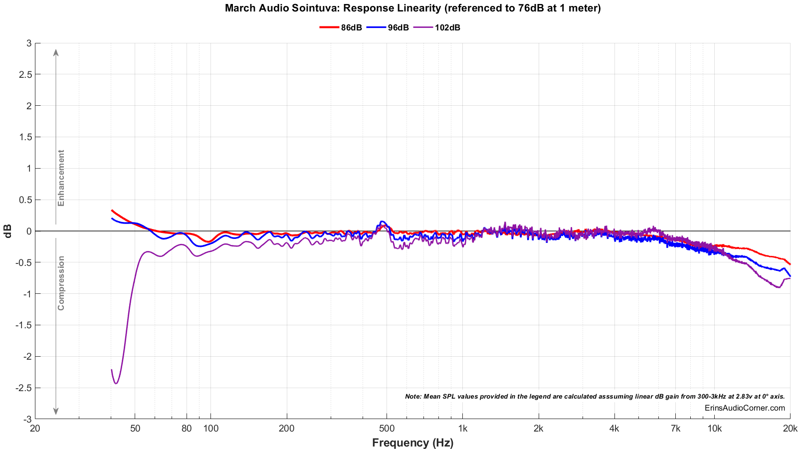

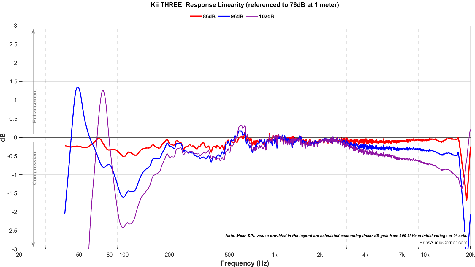

Long term power compression is not important with real music, as demonstrated by Erin Hardison.
@bikinpunk

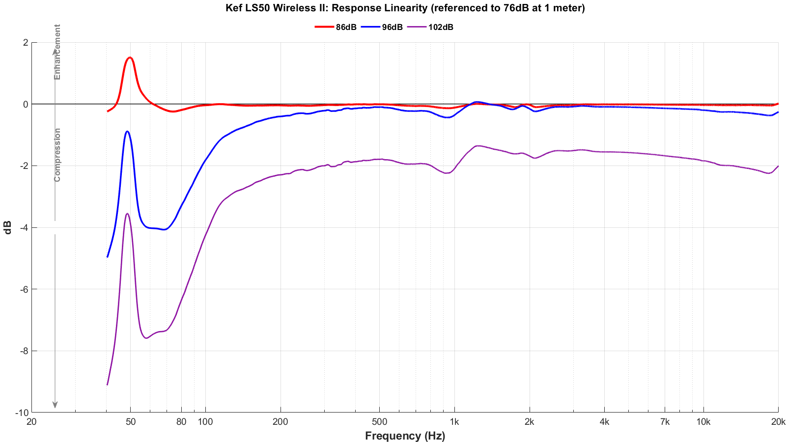

It's the instantaneous compression that suffers:
Here's everyone's 21C favourite, KEF LS50 Wireless II:
Long term compression:
Short term compression

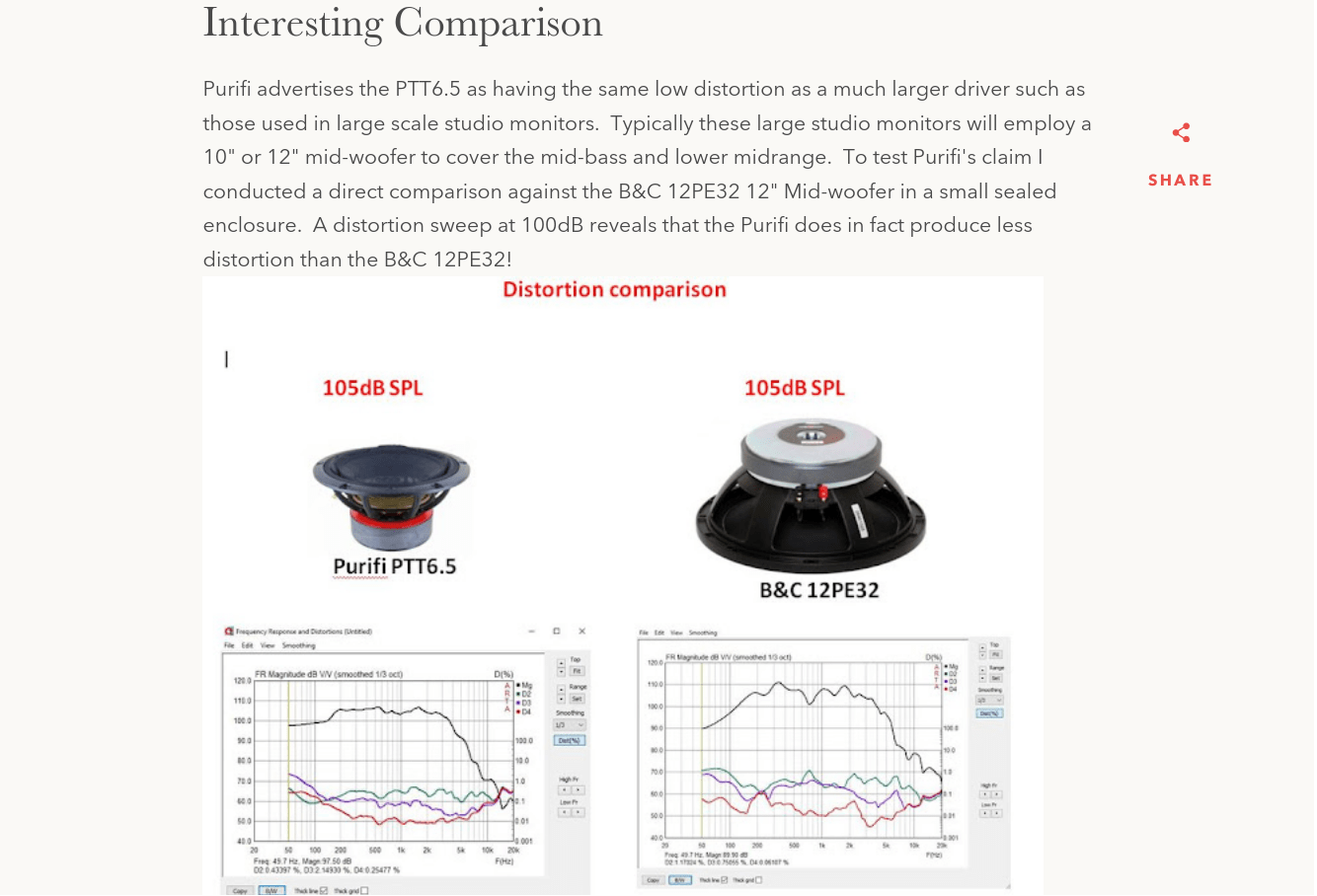

Now here's a speaker design without fancy DSP for crossover or EQ, but just a single state of the art Purifi 6.5" mid-woofer

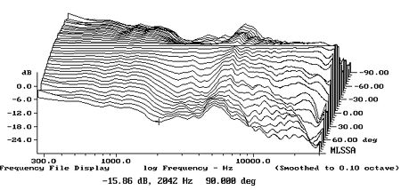

That's not necessarily a downside, just depends on where you look at it. Yeah, B&W crossed that relatively large midrange driver at 4kHz to a 1" dome that don't have any waveguide. The result is a huge directivity mismatch between the drivers around the crossover region (as we can see below). Objectively speaking, this is far from optimal, but subjectively can be pleasing to someone. Who knows..

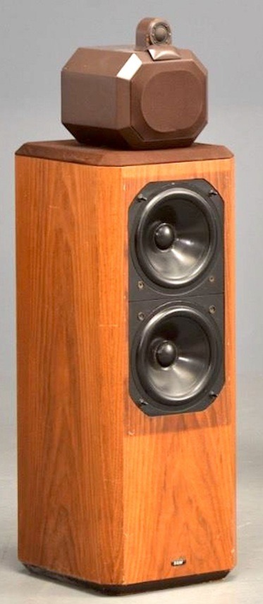

Do you have a picture of those 802?

These are what I have (not my actual set, but the same model). We had to open up our living room wall to repair ac ductwork... what a mess.
I like the smaller mids on the older 802s. They sound more together with the tweeter. The newer model with the larger mid has a hole in the response up top before the HF takes over. I went through the whole crossover as well and replaced the caps, compensating for dcr of electrolytic vs film to preserve voicing. They sound much better but still same sound signature. The tweeter is amazing for a metal dome. One of the best I've heard. The mids remind me of my old Focal Arias with 5k013ls.
I'm interested in trying one of the larger Kevlar mids from the newer 802. They do look promising but the high xover is a problem. I like the concept of the lack of surround. If the cone is well dampened, it could modify the radiation pattern going higher up, having the cone act as sort of a WG.

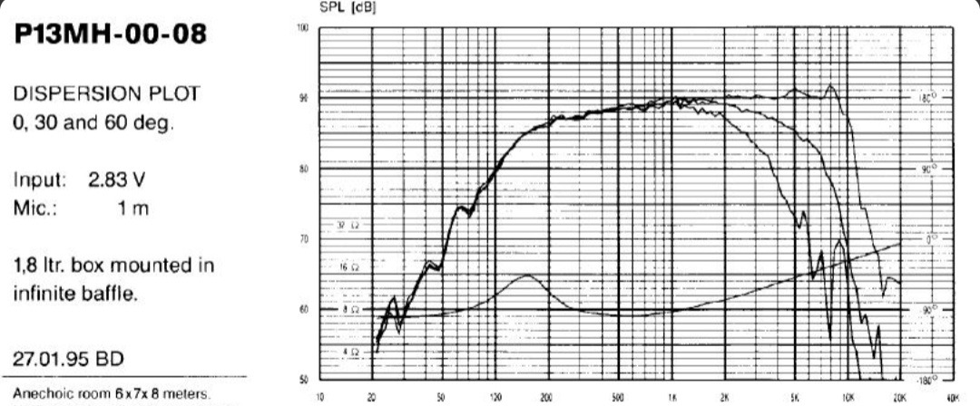

Slightly off topic gents, is it true that Vifa P13WH-08 is said to be really really good even for todays standard ?
That is a unicorn driver. I think its one of the best poly cone mids ever made (specifically the m13 model with shorter VC). Its smooth yet open. Not much of that usual veiled poly sound. The M10-MD39-08 is another great one. I wish they still made those two models.
I still have a pair of P13s but they need new surrounds. The old ones have gotten so stiff raising Fs to 130 Hz. Appears to be a common issue with these.
