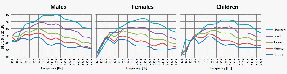

Concerning voice coil diameter, what is the consensus on different size?
I can see 5 inch midranges using 1" and 2 inch midranges (softdome) using 2".
On this image one can se the humans frequency, and a good target may be to find a driver who don't need a joint in this area.
https://www.dpamicrophones.com/mic-university/facts-about-speech-intelligibility

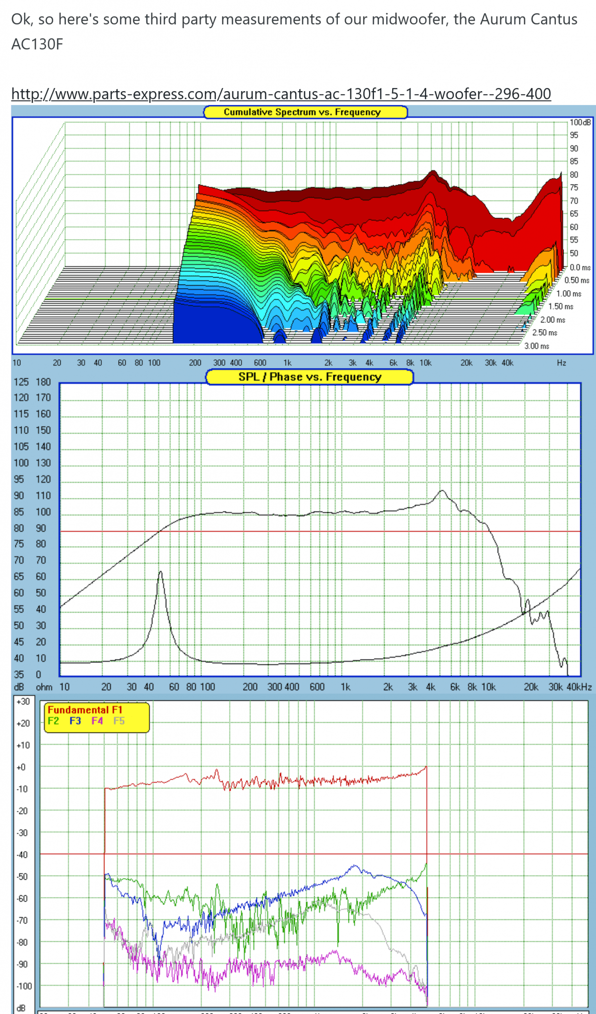

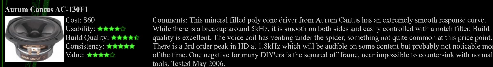

Thanks for the tip for the Aurum Cantus AC-130F1 5-1/4" It looks good to cover all the mids without XO; or even as a "full range"...aurum cantus ac-130f1. Another highly recommended mid.
Did you ever hear the distortion - HD3 @1.8kHz eg a female vocalist sound a bit harsh?
Did anyone push it up past the 5kHz breakup?
Info below posted for prosperity on DIYaudio:
The AC-130F1 is great because of the smooth extended response up to past 8KHz means if will do acoustic LR2 no problem, as long as you put in a notch filter.

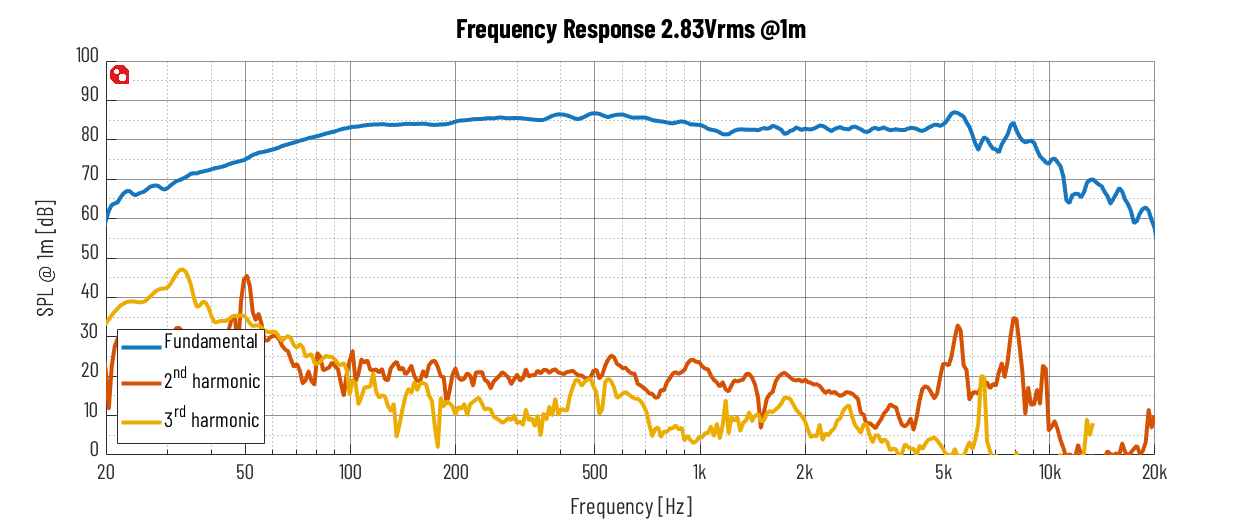

I've got the Purifi PTT5.0X04 on hand- it's not a pure midrange but I'll be able to take some measurements this weekend and report back... it's little brother is a phenom out past 60-90 degrees in a 13cm wide box, so I wouldn't be surprised if this one also measures very well...
Purifi PTT
Wow. Those new Purifi drivers look good.
The new 5 /14" 4ohm HD2 vs HD3 looks great: PTT5.25X04-NFA-01 2.83Vrms
https://purifi-audio.com/ptt5-25x04-nfa-01/
