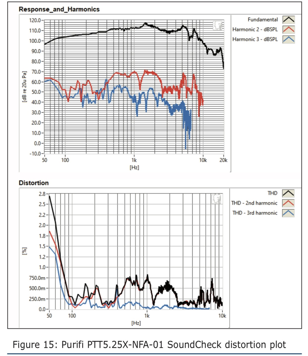

They have been tested in the newest VoiceCoil Magazine.The Purifi PTT5.25X04-NFA-01 is going to be hard to beat on measurements, but the cost is going to be a barrier at 400euro/USD. No thats not for a pair. Its for one (1) only.
The mid-range is absolute excellent (as expected), but the low frequency part not so much.
By Vance Dickason, VC testbench;
They claim 8.8mm cone excursion.Displacement limiting numbers calculated by the Klippel
analyzer for the using the full-range woofer criteria for Bl
was XBl @ 82% (Bl dropping to 82% of its maximum value)
equal 9.8mm for the prescribed 10% distortion level. For
the compliance, XC @ 75% Cms minimum was only 4.6mm,
which means that for the Purifi woofer, the compliance is
the more limiting factor for getting to the 10% distortion
level.
There seems to be quite some offset in the BL as well as the Kms.

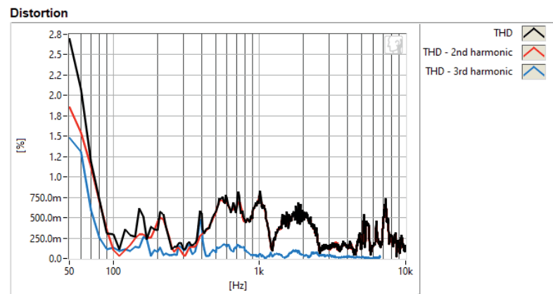

Added is the distortion plot @ 94dB

To put this in contrast, the Dayton E150HE-44 does basically very similar for the low frequency part in terms of distortion, while having a lot more cone excursion. The mid-range isn't as good obviously.

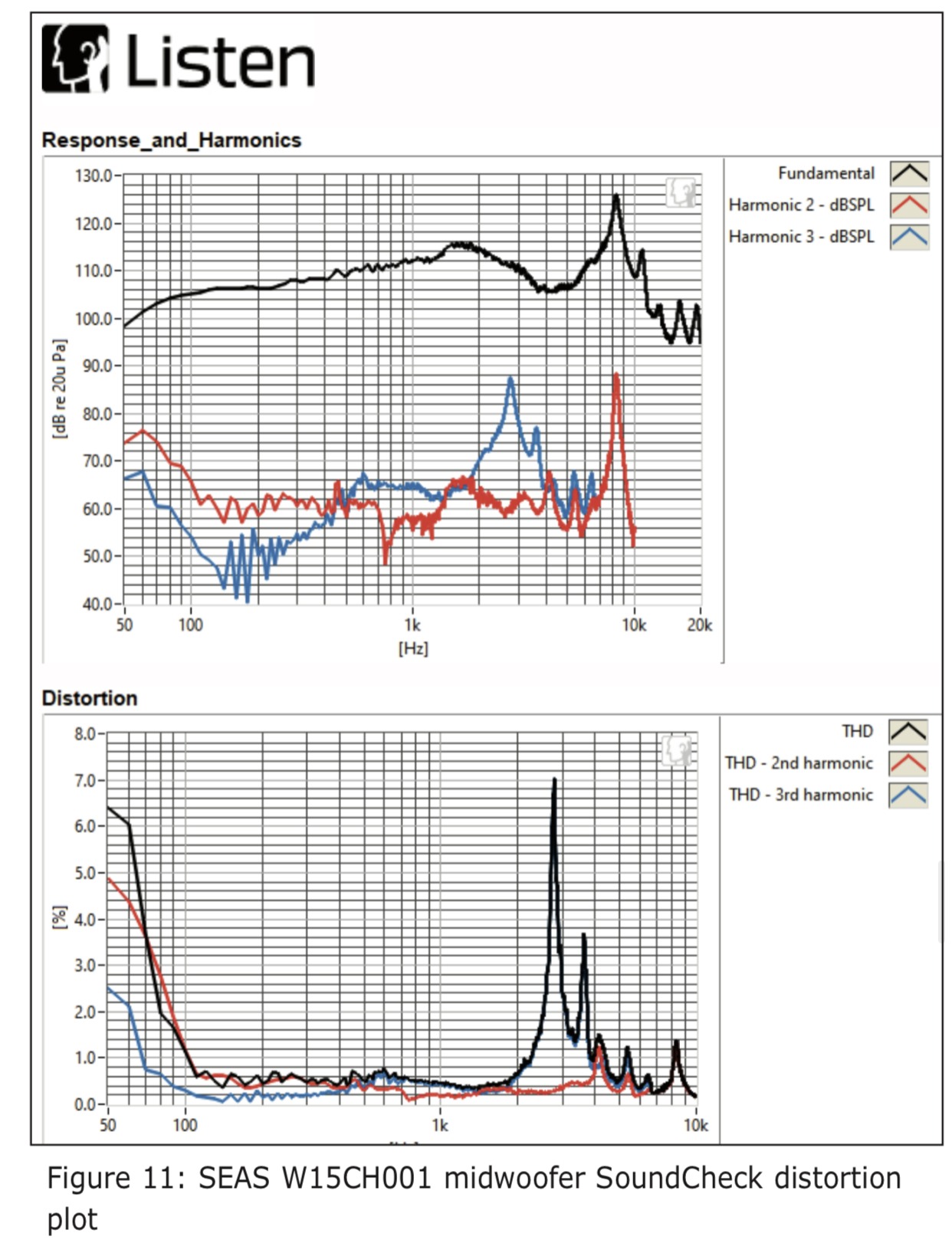

In July 2022, VC tested the decades old W15CH001 that @gainphile suggested
“ Displacement limiting numbers calculated by the Klippel analyzer for the SEAS W15CH001 were XBl @ 82% Bl=4.82mm and for XC @ 75%, Cms minimum was 5.1mm, which means that for the W15CH001, the Bl was the limiting factor for the 10% distortion criteria, but both number were beyond the 4mm physical Xmax of the driver, so definitely good performance here.”
