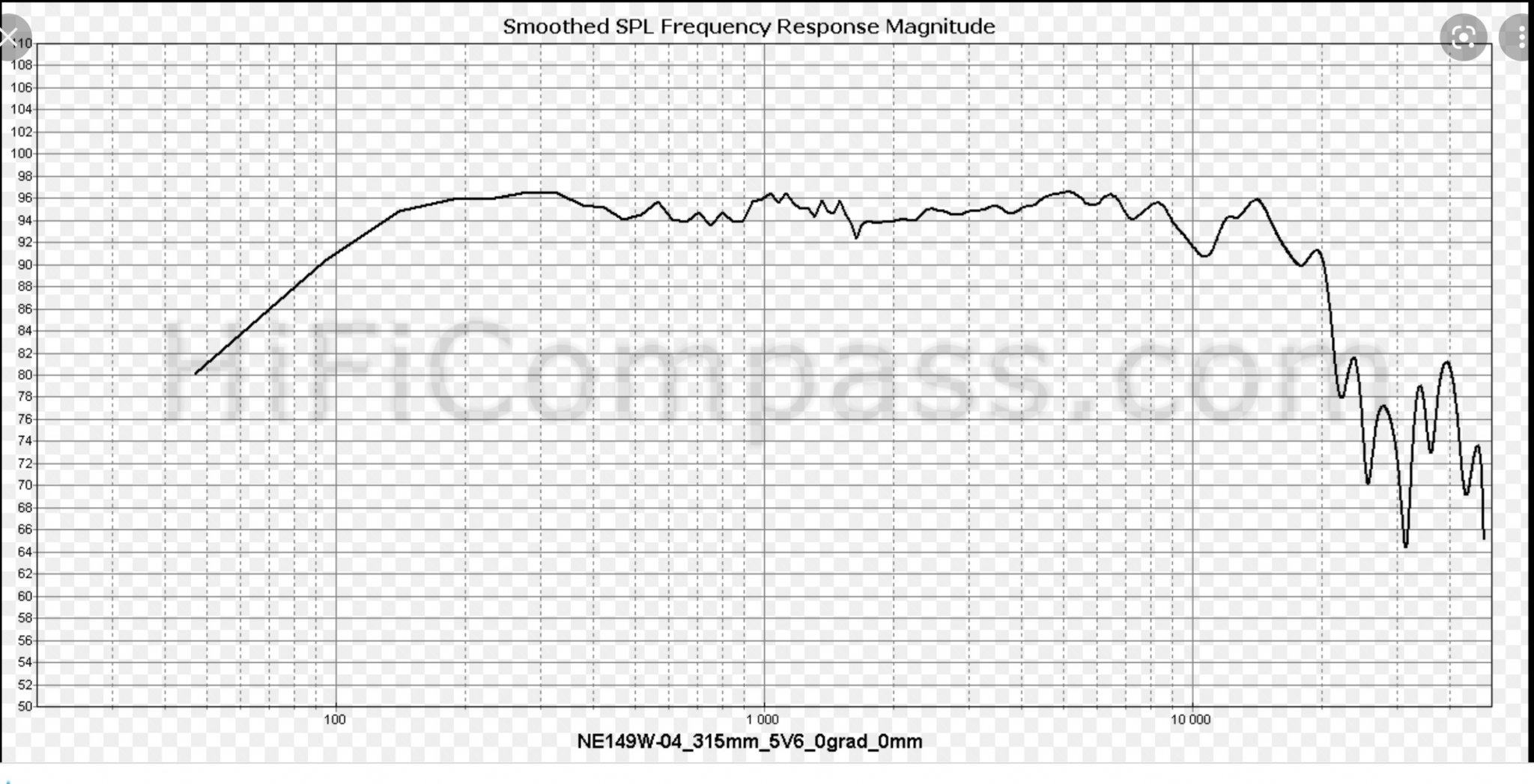

Actually the Purifi is not all that impressive from the FR or linearity point of view. Actually the opposite. It’s drop like a rock after 4Khz; many other 6.5” drivers have an extra octave or so. What impressive about the Purifi is the non-linear distortion.
I thought that was a good thing.
No breakups to deal with, not much overlap with tweeter, simpler crossover.

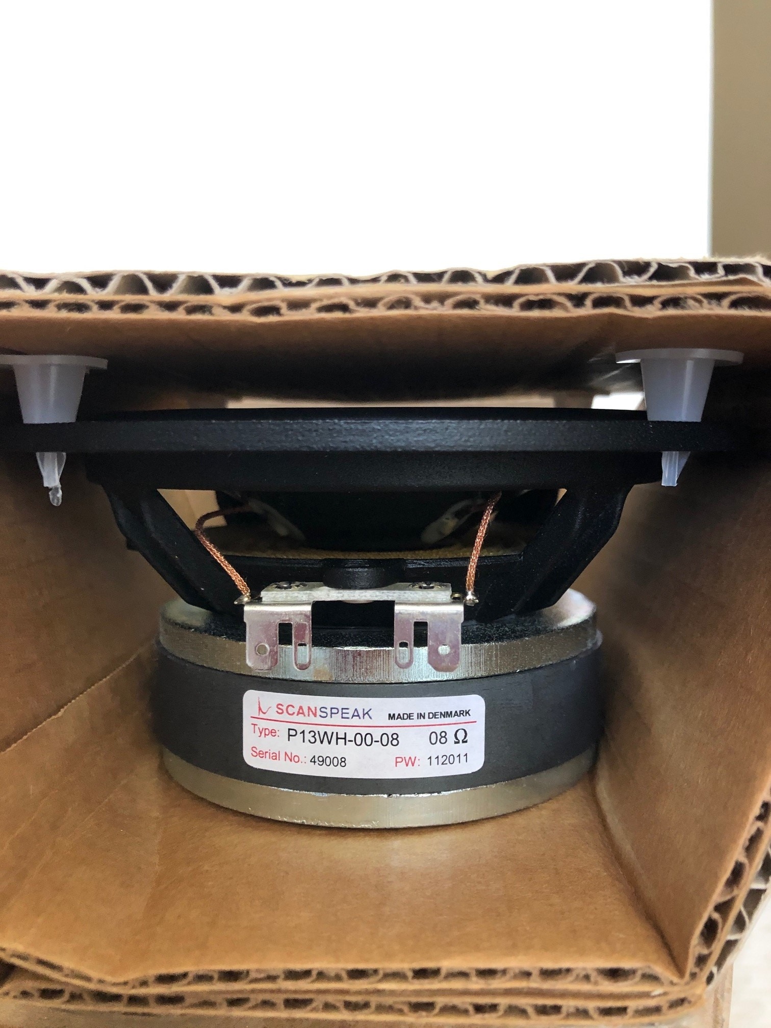

Currently soaking the surrounds of my P13-WH in glycerin. I have a bunch of spares gently stored away for nearly 10 years waiting for install in the boxes. With zero use stored in climate controlled room in boxes and cabinets (zero UV) the surrounds still managed to stiffen up. Fs over 200Hz.
Hoping to get some progress on a used test woofer for proof of concept. Thus far, overnight soak with low frequency excitation has not done much. I might have to get creative and try a method to add some heat to the process.
Here I thought I was smart to buy spares, but they outgas nonetheless. I don't know there are replacements available - I would be happy enough to find a speaker that at least meets the same mounting and holes.
