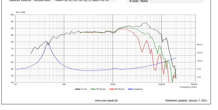

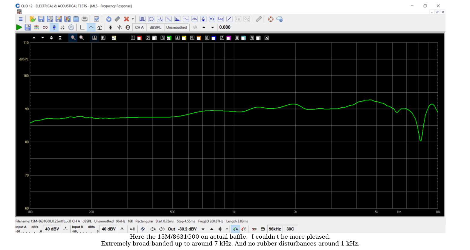

Wow ... flat, one can just see the baffle loss. Thanks for the measurement. What is the width of the baffle please, no filter nore box either, just a baffle? I looked at SS datasheet, does the difference come from the size of the baffle test.
Looks like nearfield, suspiciously smooth. But I'm not familiar with Clio MLS...
Is the baffle step hump eq'ing 1kHz dip of factory measurement?
https://www.scan-speak.dk/datasheet/pdf/15m-4531k00.pdf
wait.... are you showing the 15W or the 15M ? You write about the sliced membrane, which is the 15W Revelator - but the graph is 15M?
25 cm measuring distance, so no correct add-up (I really don’t see the virtues of such measurements…). It’s the new TG design.Looks like nearfield, suspiciously smooth. But I'm not familiar with Clio MLS...

I linked the midwoofer instead of mid, like nicoh58 says he measured in post #133.

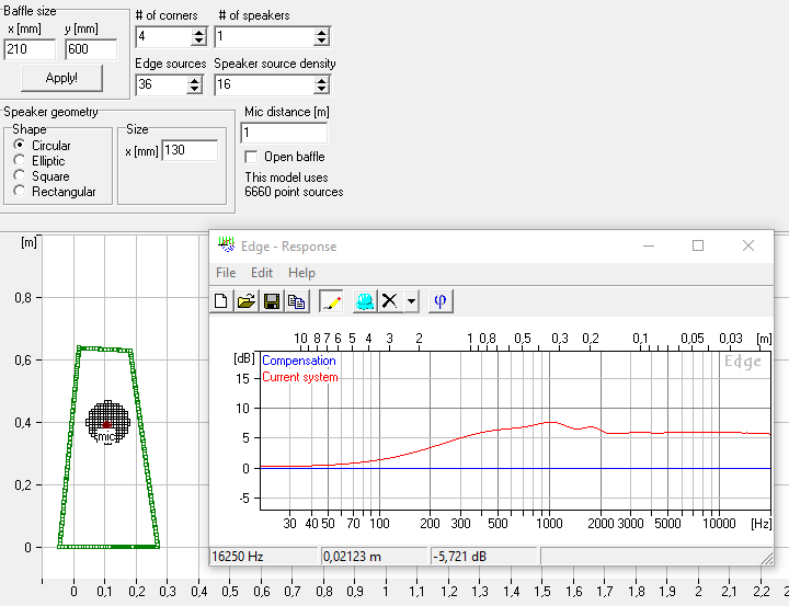

25cm distance in measurement doesn't tell all of baffle effect, because TG 851 has quite wide baffle. But do we know nicoh58' baffle width?
Any way, off-axis responses are needed too, to evaluate a midrange's match with the tweeter.
More about Gravesen's Revelator-851 It has this 15M http://www.troelsgravesen.dk/Revelator-851/15M-8631G00.pdf in a quite narrow trapezoid baffle. Pretty good pair!
