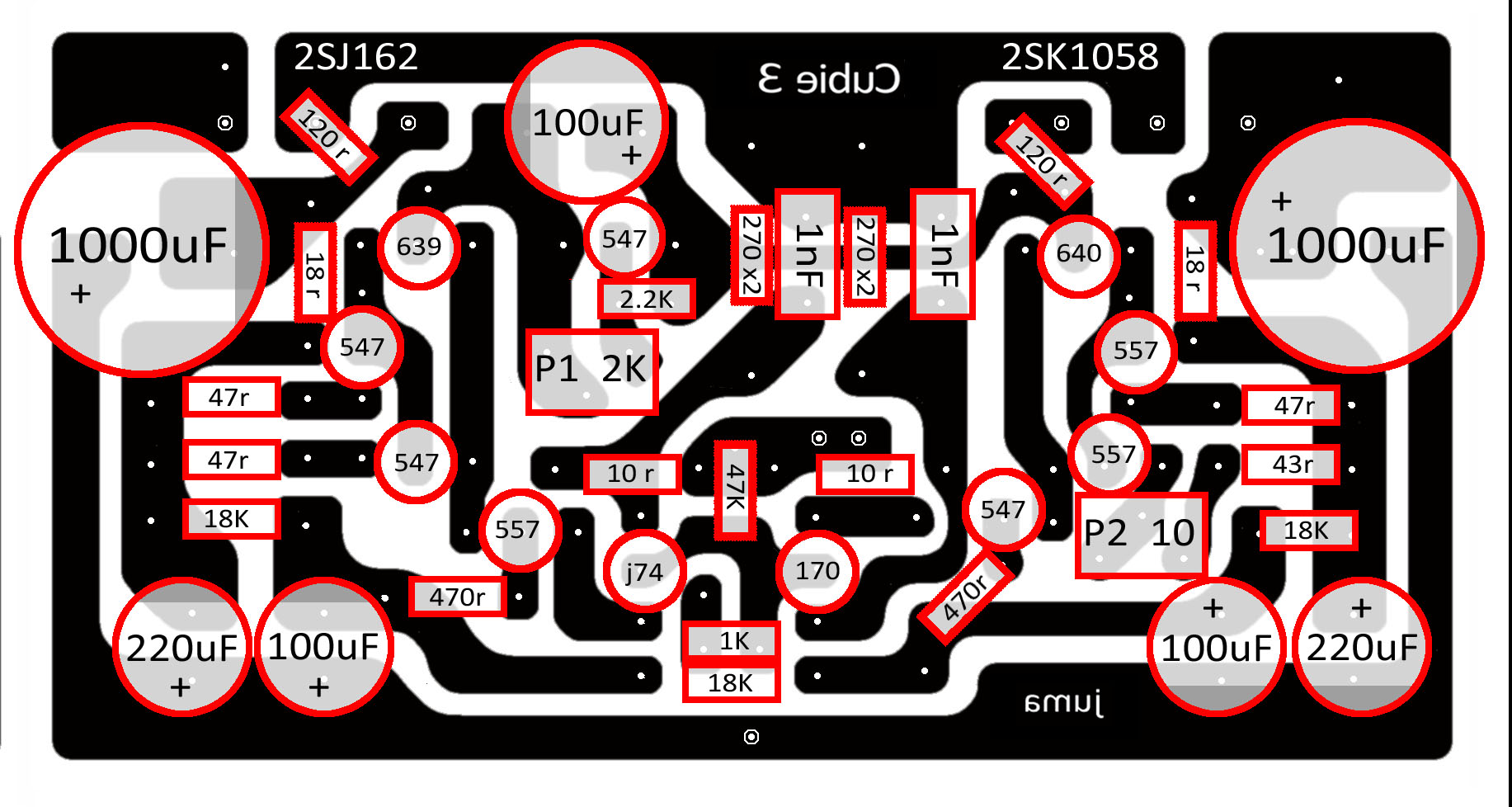

Spent some more time on PC art. Anyone who hasn't etched yet, PM me and I'll send you current art. Thanks - marsupialx:cubist:

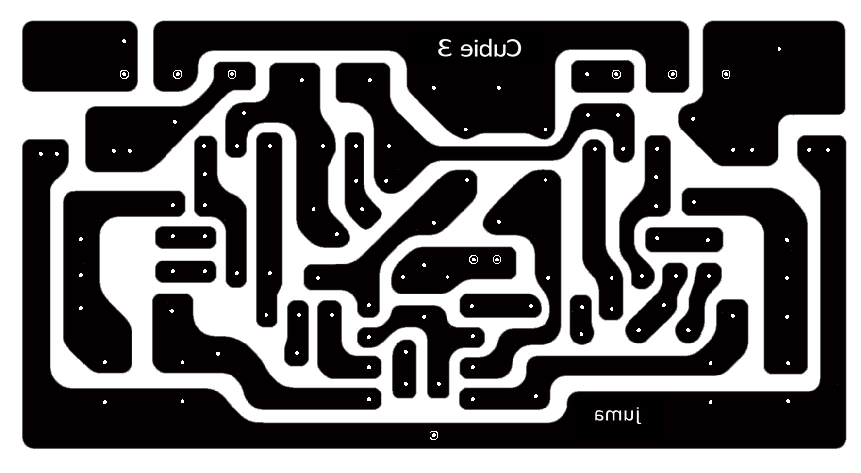

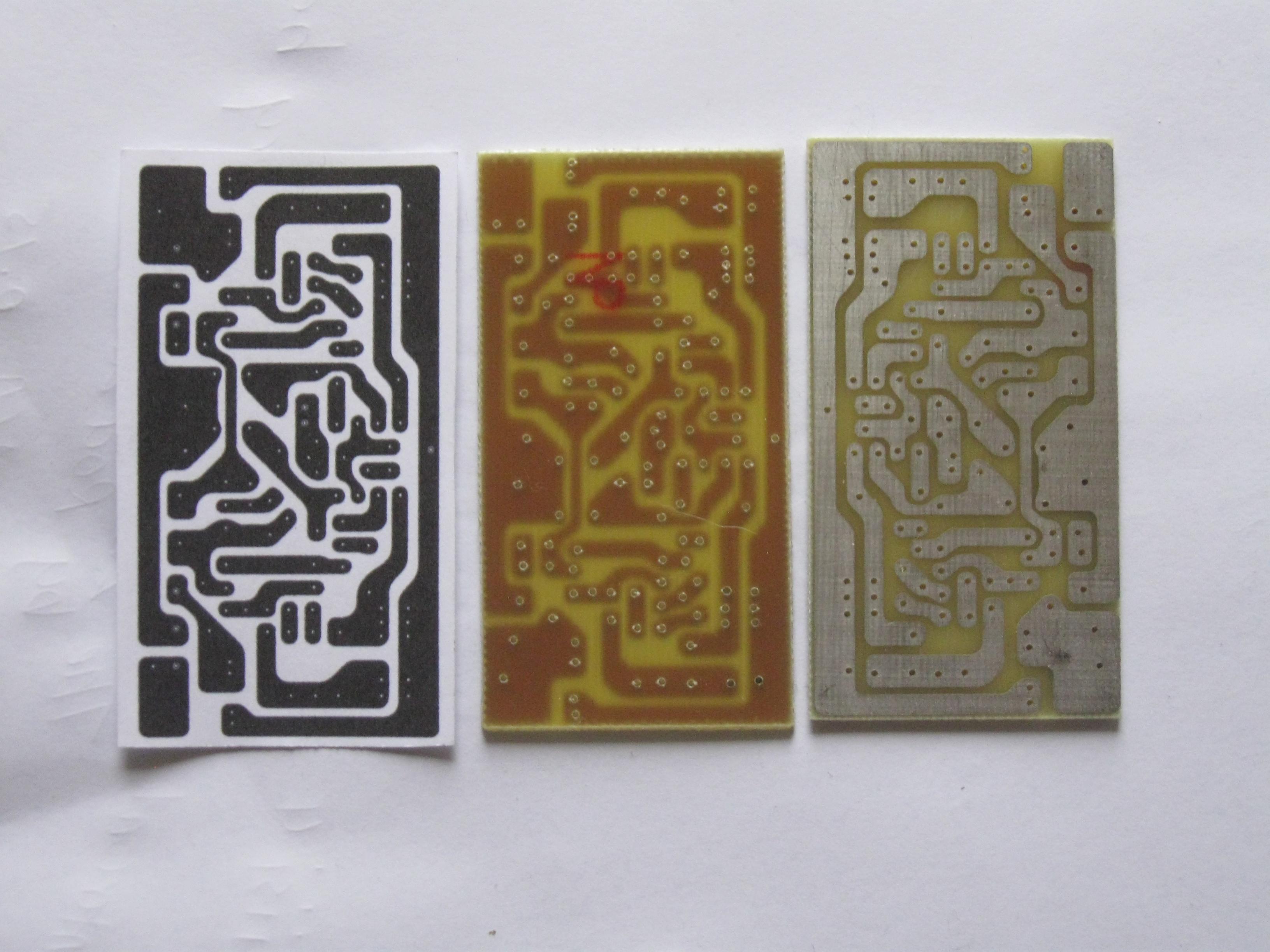

Just finished making the Cubie 3 PCB's.

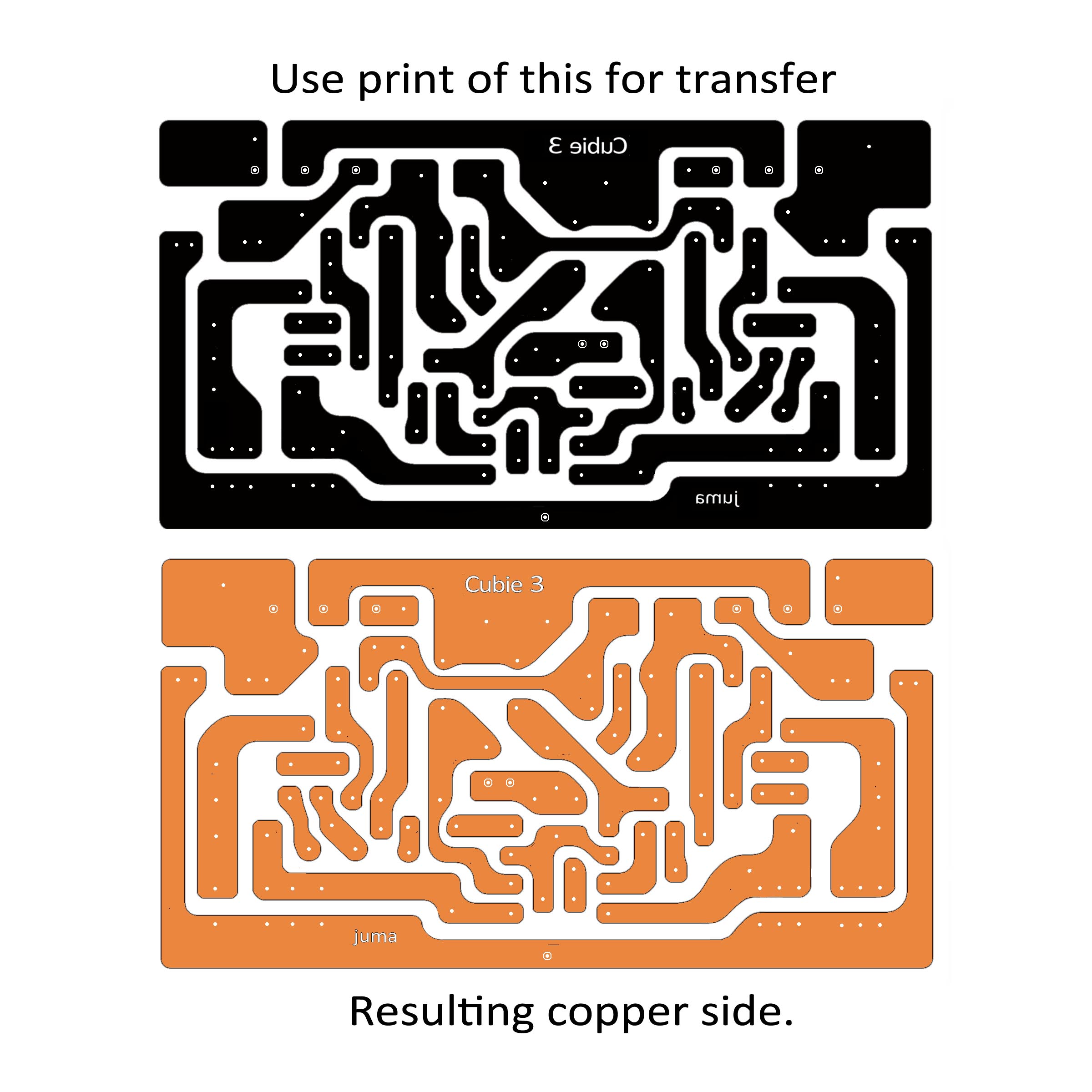

Did you do the boards photoresist etch or iron transfer?
The reason I ask is the laser printout seems correct for transfer etching, but your board looks the same as the laser print, and it should be a mirror image. Just to avoid weirdness, look at it and make sure it is correct. If it is mirrored, you will have to pay very close attention to all polarities during build.
Another option is to build it inserting the parts on the copper trace side. The only problem is electro caps, since they block the solder pads if inserted fully. If one left just enough space to carefully solder them, and then use silicone to fill in the space, or let them stand on their leads (which could vibrate), one could populate a backwards board. I re-etched the Slewmaster board I originally etched backwards. Ps, the type (cubie3 and juma) should read correctly on the copper side.
