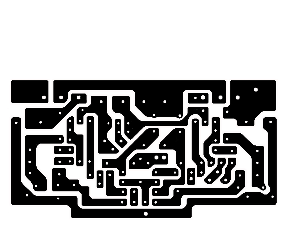

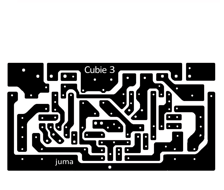

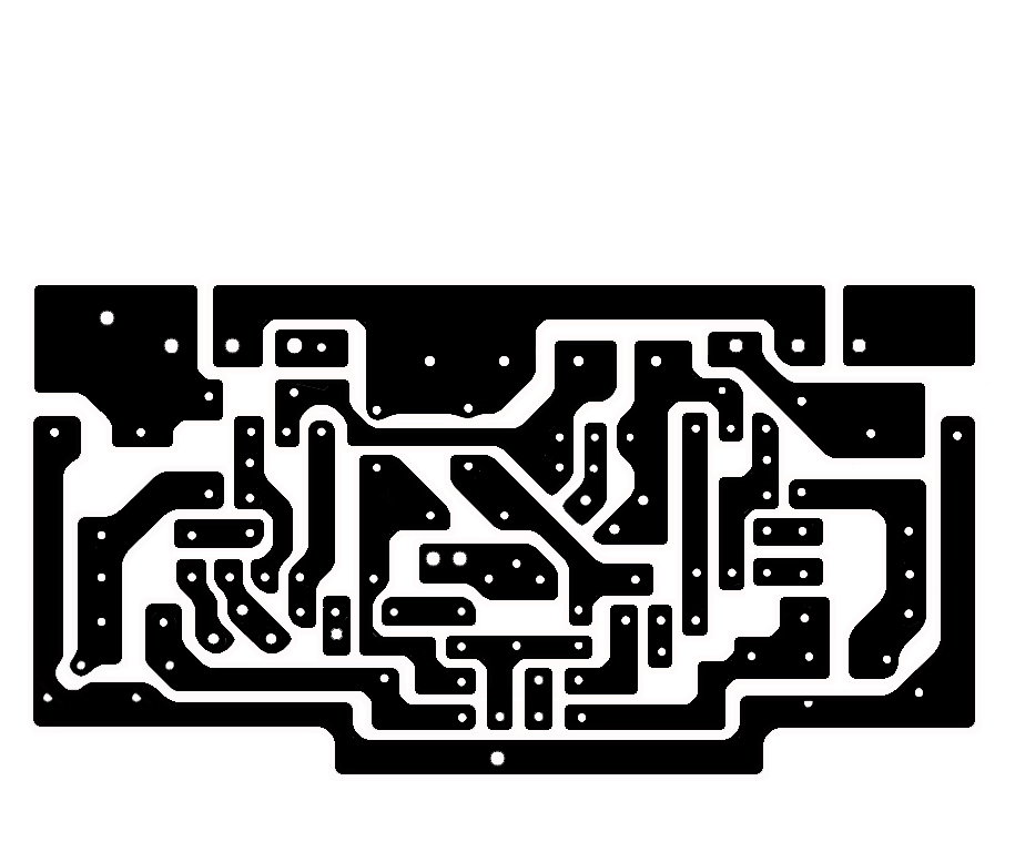

A layout that should fit my Cubie/Cubie 2 Chassis. :cubist:
(Reversed for etching.)
Cool, thanks!

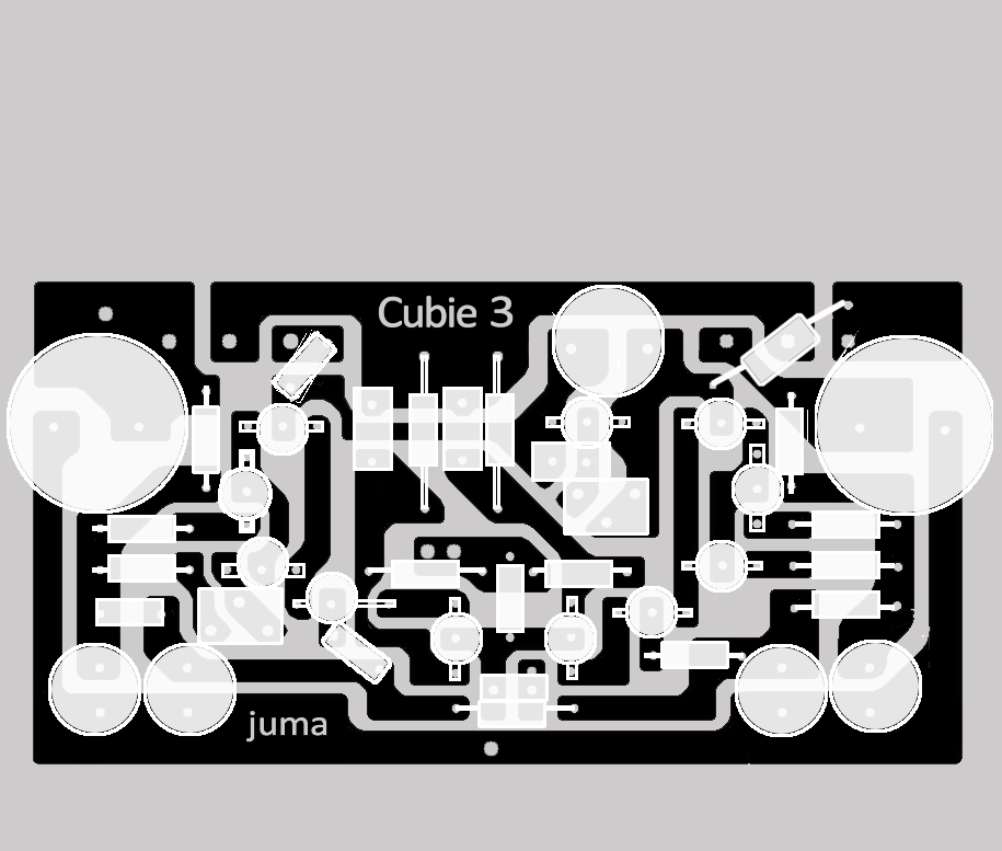

Could you include parts (position, size)?
Which is copper side view (I am confused)? Adding some text label(s) on the copper would help.
Also, could you indicate the dimensions or add markers to make sure things are scaled correctly?
The file here is a low res file. The thing to do is have me email you a pdf of the larger file. PM me your email address. I have not done a part placement, but I will.
I wasn't going to do a Cubie 3, being way more than happy with my Cubie 2, but another very nice DIY member asked me to do it, so I did. I am not, however, mentally equipped for tech support. Others will have to provide that.
The reversed file is for laser toner transfer etching. You are looking at the foil side. I will post a parts placement in the near future.
If somebody wanted to go through juma's original post and insert values for all of the parts, (from schemo to juma's layout, that would be very helpful. I'm trying to make sure I don't screw up. It would be a drag if little puffs of magic blue smoke dotted the landscape around the earth because of my mistake.) it's ok if I let the smoke out of my parts, but I'm not building this for the foreseeable future. Thanks. Nobody should etch yet.:cubist:
