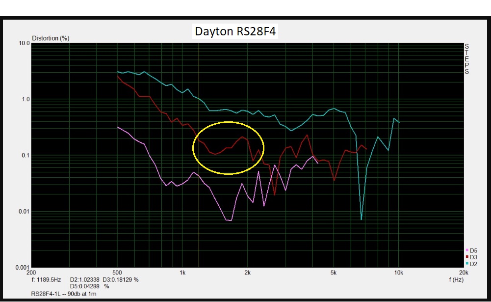

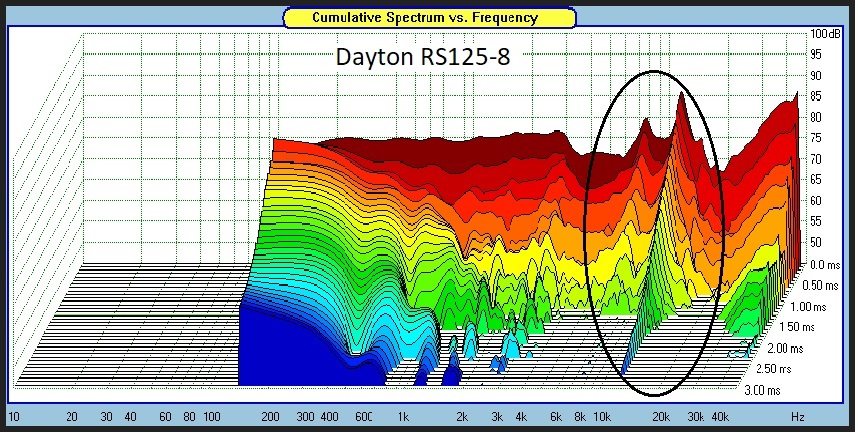

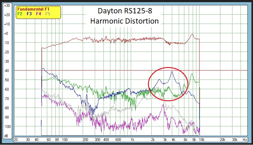

So besides looking at how driver directivity and Fs influence xo choices, the other 2 things I mentioned were harmonic distortion and cone resonances. I couldn't find both of these for all the drivers but I've attached below what I did find.
Let's start with the tweeter.
1 - 3rd order in red is the worst offender and doesn't start to increase until below about 1200Hz. That means a low xo point is in the cards. (image from www.audioexcite.com)
2 - A repeat in visuals of the mid's FR noting best and acceptable off-axis range and the bad stuff from cone break-up and resonance peak. It may actually be hard to hear but that 12000Hz peak should be well down in the mix.
3 - Harmonic distortion for the mid though shows some peaks at about 2600Hz and 4000Hz. Also something you want to keep down suggesting it's best crossed over below about 2000Hz. (image from ZaphAudio)
4 - Cumulative Spectral Decay for the mid just reinforces what that 12kHz resonance peak looks like. (also from Zaph)

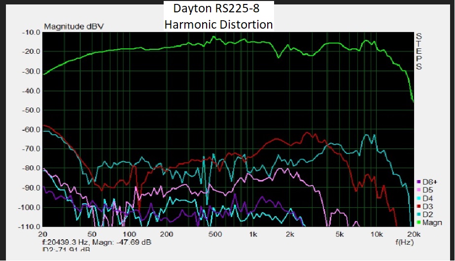

5 - Looking at the woofer now, harmonic distortion is excellent between about 40Hz and 1000Hz. No real limitations here. (can't actually remember where I copied this graph from but it was only HD not the CSD)
Conclusion? The tweeter is capable of a lower xo point and the mid is probably best with one too. I would probably try out LR2 acoustical at 300-400Hz for the lower xo point and maybe LR4 acoustical at about 2000-2300Hz.

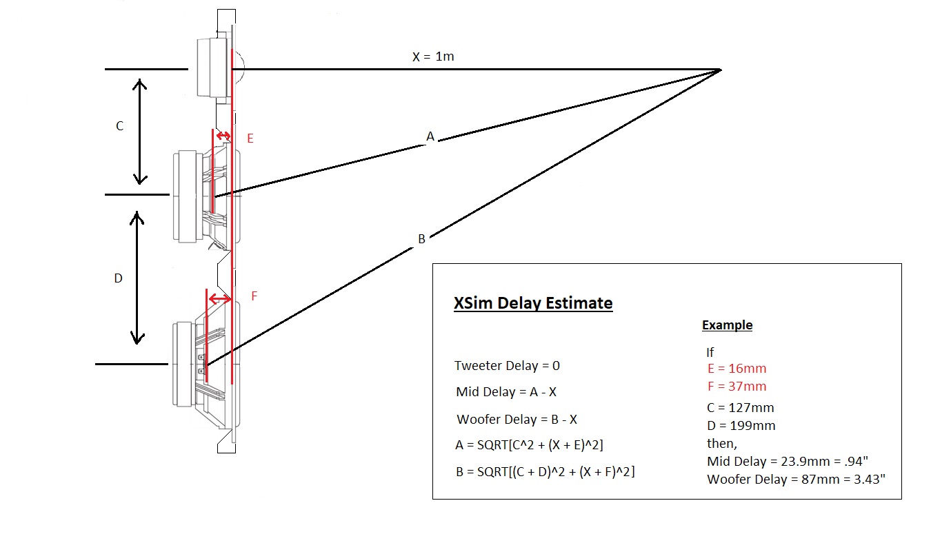

Pic 6 is how I estimate the delay variable for the mid and woofer in XSim. Basically I imitate the mic set-up I would use to actually physically measure the drivers for the purpose of obtaining the delay. Note that we are trying to determine the differences in path lengths from the listening/mic position to the acoustic centers of the drivers. In both PCD and VCAD you only have to input the mic/listening distance and driver positioning and the program will do the geometry for you. Here in XSim, you need to take the extra step and do the calculations yourself.
To figure out the acoustic center distances, I use the spec sheet for the drivers blown up to real size on my screen and then physically measure with a ruler. Acoustic center for a normal tweeter is at about the bottom of the faceplate. The AC for the other drivers is best determined where the cone meets the voice coil or right about where the spider is. Acoustic centers in the pic are what I came up with using this method. That makes the delay data good to go into the program.

I'm giving my thoughts on the upper xo a bit of a re-think. That harmonic distortion on the mid isn't too too bad and it isn't accompanied with corresponding resonances, so I'm thinking LR2 slopes at between 2k and 3kHz should roll it off adequately. Maybe only consider LR4 if that doesn't work out in the sims or it doesn't sound good.

As far as I can figure it out, yes I think my math is correct. I loaded the formula into Excel and I've triple checked it and triple checked it again. I get the same mid delay of 23.9mm and now I get a woofer delay of 84.8mm.
Just checked it again with a lowly calculator. Same result.

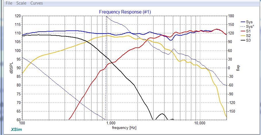

I finally got the driver delay math to work out properly and entered it into Doug's crossover design. The resolution of my display (large icons on a TV) won't let me see the OK button when I try to display the driver phase so I can't see it but I assume that's what's causing the drop in response between 3 - 10k.
