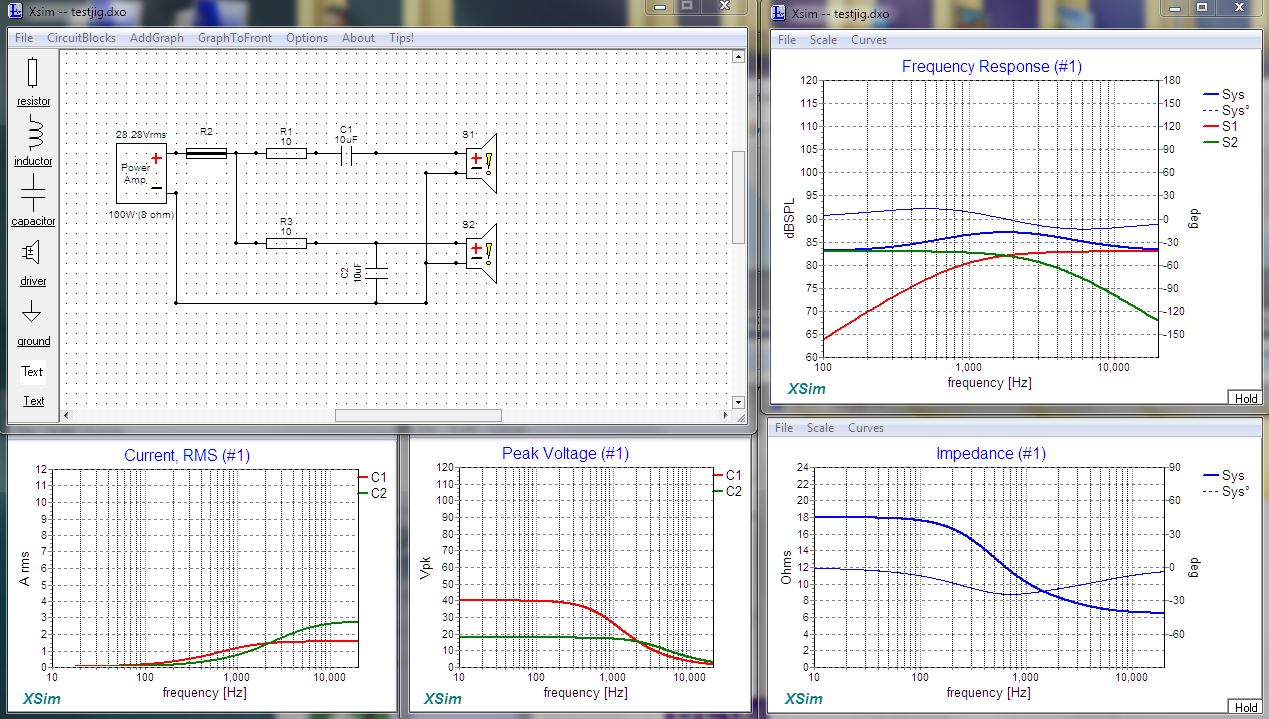

The xo program is XSim which doesn't use x, y or z (zed) coordinates but only inputs the differences in the path lengths from the mic to the acoustic centers of the drivers. From there one can separately calculate the relative acoustic centers and then re-calculate the path length differences if you wish to change the listening distance in the simulations. A slight drawback in the software in my opinion.

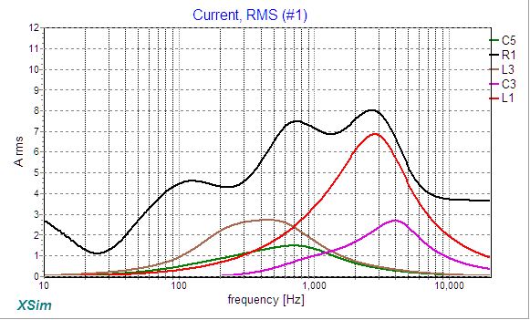

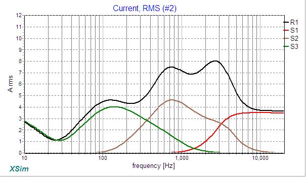

Note the current and power for the BS resistor (R1)... yep that's gonna be one beastie of a resistor. With musical decay taken into account I would want at least a 20 watter in there. And that coil is no slouch either, it would weigh a couple of pounds.

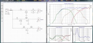

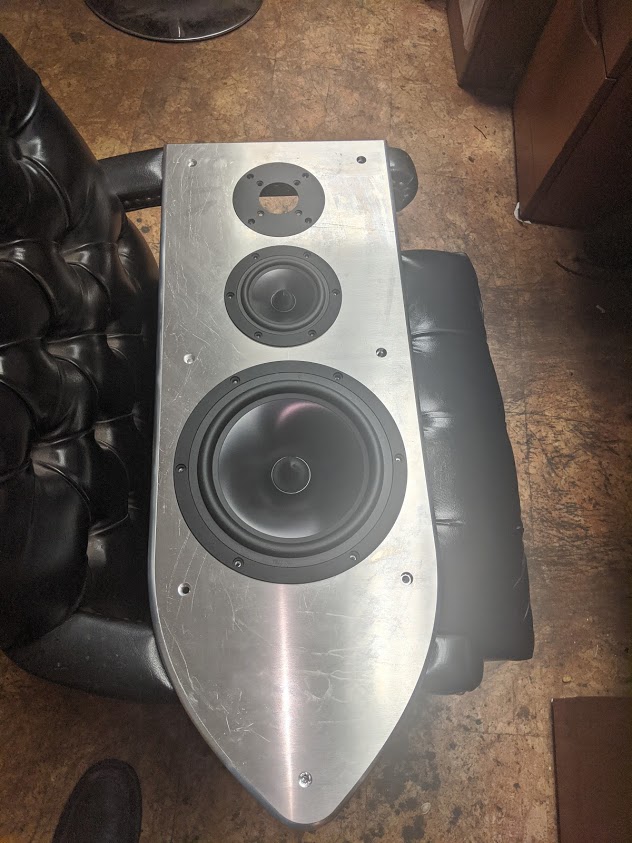

Here's another batch of measurements. I've still got some issues with the microphone input levels, it's recording too quietly. Hopefully these files will work though. I added some sound absorbing foam insulation behind the drivers for these measurements.

jwilhelm,

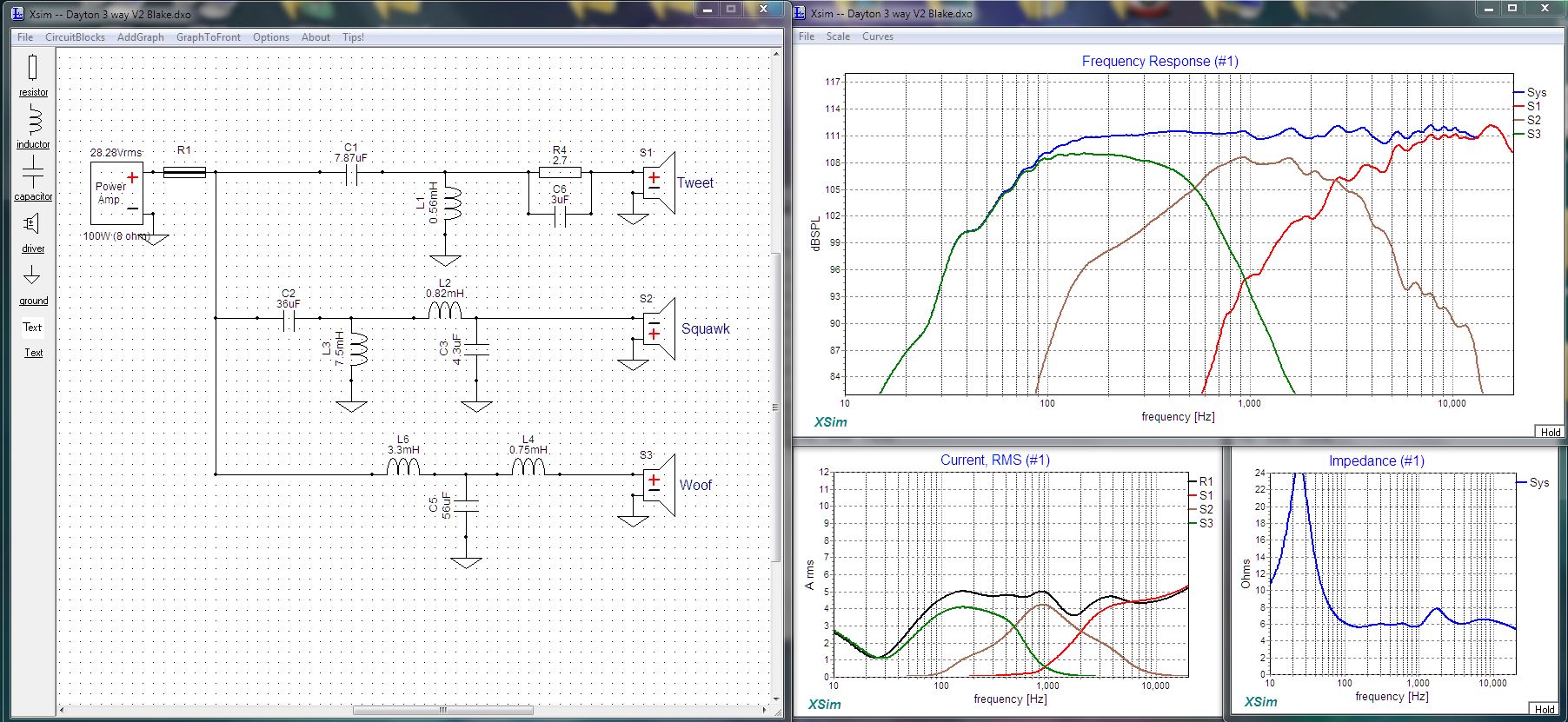

I've gone over your new measurements and I'd say congratulations are in order. Everything I've looked at so far looks to be good. I've dropped the files into XSim and come up with delays for the mid and woofer that are exactly the same as what you came up with using the other technique. Which means you did everything correct the 1st time and my concerns with that method were unfounded.
I'd say drop the files into XSim and you should be good to go with a legitimate xo. To be clear, at 1m on the tweeter axis the mid delay is .83" and the woofer delay is 2.5". Doing the calculations, this means the relative AC offset for the mid is 13.16mm and for the woofer is 15mm. And here is the reason why my original delay values are different - the AC's turn out to be fairly different than where I physically measured them from the spec sheets, especially for the woofer. This is perhaps one of the biggest weaknesses in doing simulations without measurements - the AC's can be quite wrong using the rules of thumb concerning where they are supposed to be for the different drivers.
Now if you wanted to do your xo sims in XSim using a more correct listening distance than 1m which is where you took your measurements from, go back to my geometry equations and input the right data. For eg, if the listening position is 2.5m away, the delay for the mid would be .64" and the delay for the woofer would be 1.38". Interestingly, as you increase the listening distance, the differences in path lengths gets smaller due to the change in the angles from the ears to the center of the drivers.
