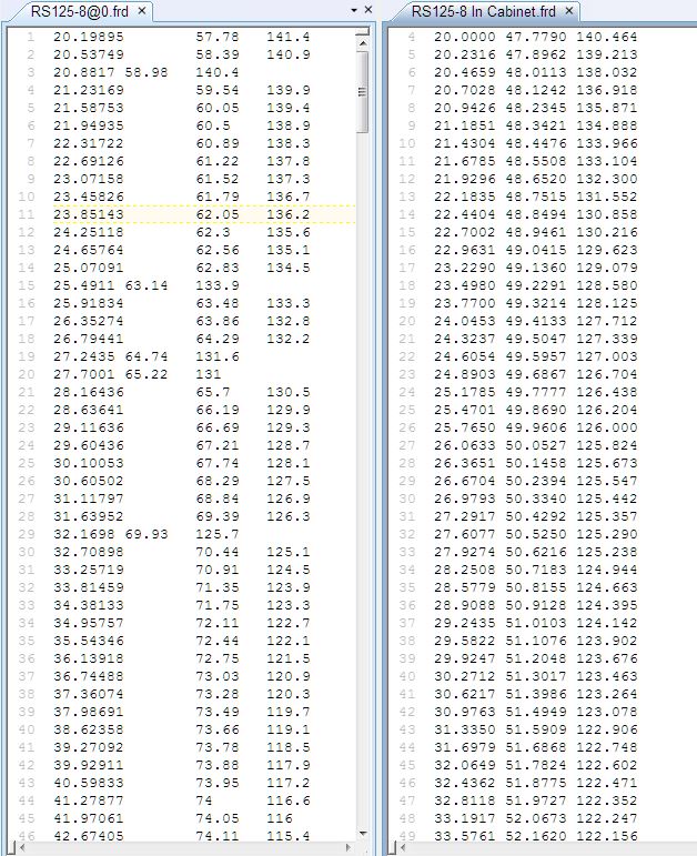

I'm missing something in the measurement process. When I take measurements in ARTA
SPL levels are recorded below 0dB levels. FRD files are written from these measurements with below 0dB levels. The spreadsheets and crossover software works with levels around 60 - 100dB. How are these levels accurately adjusted?
I think the low levels depend on the microphone SPL calibration in ARTA. I had the same problem, but if I remember correctly, I think I just put some values there to get it to 'normal' levels.

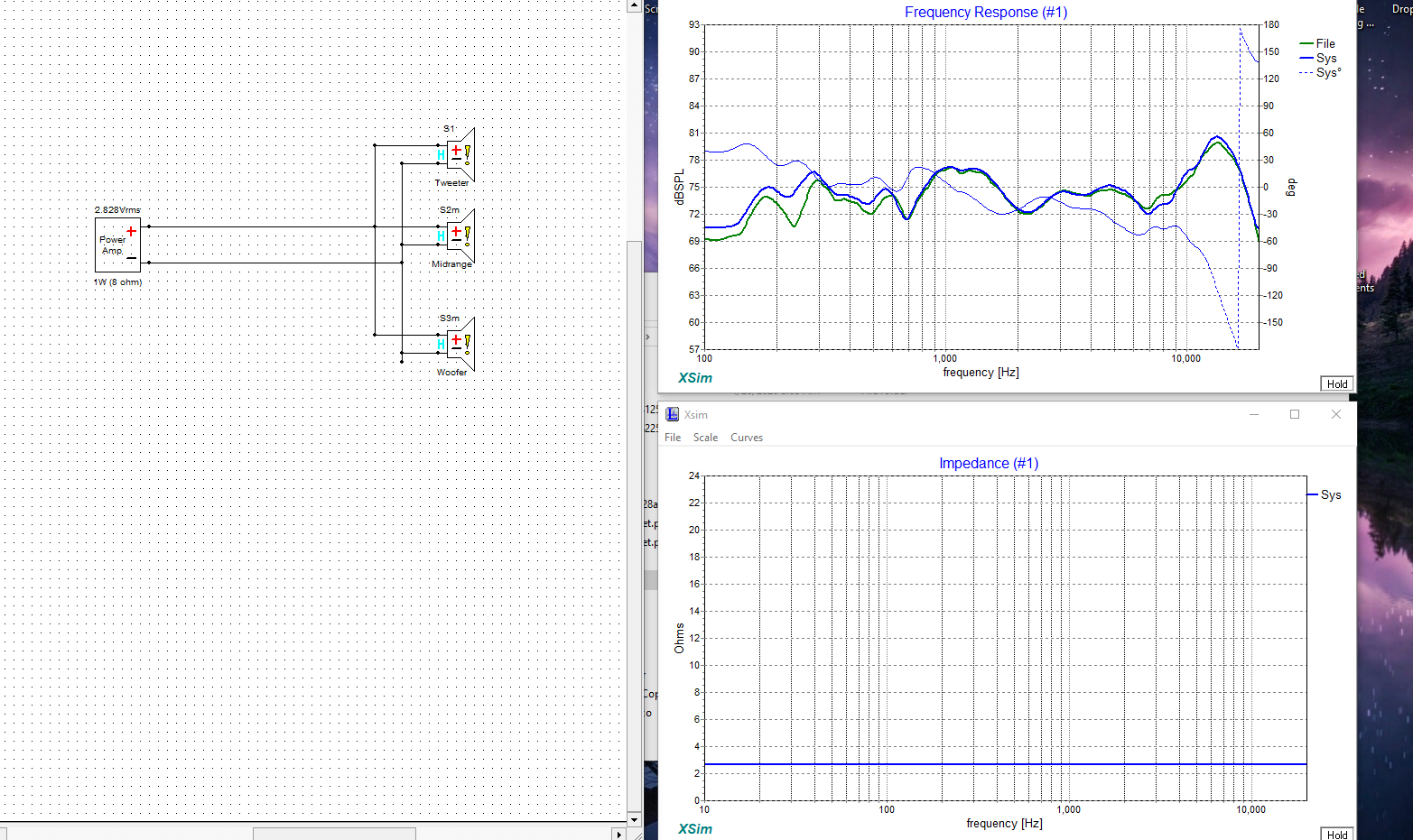

I think I've finally managed to get some response measurements that are worth using. Now I'm trying to figure out the acoustic offsets using XSim. Does the port throw these measurements off? I'm not really getting anything close to what we calculated. High frequency and low frequency don't really match between the system response and my measurement of all three drivers.

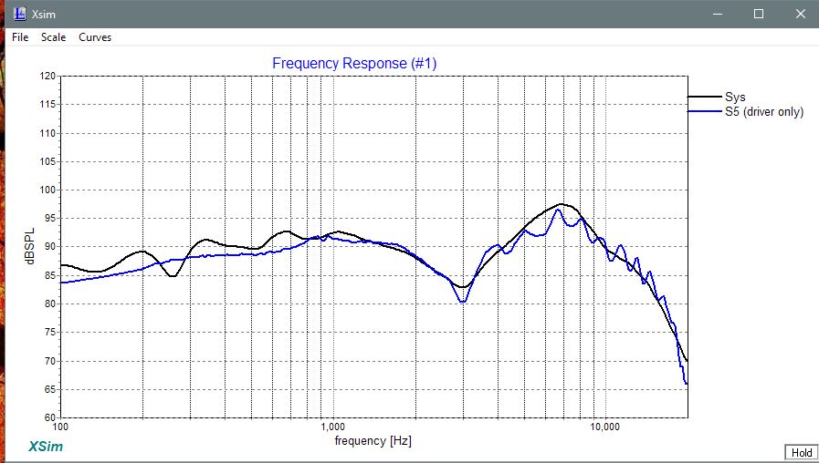

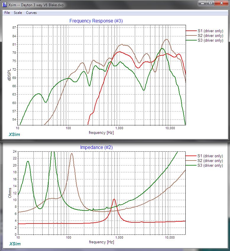

I'm attaching the driver-only SPL and Impedance plots from XSIM
I still have @JReave's coil offsets plugged in... Tweeter = 0, Mid = .94 and Woof = 3.33.
I'm also including a comparison between the factory FRD for the woofer and yours ... The levels you measured seem awfully low...
If you can confirm these are right, I'll plug it into my design and see what I can do.

The SPL levels of my measurements are going to be off, but they should be fairly accurate in relation to each other. ARTA set the clipping level of my microphone at 0 dB. My nearfield measurements were around 0dB and my farfield measurements worked out to be around - 30dB so I added 100dB to all measurements to get them in a usable range for all other software. I likely could have added a couple more dB to get them closer to actual real world numbers. It looks like I have something messed up on S3 though. It should be rolling off around 30 Hz. I'll try to blend the response again to see if I can get some better results.

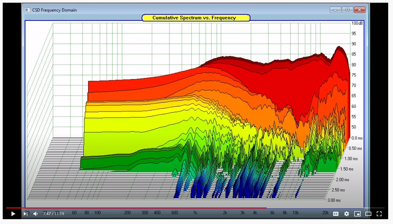

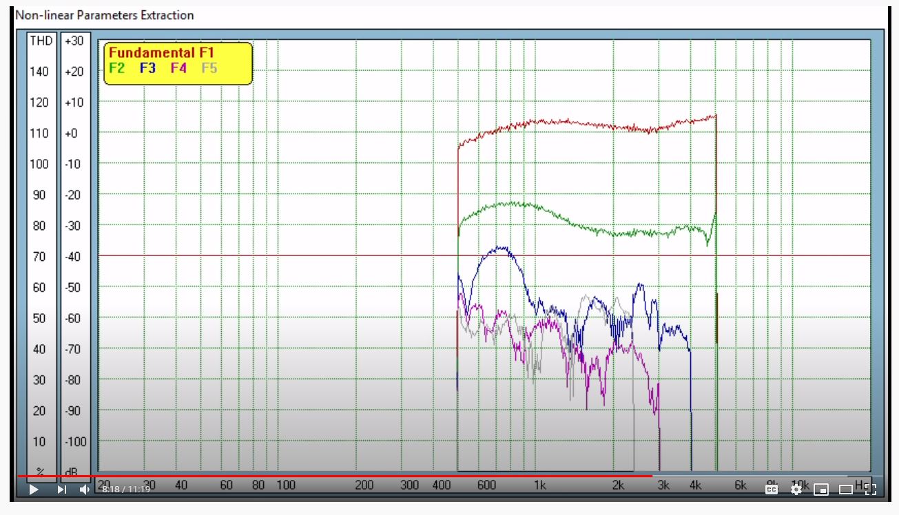

jReaved was recommending some lower crossover points so the drivers would be operating in ranges where they produced less distortion. "The tweeter is capable of a lower xo point and the mid is probably best with one too. I would probably try out LR2 acoustical at 300-400Hz for the lower xo point and maybe LR4 acoustical at about 2000-2300Hz." I messed around with your design for a while last week to try to get it to those points, but the tweeter wasn't cooperating at all.
If you were clipping your microphone, it is likely the measurements will be off by the amount of clipping as well as the actual levels in far field.
It would probably be better to get below -10db and then add 110db to your files...
When I measure with my spectrum analyser, I typically capture curves at about -20 db ... which works out to about 40db accoustic. This is one case where loud doesn't make us proud.
A sure sign your target points were wrong. If you have to massively manipulate a driver to get it working, both the efficiency of the crossover and that of the entire speaker will suffer.
And just how much distortion are we talking about? Most speakers, being imprecise mechanical devices, produce some pretty nasty distortion... 10% is no surprise at all. Plus, distortion tends to rise with output, the harder you drive them the worse it gets.

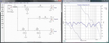

I'm attaching version 6 of the design, based on your current measurements. The large difference between the default parameters and yours is a bit concerning but as you can see, it can still be gotten to within 4 db ....
Here's a video of some measurements of this tweeter. YouTube The guy didn't mind the tweeter when first measuring it, but in later videos didn't really like it after all.

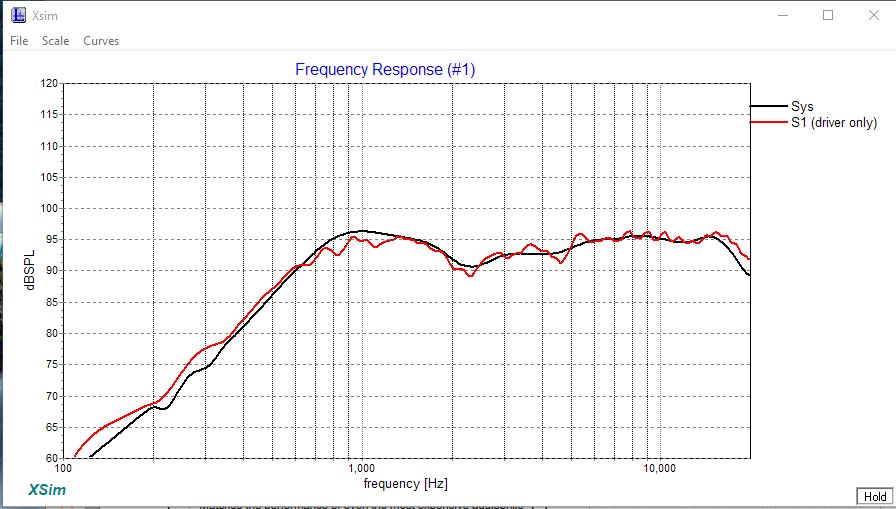

But let's look at the measurements vs the sims. In each pic below, black is the simmed response and the other curves are your measured responses. Both the tweeter and the woofer are almost bang on which is excellent. That says you are doing everything right for those 2 drivers.
But the mid is a different story. It's off 4-5dB around 1-2kHz and at the top end, as well as being about 6dB too hot overall. So maybe it's the driver or maybe it's some bad reflections from the very close mid chamber rear wall but the 6dB extra in overall SPL is hard to explain. It suggests measurement error to me. I'd go another round or 2 of measuring (even tho it may be driving you nuts at the moment) and see if anything changes. Repeatability is a sign that it's probably correct. Or unfortunately that you're making the exact same error each time......😀

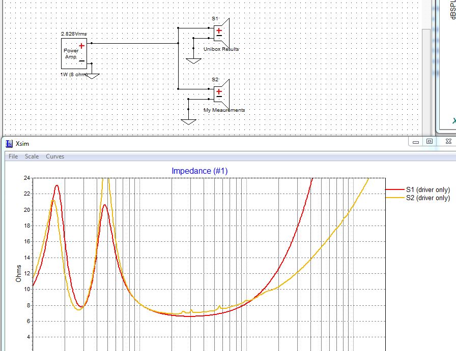

I'm thinking I have the whole measurement thing messed up. What software do most people use? ARTA does lots, but I really don't need it to do much other than record and gate some of the measurements if I understand correctly.
I've done some comparisons between my ZMA files (Measured with DATS V3) and what Unibox spits out and they seem to be pretty similar leading me to think my bass response should also be similar to the simulations, otherwise impedance curves should move. Also the way the driver rattles your guts around 30 Hz suggests it's performing well there, but my measurements show otherwise leading me to believe they aren't good.

Re zma's - Unibox or any other modeling program will be pretty close to correct in the frequency range that the box affects, ie. below 100Hz here, but it very rarely gets the rest correct. I mentioned this in the sim process in post #72 - the upper range of the modeled zma file needs to be modified to match the spec sheet measurement.
I'm going to disagree that you have the measurement thing wrong. The fact that your tweeter and woofer measurements look totally accurate suggests otherwise. Something tho went wrong with mid. I think. Unless you have a very screwy mid.
