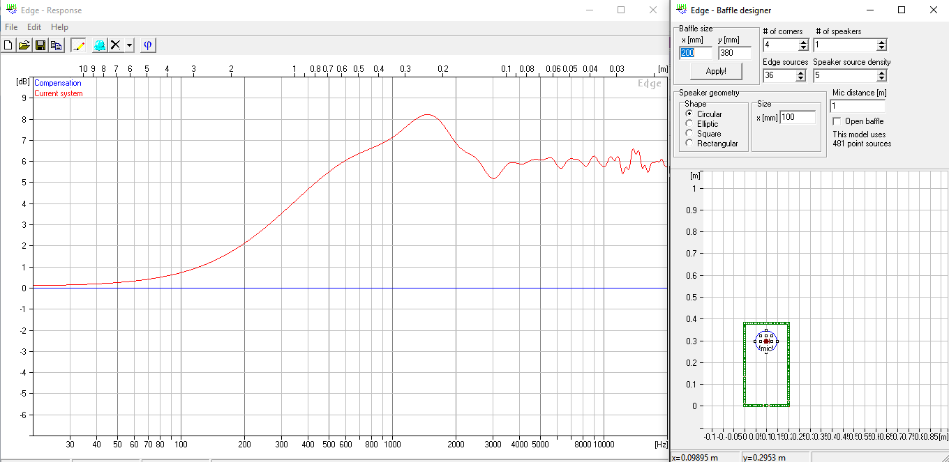

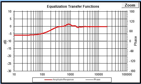

Right then. I'll try to keep this short. 😛
I actually use Unibox to do my box sims because I like how it works but I essentially use Response Modeler for all the work needed to put the new frd and zma files together.
Here's my process:
FRD FILES
- import the Dayton raw FR (infinite baffle). Pic 1
- model box effects. Pic 2 - the vented box alignment is 45L tuned to 24Hz (it's ok here if this isn't exactly what you used) and then splice it to the raw FR

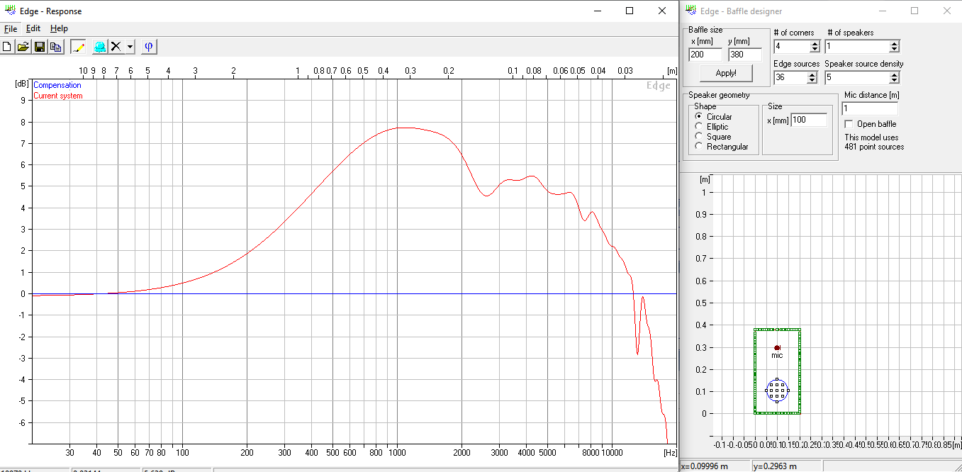

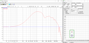

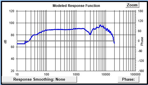

- model baffle diffraction effects - pic 3. This time I included the vertical off-axis effects. 7.4 degrees for the mid. 18.5 degrees for the woofer at 1 m distance.

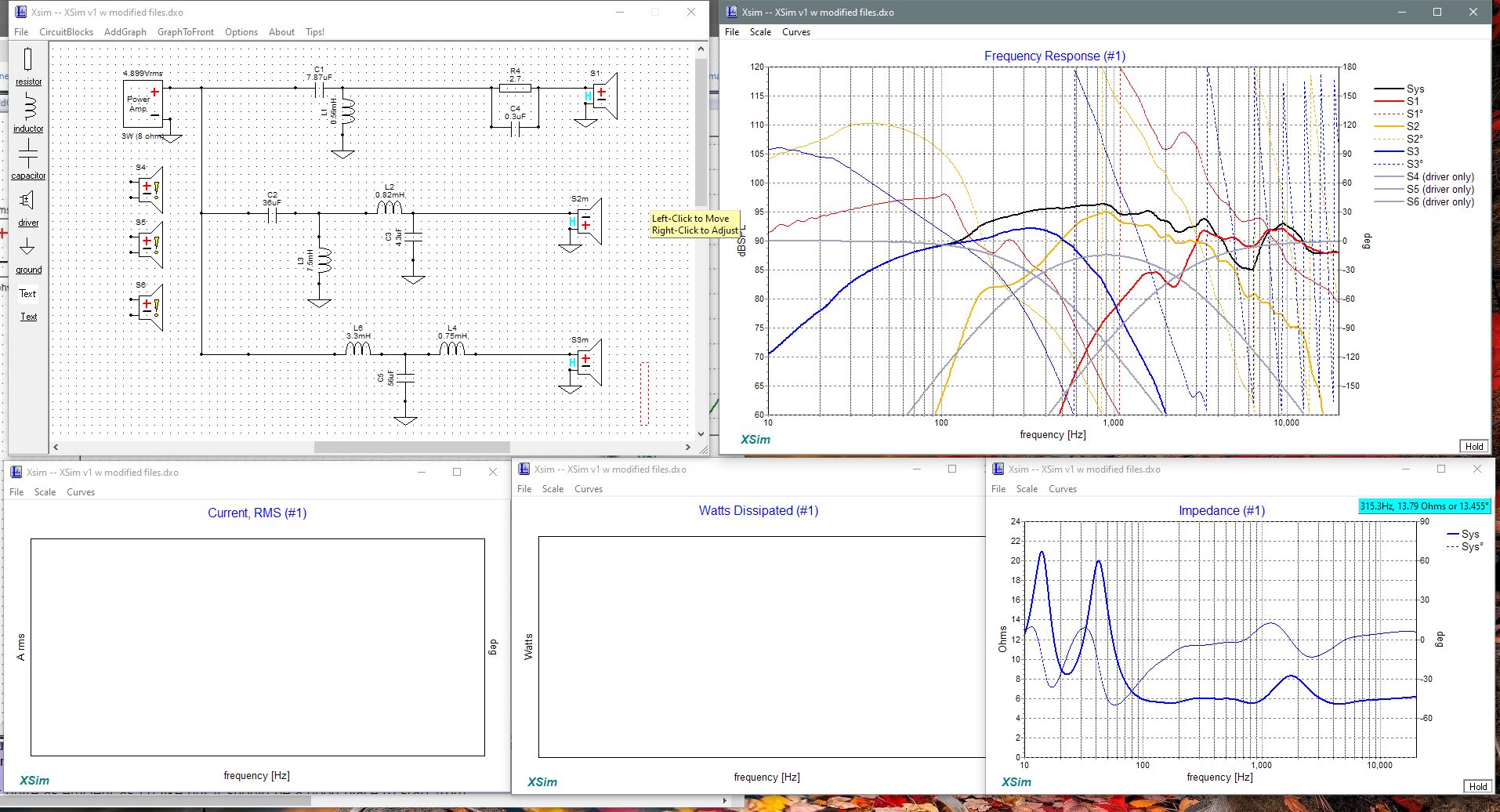

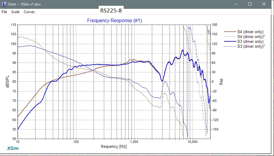

- then add the above to the Dayton frd files. Pic 4
- repeat for the mid.
- just add the baffle diffraction effects to the tweeter because it is closed back so there are no new box effects.

And that's it. We've already taken care of the XSim delays so the last thing to do is to extract minimum phase when importing the files into the program which was covered in my 1st post.
I will often do the process twice to make sure that I have done everything right. Here I double checked against the files you attached in your 1st post and I was confounded by the tweeter. I double and triple checked the original frd files and compared against Dayton's spec sheet FR graph and the conclusion I reached is that you imported a different tweeter file into your original program. You'll probably have some insight into this now that you think about it. I hope.

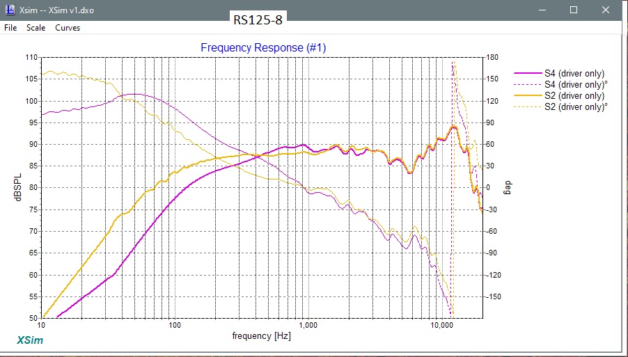

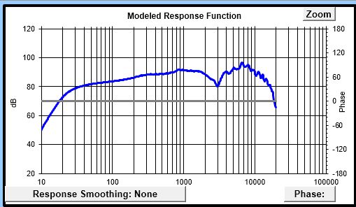

Pics 5, 6 and 7 are comparisons between your original FR's and my files with baffle diffraction and box effects added in.
Also attached is Douglas's 1st XSim try but now with all the new files. You'll also see 3 other drivers over on the left of the schematic window. These are target filters to help you shape the responses to start off with. I chose LR2 for each xo point at 350Hz and 2300Hz. These are not set in stone but are a good way to help you get the curves into the shape that you want them. I found them very, very helpful when I was starting out. In the FR graph under 'Curves' choose '(driver only)' for these targets. I'm following what Rich did in another thread now and putting them all in grey. Start with the woofer and set the amp to a level that puts the target filters at about the 100-200Hz level of that driver. I found about 3W to be about right and have set it that way to start. Then work your way up to the mid and then the tweeter.
Here's my process:
FRD FILES

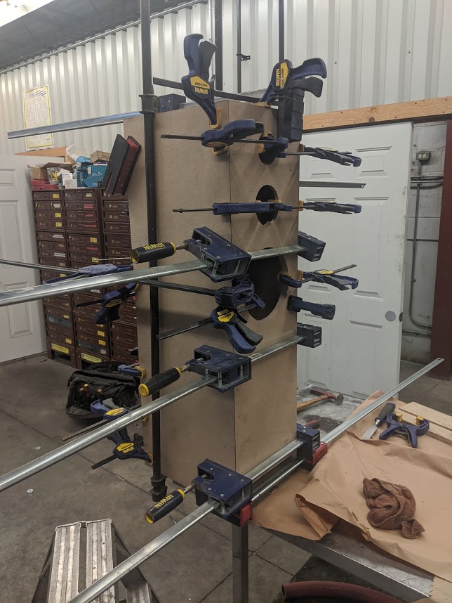

I'll be elbows deep in Bondo and primer on the second cabinet for the day but I hope to get back at the software later today.

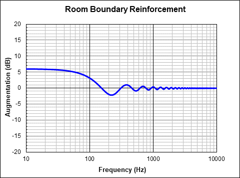

Lots of confusion here for people who haven't understood the method of quasi-anachoic measurement that Jeff Bagby has explained so well in this paper, Box, which I'm going to guess you have read. Just a hunch. 😀
First let's look at floor bounce. Since we're talking about its effect on measurements, we should use those data points in the floor bounce sims. Using your link, I used driver height of 22", mic height of 34.5" and a mic distance of 1m. I get the 1st null at 250Hz. Using Jeff's Diffraction and Boundary Simulator I get the same result, attached below.
Now if we measure the woofer nearfield which will not include the floor bounce effects, its upper end of accuracy will be 4311/7", 7" being the RS225-8's cone diameter. That will be 615Hz. The accuracy of the low end of our farfield measurement of the same driver will be determined by the gating time we choose, where the lower limit is defined by 1/gating time. With a 5ms gate, that will be 200Hz.
So as long as we blend the 2 measurements together between about 300Hz (the top end of the floor bounce null) and 615Hz, the floor null will not be present in the blended response. Problem solved. There is no need to take the speakers outside to measure nor do you need to raise the speaker up off the floor either.
