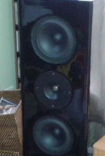

I was originally planning to loose the tweeter face completely and rear mount it closer to the woofer but I don't think she would have liked the appearance.
I don't really trust the manufactures specs either, these are pretty inexpensive so likely tolerances aren't very tight in production. I'll be taking proper measurements with some guidance from the forum once I have drivers in the cabinets and have a chance to break them in.
I thought of that too. I was originally planning to mount the woofers in the wood front baffles (spaced forward) and have the aluminum front as a bolt on grill that covered the edges of the drivers hiding all the fasteners, but dropped that idea with the rear mounted tweeter.
The tweeter design kind of sucks mechanically. The wire connections stick way out into the mounting surface so by the time clearance is added for the wire connections there isn't a lot of sealing surface left. I realize the tweeter is a sealed unit but it mounts in the midrange cavity and may have leakage issues.
Not entirely analogous, but ... when I replace a tweeter (which I've done far too often for people who keep saying: "I'm sorry, what did you say" 🙂 ) I will cut a small neoprene gasket that sits between the tweeter surround and the cabinet. I don't know how much difference it really makes but it does seem to make sense.
A serving suggestion.
