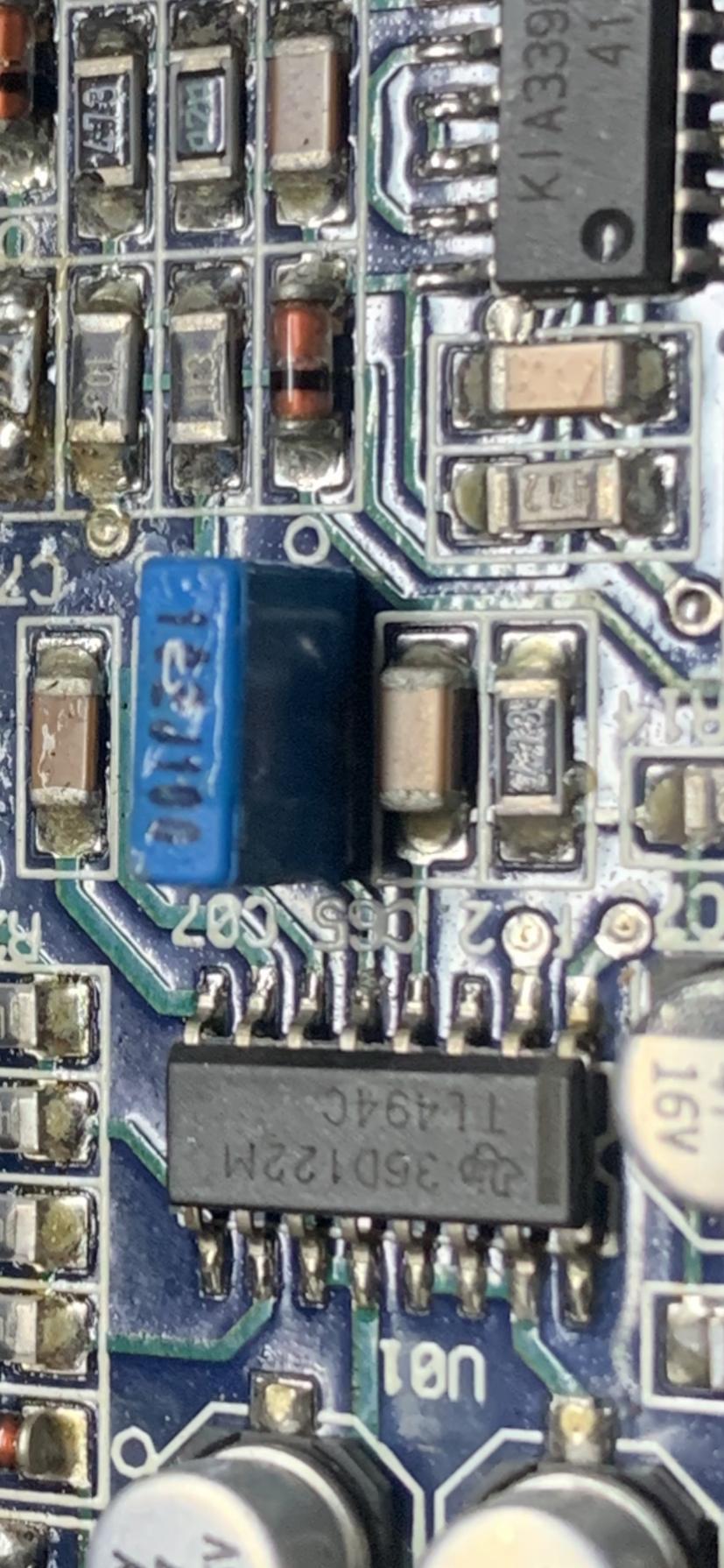

Arite,
I pulled each component for the gate drivers and they checked good.

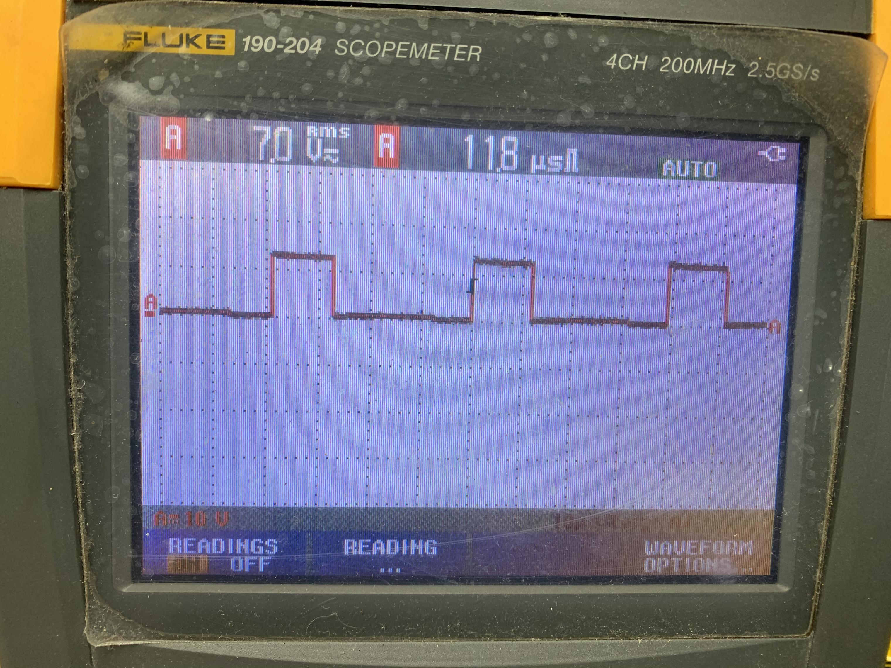

Attached is the drive signal on pins 9 and 10 of the 494. (Pins lifted).

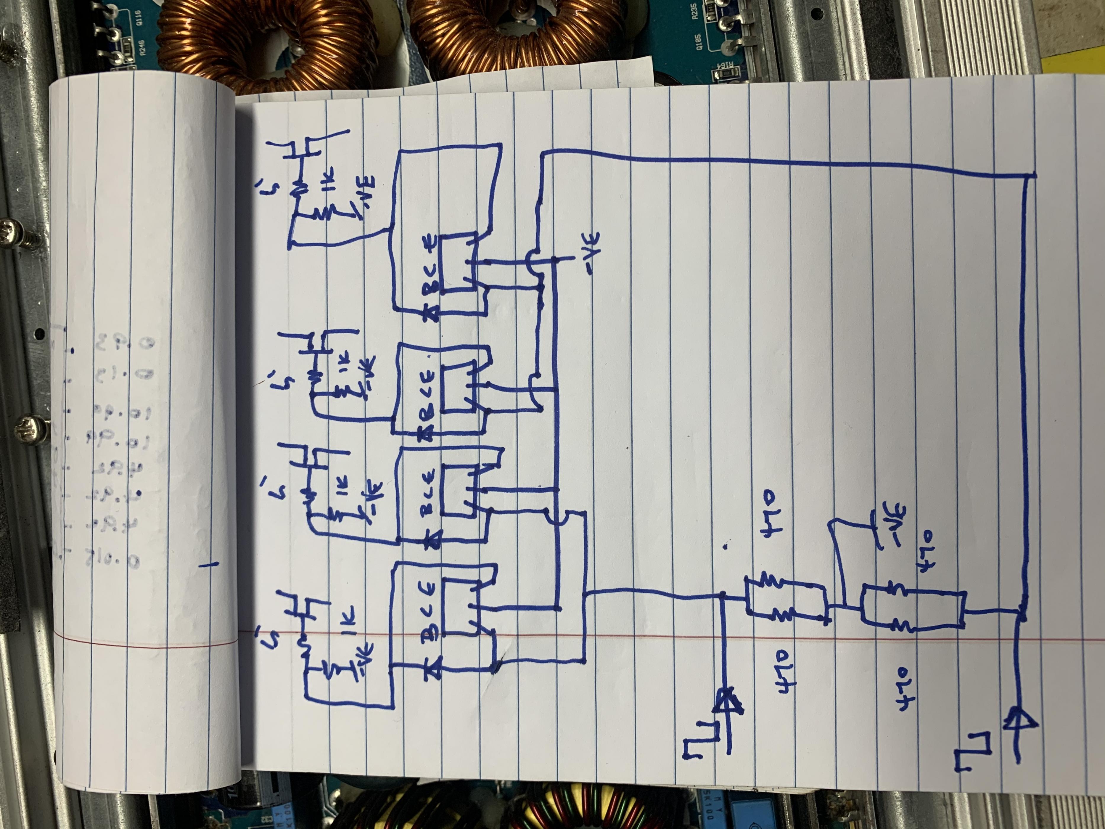

I’ve also taken a close up of the components and drew a quick sketch to try to figure out why this is not working. Seems this is not the traditional EF pair.
The diodes will be 1N4148/1ss355 types (SMD versions). Don't replace them unless you have to.
For the transistors, I'd likely use a 2SB1260.
Without the voltage on all of those terminals, I'm working blind.

Terminal 4 is very high. Also, it appears that there is some signal on terminals 9 and 10. Set the scope to 5v/div and 10uS and re-check.

I had the scope across the gate on the PS FETs.
I pulled this transistor and powered up, it pulled the voltage on the power supply down to 7v and the amps went up to 13.4a.
I didn’t try Audio. After a minute or so when I saw the current draw was up to 13a and the colts dropped to 6v I shut off.
