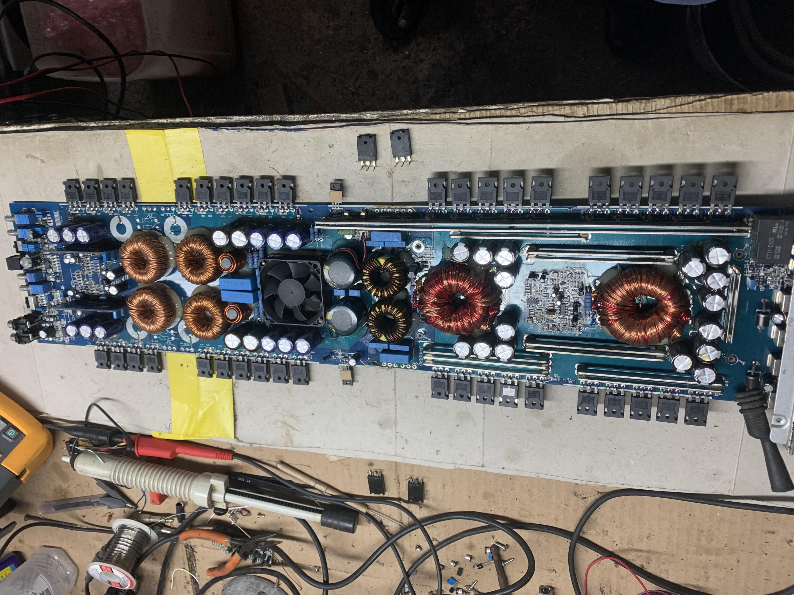

Arite, I removed the board from the heatsink and powered up without audio.
The amplifier pulled the power supply down again to 7v and the amps went up to 13a.
All PS FETs and output FETs are getting warm. I didn’t keep it powered for long though.

All FETs tested ok, I already tested the rectifiers, but didn’t think to power up with them out the circuit, I read somewhere in the manual, class D may not like this.

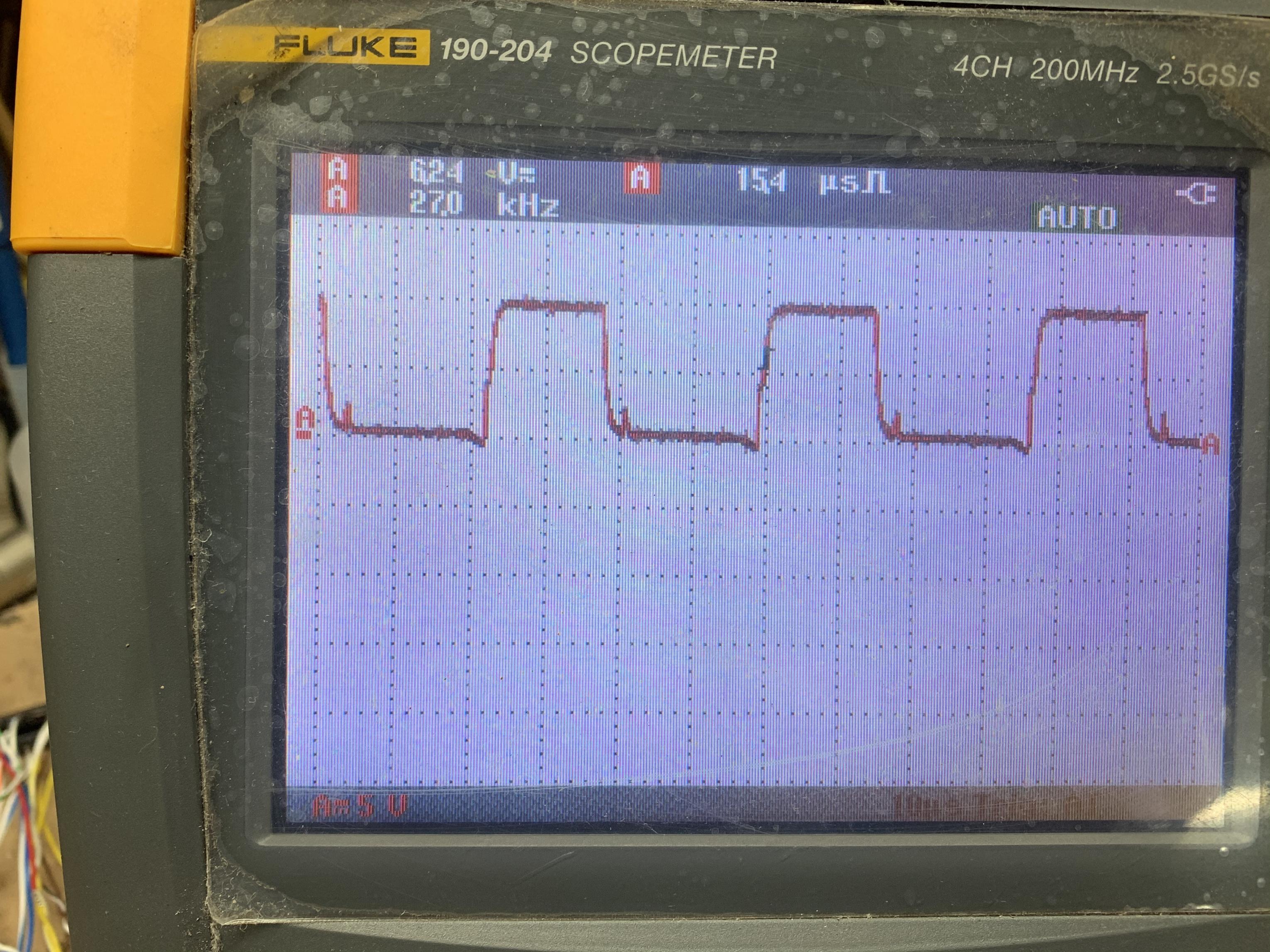

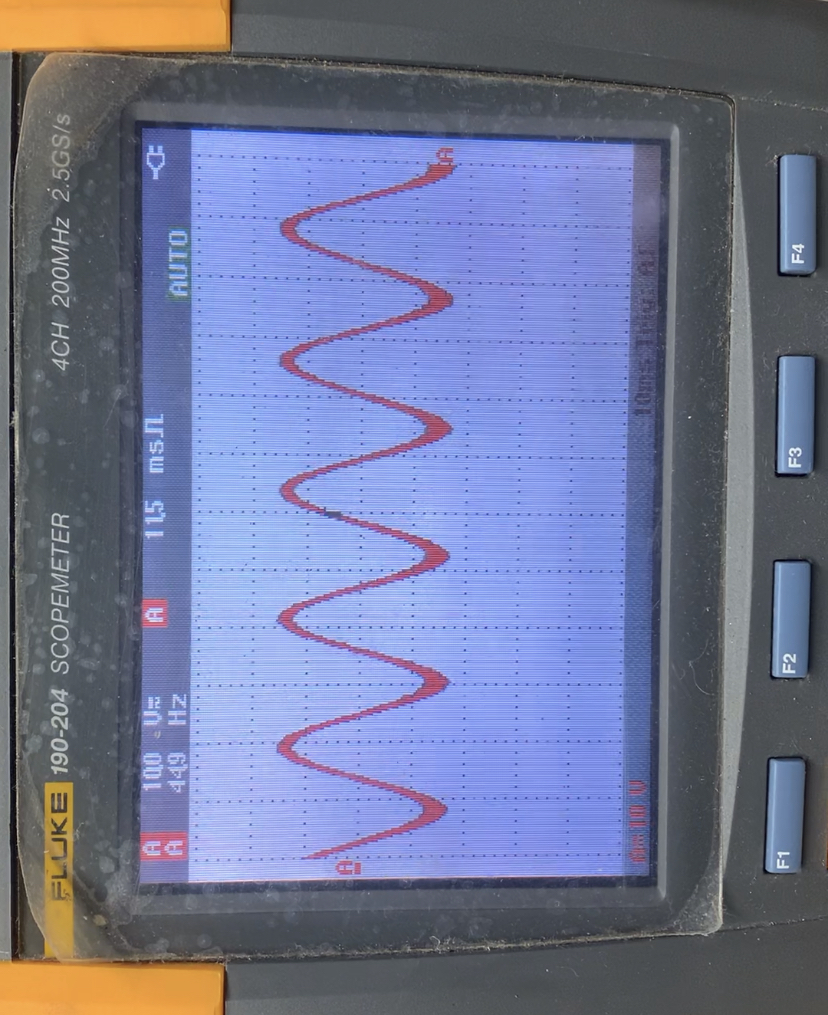

Anyways I removed the Rectifiers and powered up. Attached is a pic of the gate drive. ( I still have the transistor removed)
I have 40v ac on either side of the board where the two sets of rectifiers were.

You can't fully troubleshoot with no rail voltage for some class D amps. Unless I'm forgetting something, I can't remember it being harmful in any way.
If the problem is in the audio circuit and no semiconductors are heating up, you may have a defective rail cap.

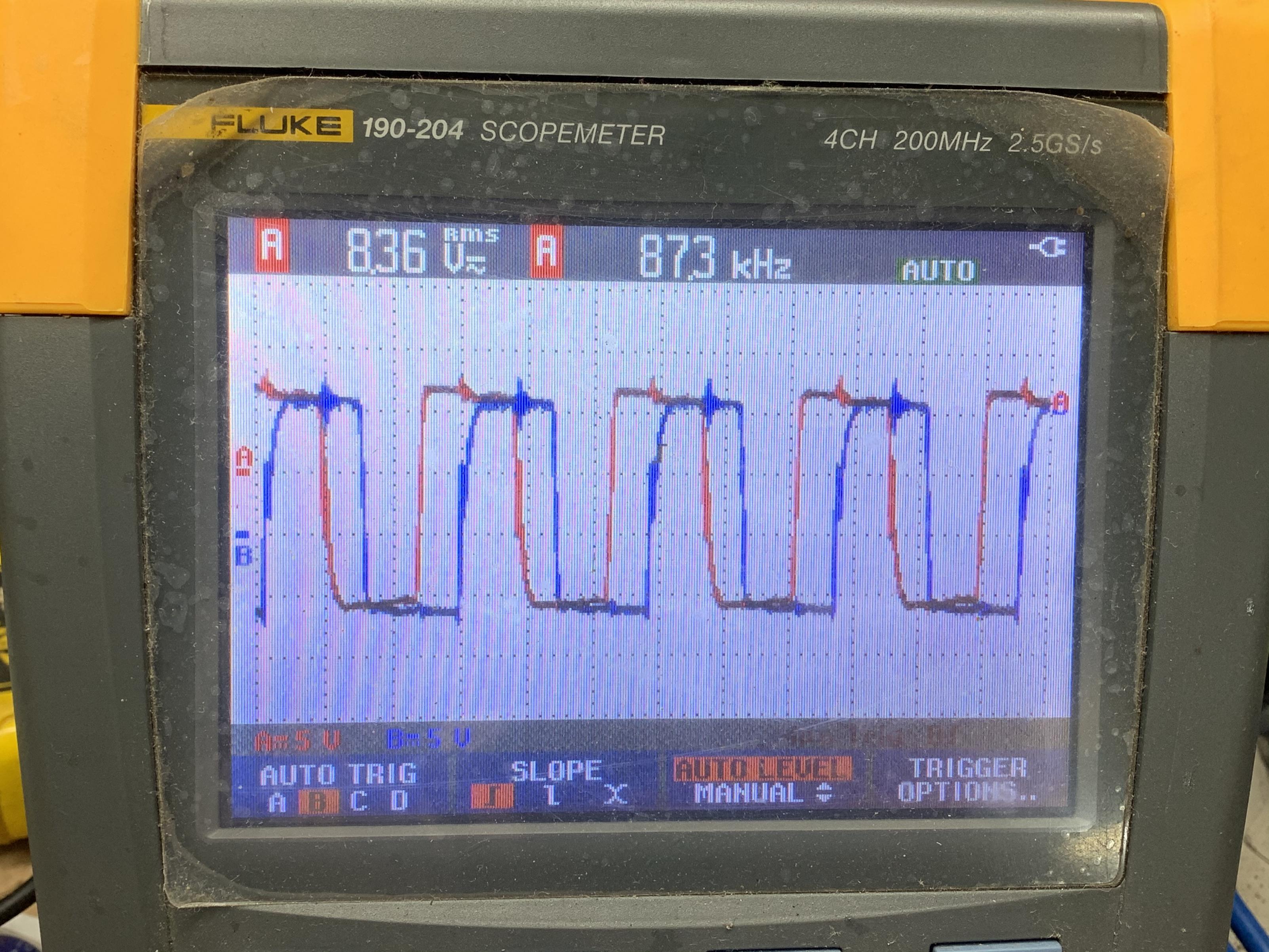

The first waveform is the gate drive on the PS.

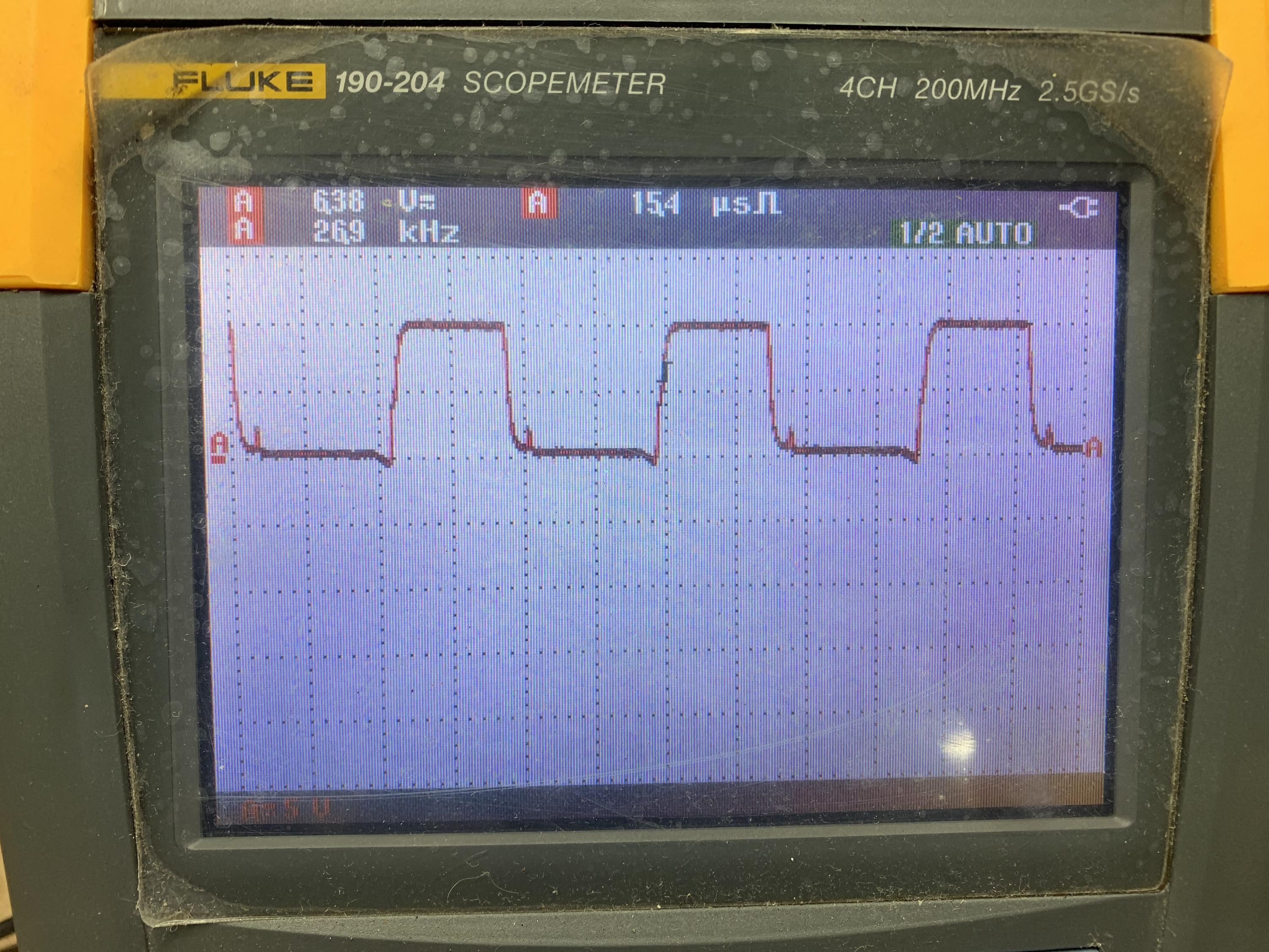

The second on the p-FETs,

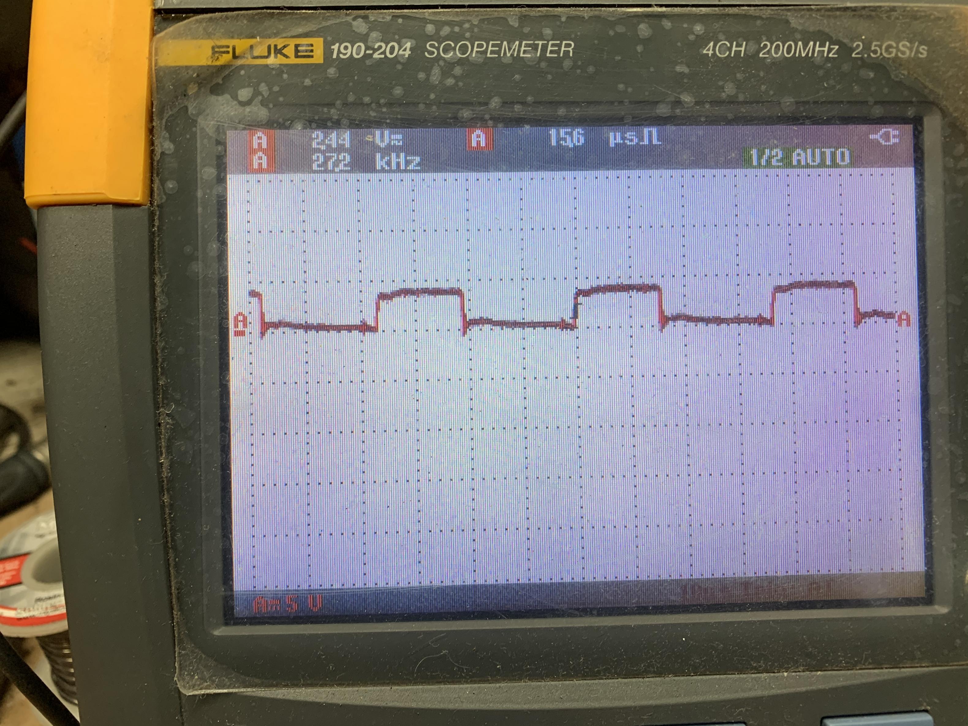

The third on the n-FETs.

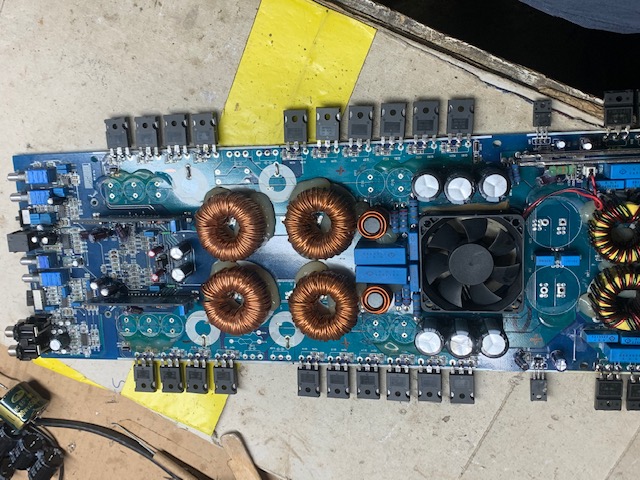

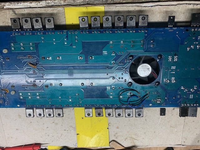

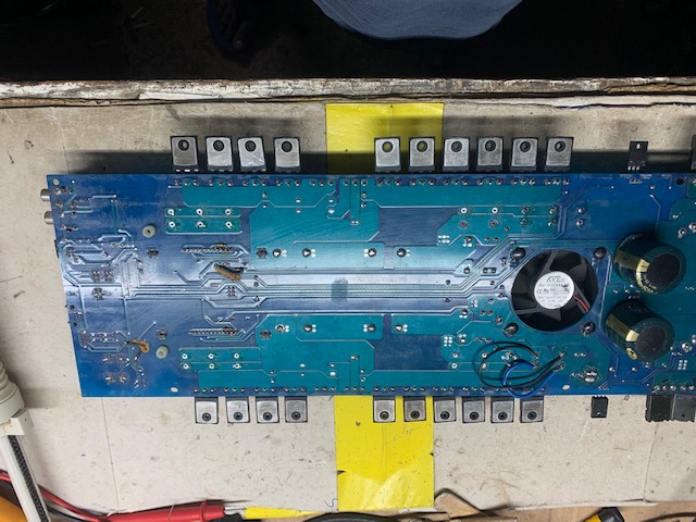

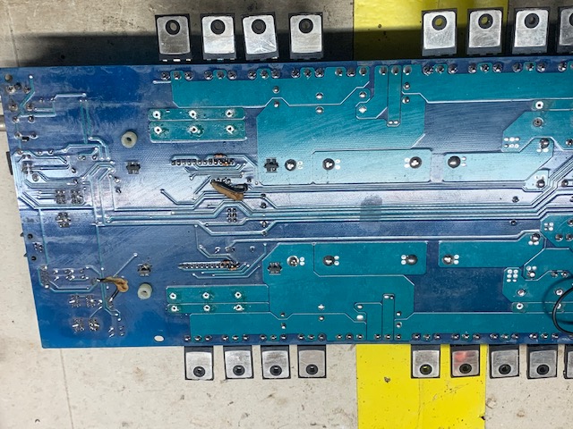

I did a bit more this afternoon as time permitted, I installed one cap at a time and powered up.
I noticed the amp goes into protect when I install a cap or a group of caps on the negative rail that connects to the N- channel FETs.
I wired in external rail caps and wires to these caps as the double sided circuit board has opposing voltages from top to bottom, and I wanted to eliminate this from the troubleshooting (solder bridges).
Presently the amp powers up fine with all caps (replacement caps wired externally) except for these two banks of caps on the N-FETs. I've tried various caps, new, old, varied the value a bit, but the amp seems not to like these in.
I traced the PCB, the negative voltage rail, connects directly to the source of the N-FET and the negative of the cap. The positive of the cap connects to the common on the power supply (common point between the rail caps).

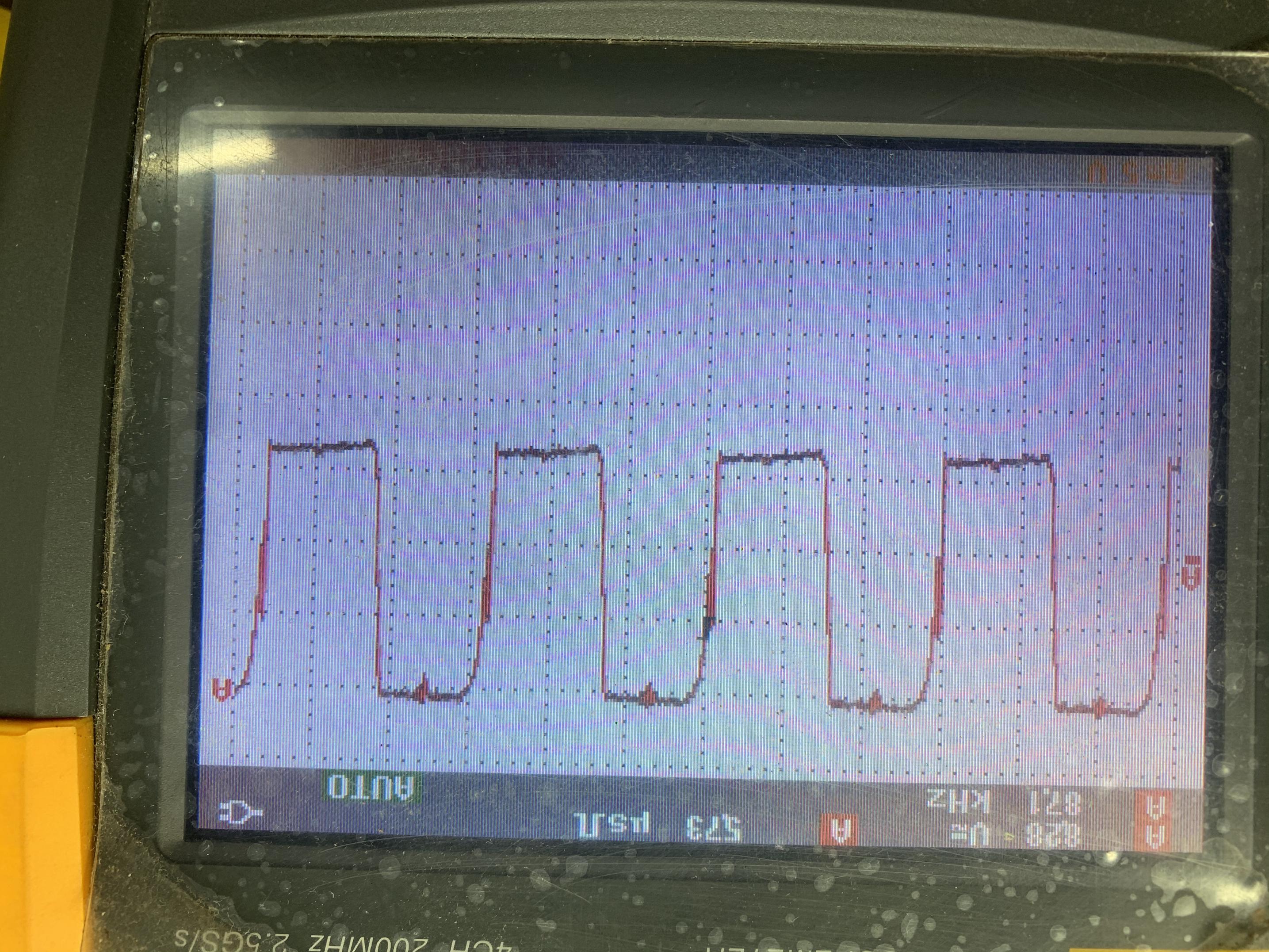

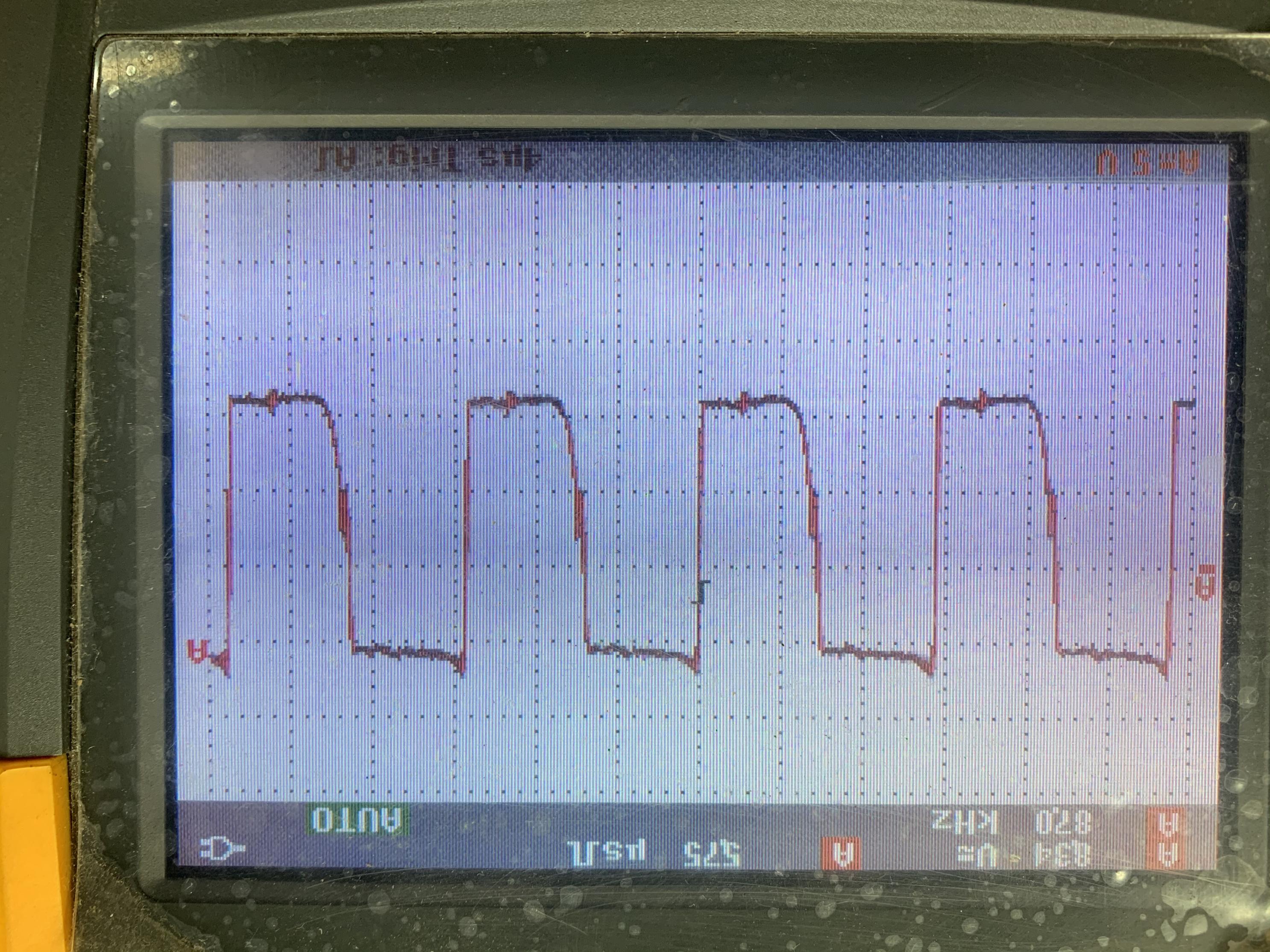

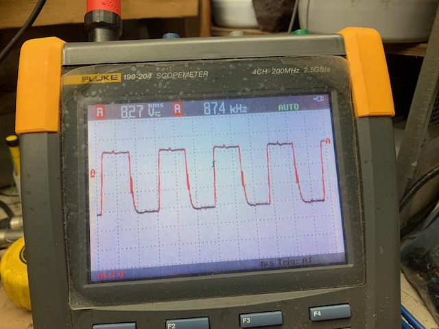

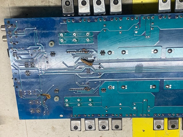

I've attached a couple of pics of the gate waveforms for both banks of N-FETs, when the amp is up and running without these N-FET caps, and both sides of the PCB.
Anyone ever experienced this and/or has an explanation for this?

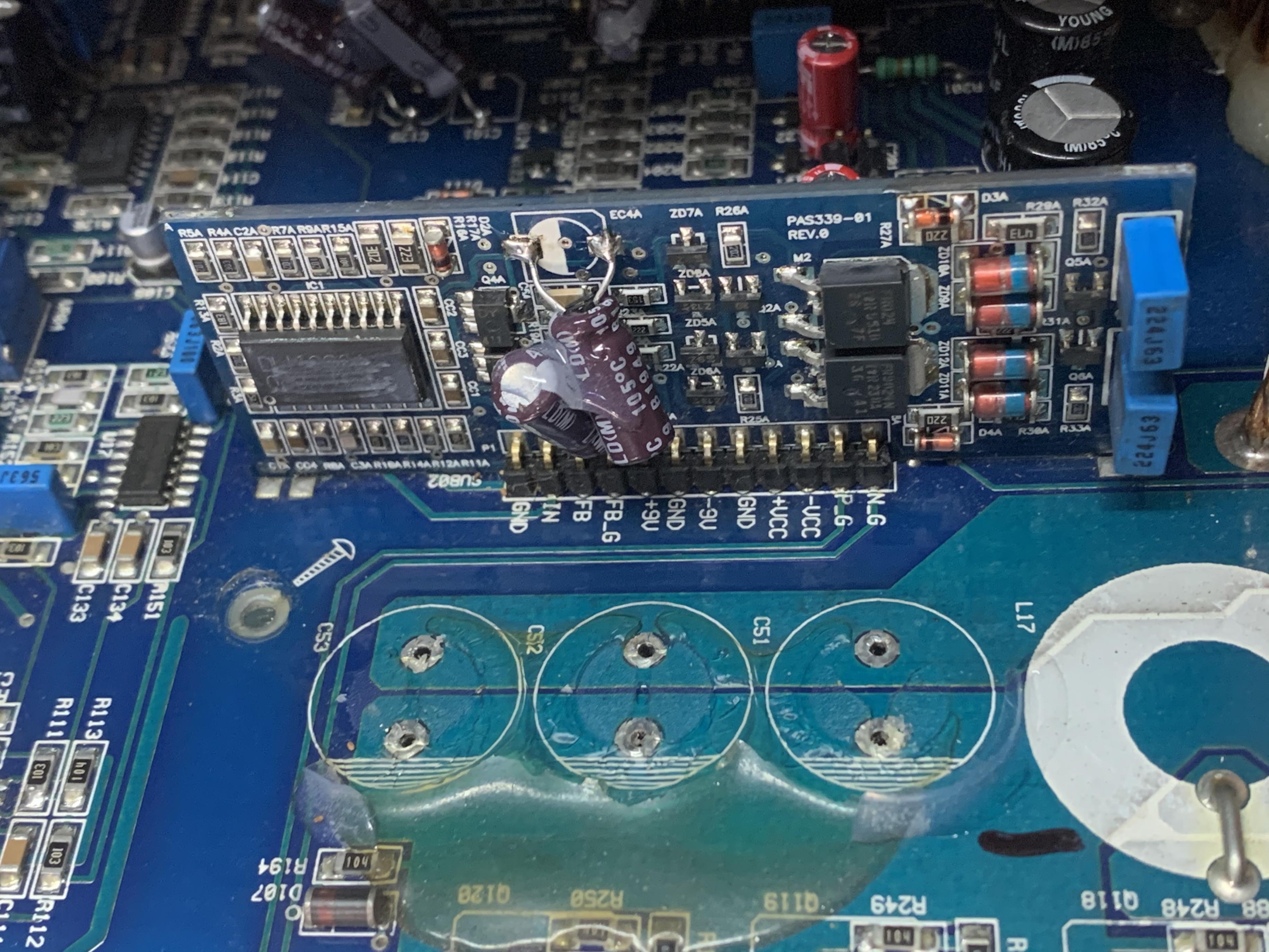

I remember a similar problem that I had with an amp using driver boards similar to these.
When the rail caps were not fully charged, the amp would draw excessive current and would not start.
Do both driver boards start to produce drive signals immediately? Is either delayed?
Post a photo of the pin designations on the top of the main board for the driver board.
I would say both driver boards start at the same time, my scope takes a second or two to lock onto the signal.
The amp when remote applied, does the protect led for one second and then switches over to power on (I believe this to be normal for an amp this size).
You don't have to wait for the scope to lock onto the signal. Set it to 2ms and simply notice when the signal on the output filter caps (input side) goes from a straight line to a rail-rail signal.
