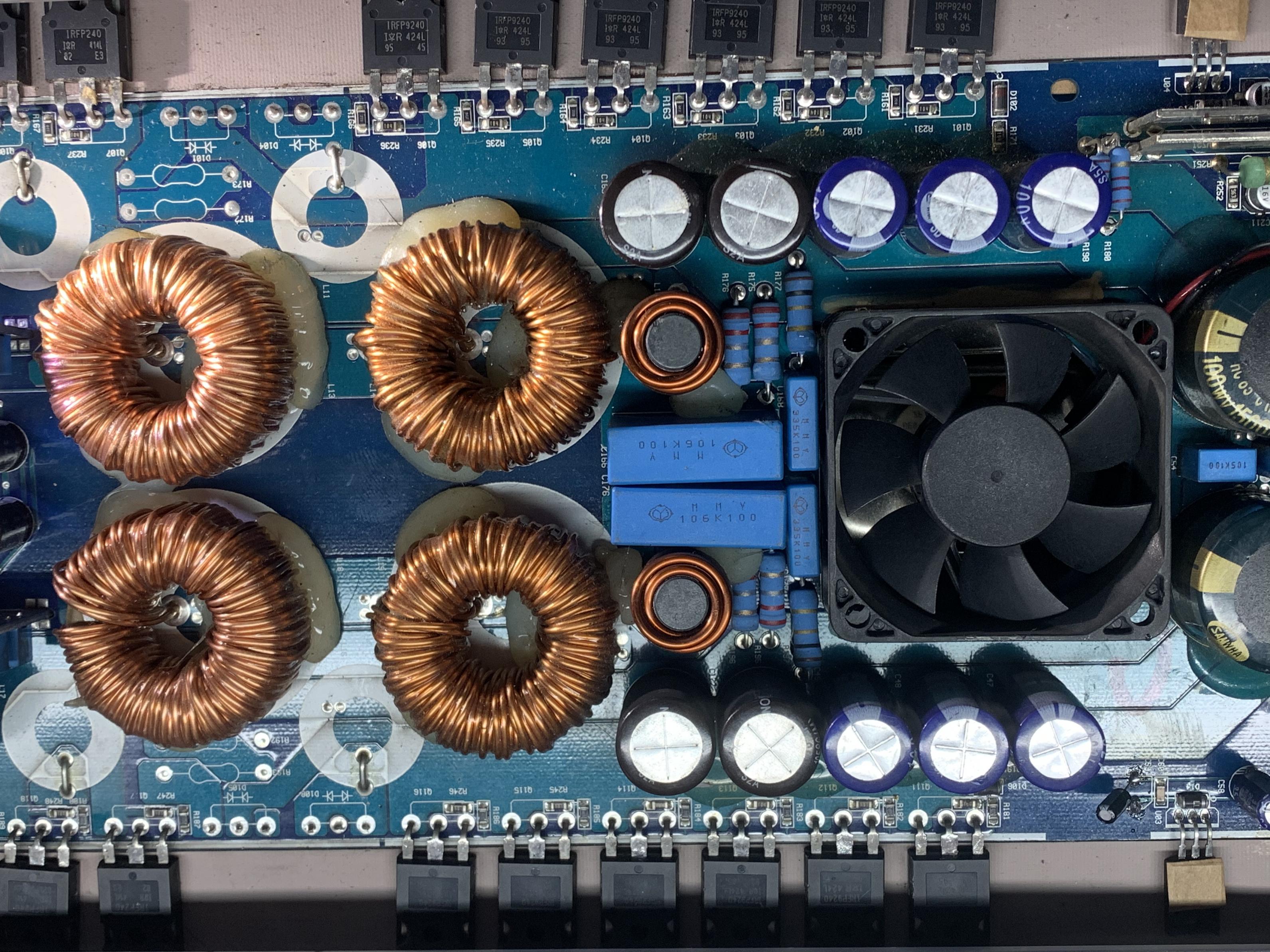

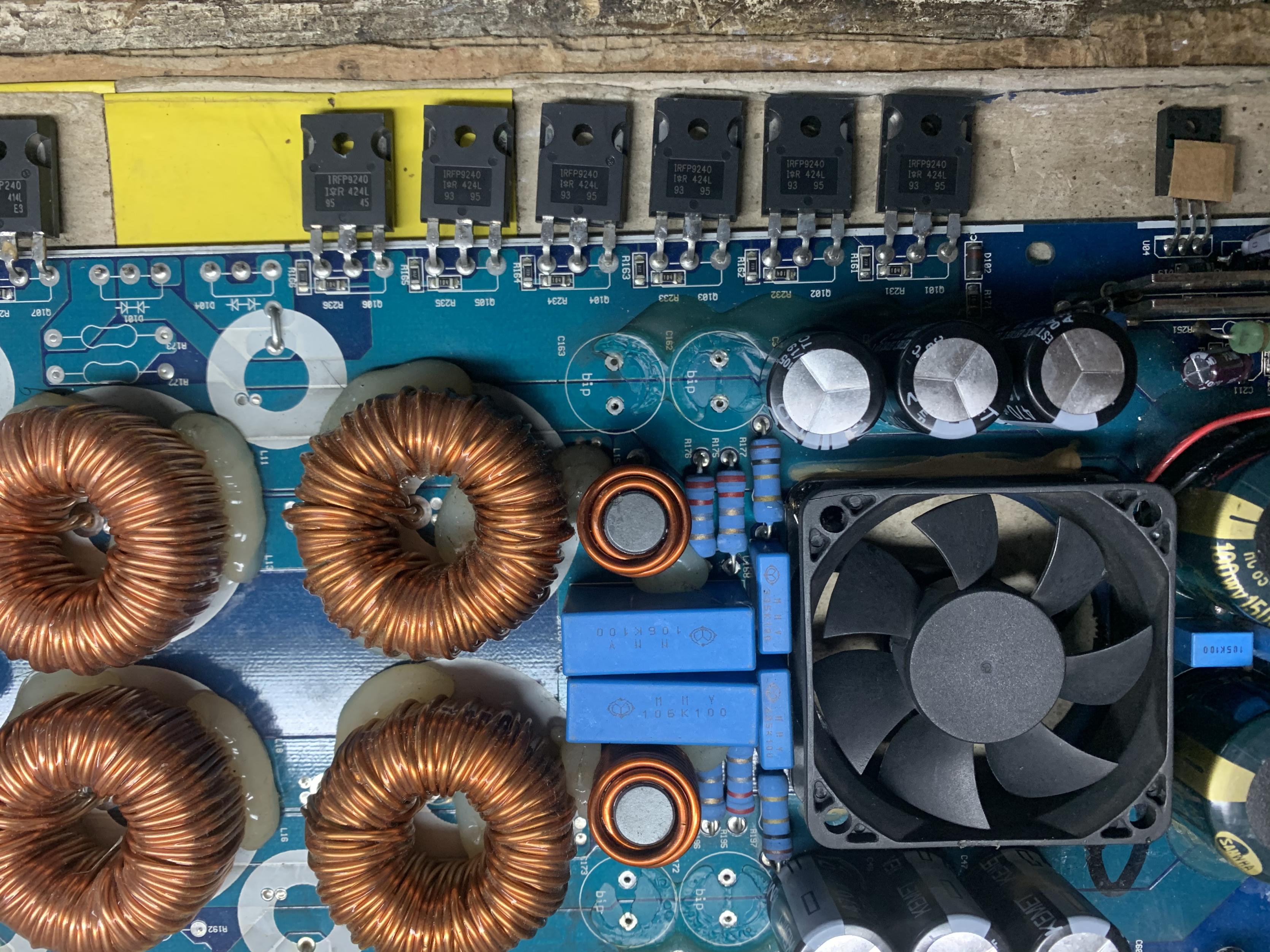

I need the event timing, not the waveform. I first need you to tell me if the r-r oscillation starts immediately (precisely when the PS starts to oscillate) or after a short delay.
I don't know if there will be a fix for this or if there is even a problem. The amp may start normally in a vehicle installation with proper wiring and a good battery.
Correct,

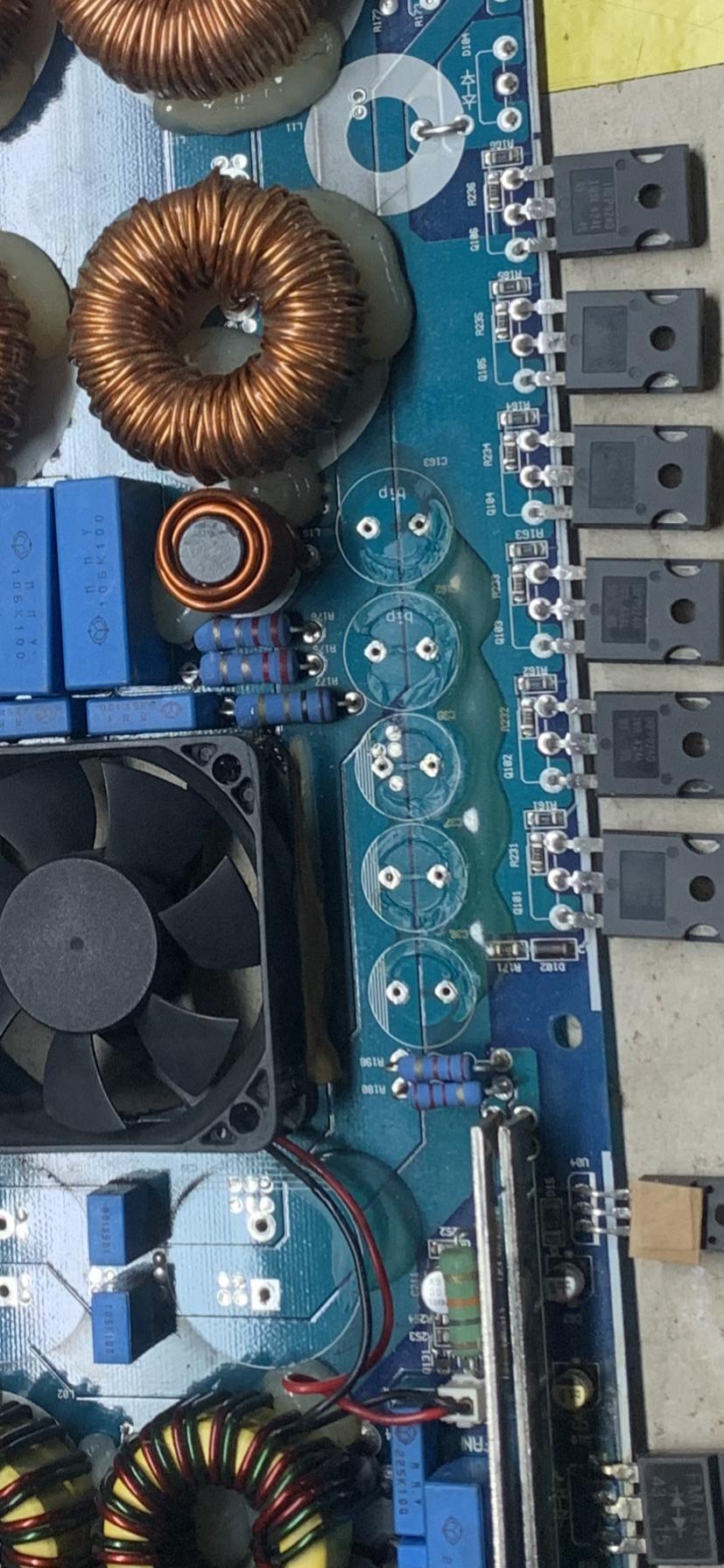

There are four bipolar caps, one terminal connects to the positive rail and the other terminal connects to the negative rail.
In the third pic, you can prolly see the traces from the bipolar caps lead to the negative side of where the rail was unsoldered from.

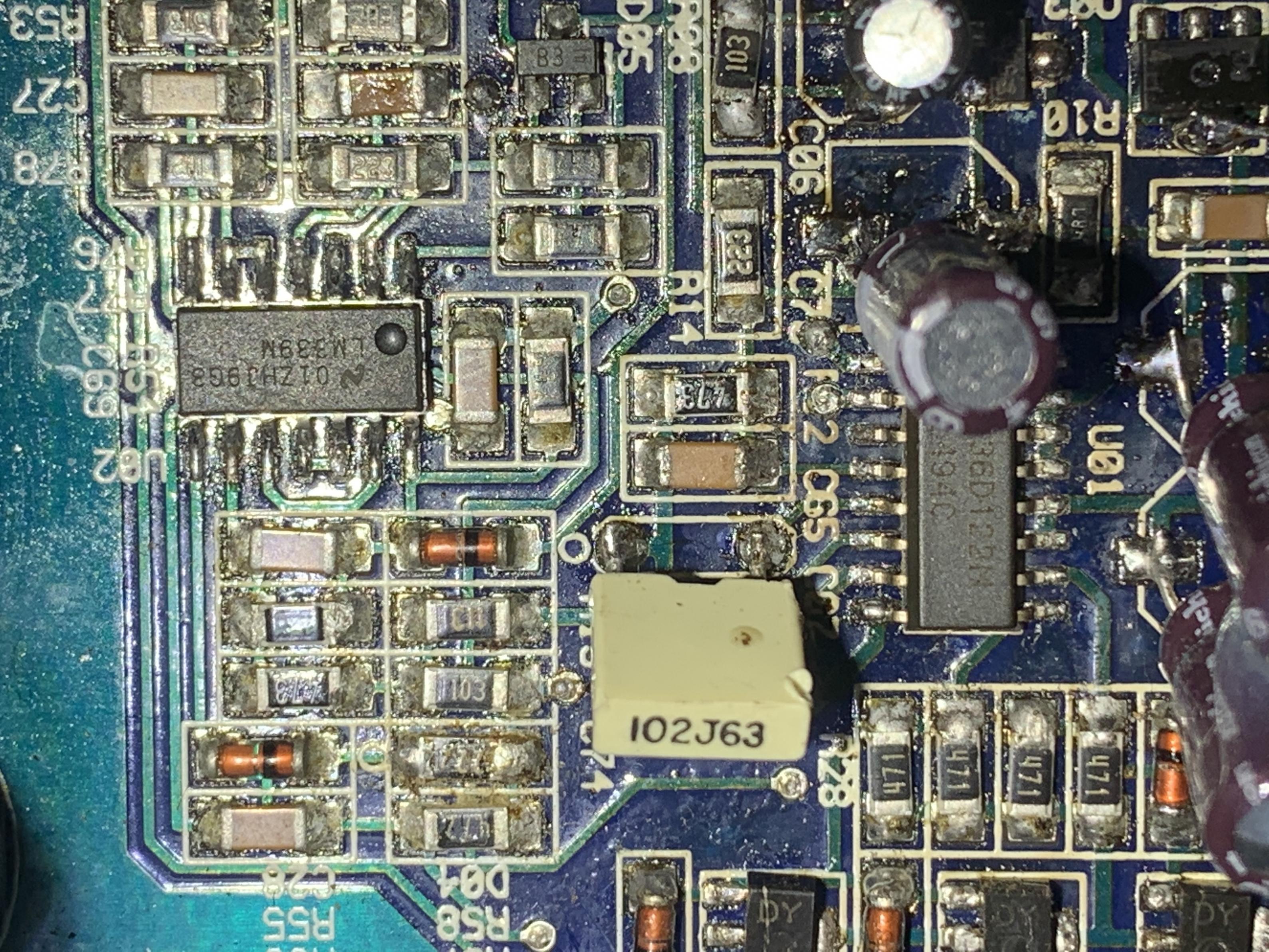

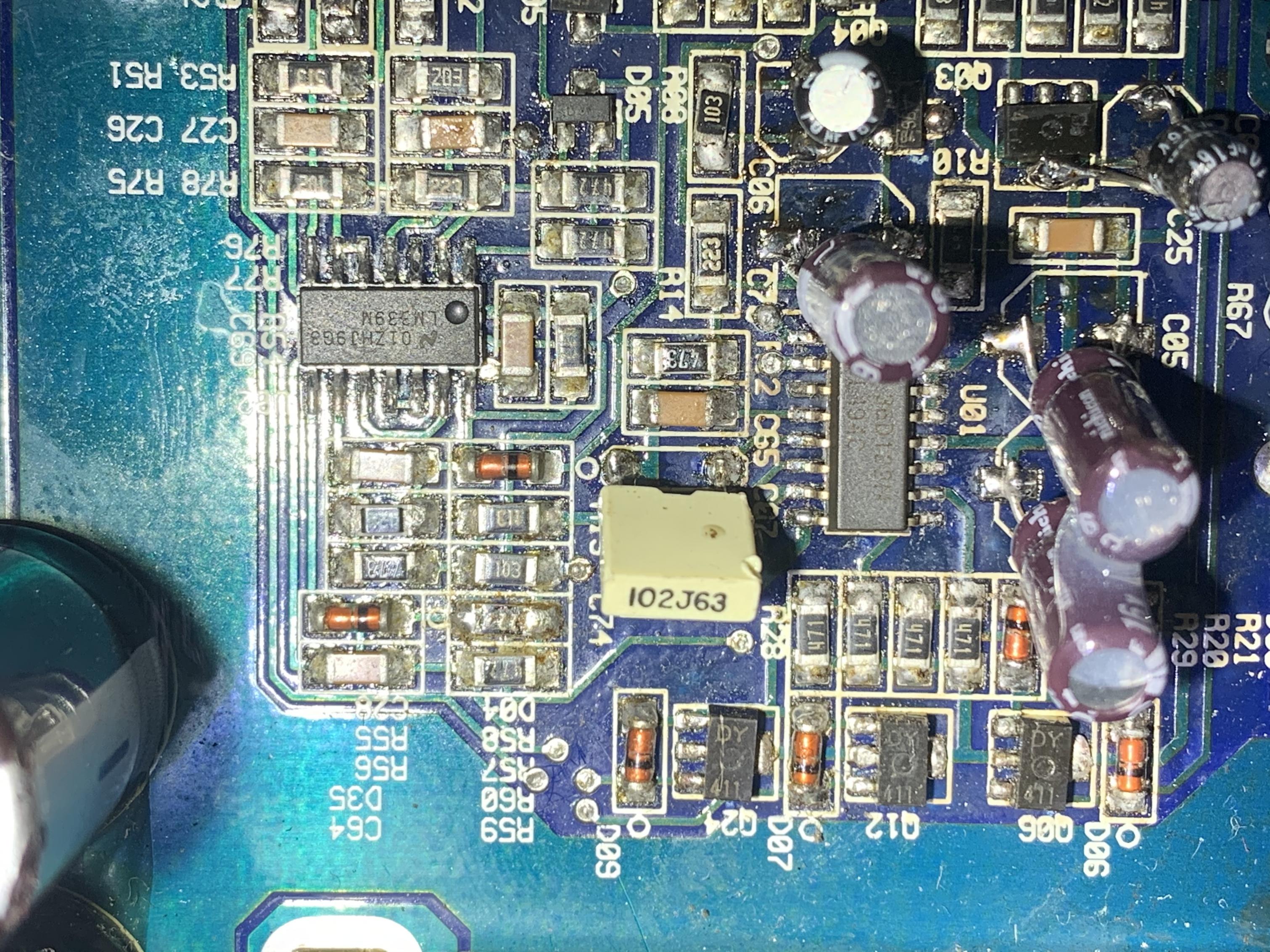

I’m wanting to vary the values of the cap (c05) and resistor (r02) connected to pin 4 and ground of the 494 to try to get a delay on start up.
Do you think this will work?

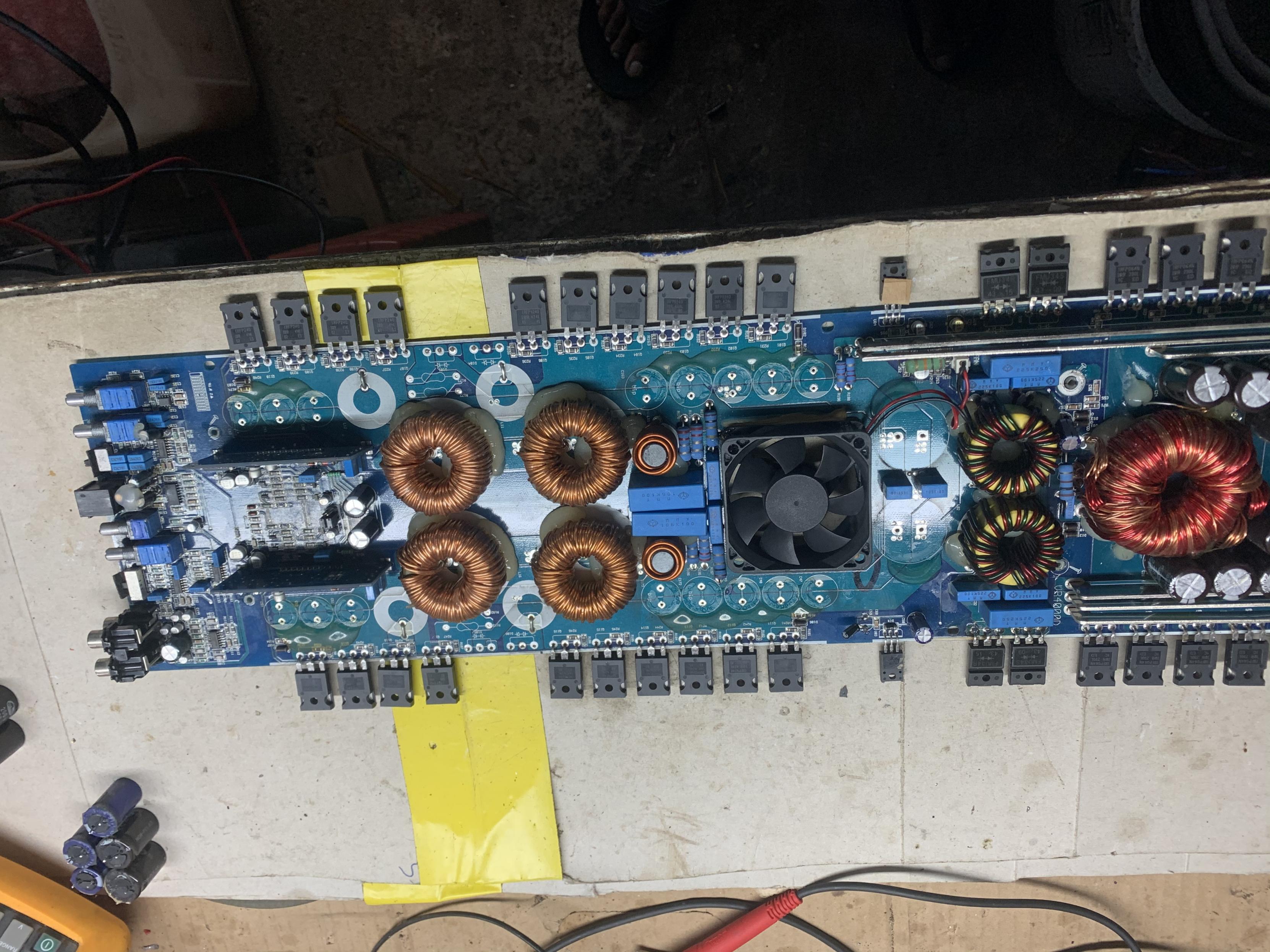

What Vytautas1 has stated is correct, 5/6A idle.
This amplifier's PS and output class D section both start together, without a strong input power supply its gonna take the amplifier into protect almost instantaneously. For this particular amp I was fortunate enough for it to need a recap, without the rail caps the amp would start normally with a 10A power supply.
