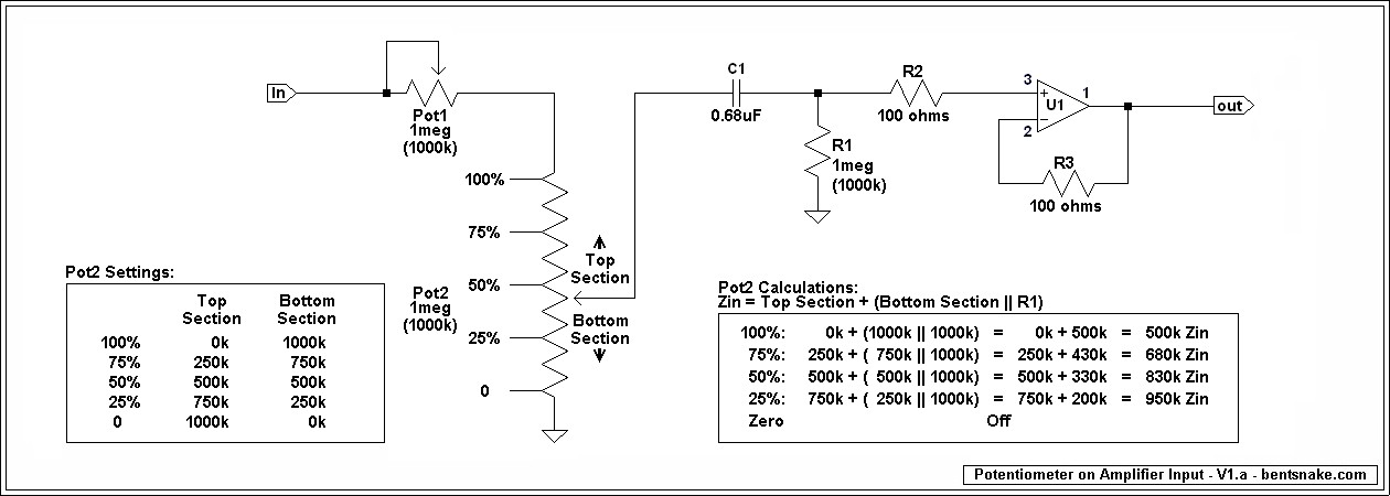

Related to posts #78 and #79, there seems to be disagreement about doing something as simple as hanging a pot off the front end. So I thought I'd show what actually happens.
Zin (input impedance) does increase as volume (input level) is decreased, but this has no practical effect--or if anything it could be considered beneficial.

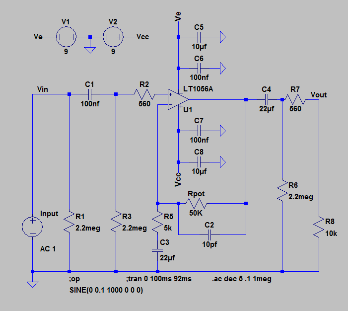

Okay. I tried putting together a stripboard schematic. I've attached it. I also tried implementing the shield-to-opamp-output technique you're describing. I'm not sure if I've done it right.
The thing I wonder is hypothetically if the shield picks up EMI noise and I dump that to the opamp output, aren't I just dumping the EMI noise into my audio signal?
Again, since the guitar cavity is shielded and we're talking just a few inches in each direction, can't I just use unshielded twisted 22 gauge hookup wire and be done with it?
If the attached makes better sense, I can still do that. It's just adding more work.

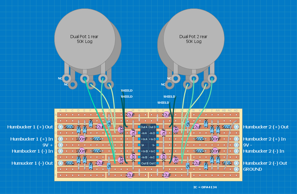

Can anyone proofread my layout? This is the third stripboard layout I've done and by far the most complicated. It looks like more than it is, but keep in mind each of the 4 quadrants are just copies of each other. Did I screw anything up?

Here's just a single channel of the veroboard layout. Anyone care to tell me if I screwed anything up? In particular, I'm wondering if the way I laid out the 10 pF, 50K pot, and 5K resistor all connected through the - input and the feedback loop will work.

The circuits OK although having both R6 and R8 is unnecessary. Make R6 something like 100k and take out R8.
Sorry. R8 is not actually part of the circuit. It was just to simulate the 10k impedance of the soundcard input. Should have removed that. Also just to clarify, you're saying my stripboard layout is good?

Erm... I don't normally do stripboard 😛
Yes, as far as I can see it looks OK.

For each unused op amp, connect its output to its inverting input, and ground the non-inverting input.
Connect the 10pF in the holes right next to the -in/out pins. Keep the pot leads very short.
Cut the unused part of the inverting input strip (past the connections) to minimize strays.
Exchange the positions of the 10uF and 100nF caps, or if possible install them both on the top ground strip.
