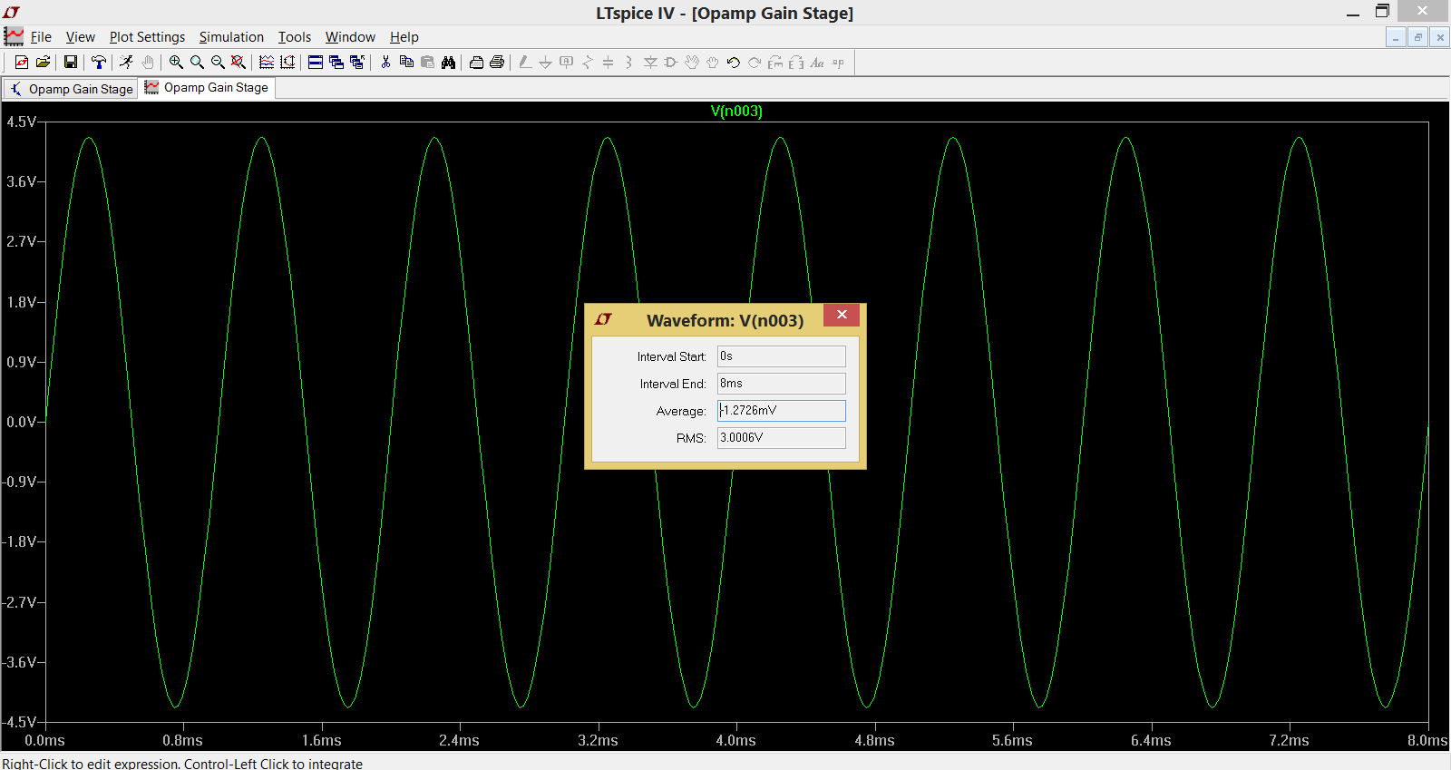

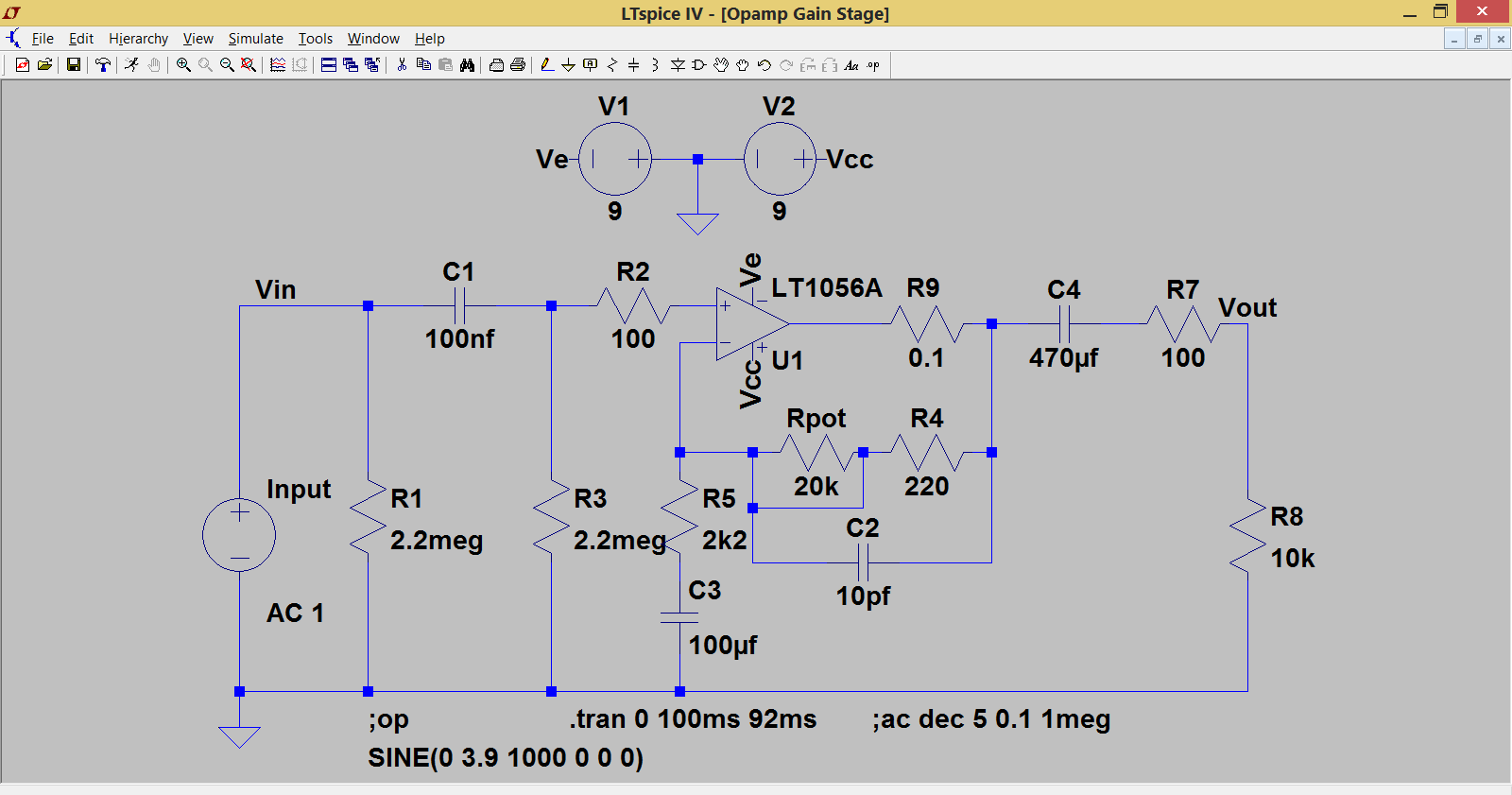

To calculate the load and peak currents we assume that caps C3 and C4 have zero reactance. In other words we assume they are shorted out. That's realistic because we have chosen them to have no effect within the audio pass band.
So we look at the load on the output which is 10k + 100 ohm (10.1k total) and the load presented by the feedback network. The opamp draw essentially no current from the feedback components (its a very high impedance node) and so the load of the feedback network with the pot at zero ohms is 220 ohm + 2k2 (2.42k total).
Those two loads (the 2.42k and 10.1k are effectively in parallel) and so the total load is 1952 ohms.

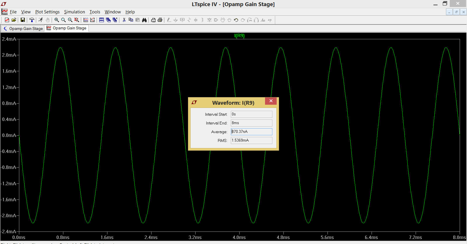

What would the peak opamp output current be. Worst case and assuming the opamp could reach to +9 and -9 volts we get -/+ 4.6milliamps.
The simulation should agree. Lets prove it. I have added a 0.1 ohm resistor to allow measurement of current. The input voltage has been set such that the output is exactly 3 volts RMS (you could use any figures as long as the opamp isn't overdriven).
The current is 1.5369 milliamps RMS.
The load impedance Z is 3/1.5369e-3 which is 1952 ohms. So the simulation and theory agree.
The sim left the caps in place because we know the values chosen have no effect within the audio passband.
That removed resistor does nothing when the interconnect cable is connected at both ends....................... I just re-read your posts and took out that 100K (then 2M2) resistor to ground at the output which was as you said just there for a filter which was redundant................
It's when the interconnect cable is removed, even at one end only, that the resistor does anything.

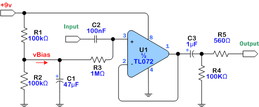

The DC blocking cap isolates any DC in the circuit from the output terminal.
Except that capacitors leak, some leak very badly and others so little it is virtually unmeasurable.
Using a resistor after that DC blocking capacitor diverts most of the leakage current to Audio Ground.
eg.
A DC blocking cap that leaks 1uA when the DC across it is 10V.
Using a 100k resistor will divert most of that leakage to ground and leave the output terminal @ ~ 100mVdc, much better than having 10Vdc at the output terminal.
I generally use 2M2 at input and output DC blocking capacitors.
That probably limits my leakage to less than 10nA, for tolerable DC on the HOT pin of the terminal sockets. This will still "click" if I "hot plug".

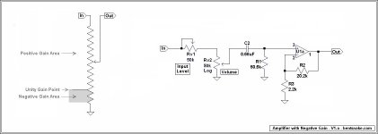

The strength of plan A (pot in NFB loop) is it is possible to prevent overload by turning the pot to right value. Plan B avoids some potential issues as discussed but needs care when choosing gain that is the best compromise between avoiding overload and noise.

While I have metaphorical pen in hand, I wasn't going to say anything, but I've wondered, so I'm going to wonder out loud.
What purpose is served by having an additional gain control? I ask because there's already a gain control--both negative and positive gain--in the form of the volume knob. A "less than unity" area is present in all volume controls all the time. Usually it's of no interest, but it's there.
This might (or might not) be hard to picture at first, so I've tried to illustate it on the left side of the image below. Along with that:
Consider that the least possible output of a circuit (or component) is zero. There can be what we call negative gain, but there's no such thing as a negative output. What we call negative gain is actually an output of less than unity compared to the signal source.
Consider, for instance, a 1 volt signal source feeding a pot (a volume control). Consider that the pot's output is to a buffer, which has unity gain.
At its maximum setting the pot wiper picks up 1 volt and sends it on to the buffer. The buffer output is 1 volt, unity gain.
But at a 50% setting the pot wiper picks up 1/2 volt and sends it on to the buffer. The buffer output is 1/2 volt, which is unity gain for the buffer, but negative gain compared to the signal source.
Now consider an op amp set for a gain of, for instance, 5. Same pot, same 1 volt signal source.
At its 20% setting the pot wiper picks up 1/5th volt, which is sent on to the op amp and amplified 5 times. The op amp outputs 1 volt, unity gain compared to the signal source.
But at any setting below its 20% point the pot wiper picks up less than 1/5th volt, so the output of the up amp is less than 1 volt, negative gain compered to the signal source.
Of course, the "less than unity" area might be too small to be sufficient for a given purpose. Enter the level control shown on the right side of the posted image.
The component values are arbitrary, but in the shown circuit it can be seen that the Rv1 level control at its maximum resistance setting (CCW) effectively halves the effect of volume control Rv2. So in the given example, with a gain of 5, what I'm calling the less than unity area now extends to 40% of Rv1's rotation. Of course these values can be as wished.
So I wondered about the contortions. So wondering out loud.
CORRECTION:
"...So in the given example, with a gain of 5, what I'm calling the less than unity area now extends to 40% of Rv2's rotation..." is of course what I meant to say. Rv2, not Rv1.
I would try to explain rationale of using shielded cable for minimizing stray capacitance. Although not particularly relevant in this case since the length is relatively short (3"), simply I would like to share this technic.
There is always certain amount of parasitic capacitance from conductors connected to inverting node of the opmamp to surfaces connected to ground (housing, ground planes, power plains, etc...). Depending on circuit, certain value of this parasitic capacitance can affect stability.
If a component in NFB loop is placed on considerable distance, the lead from inverting node going to that component could add much parasitic capacitance. However if the lead is actually core of a shielded cable (e.g. flexible audio interconnect cable), the shield can electrostatically isolate it from surround if properly connected.
If shield is connected to GND the cable capacitance will actually add a lot of unwanted capacitance to GND. Not a proper way.
But if shield is connected to the output (or R4 in this case if it is low value resistor or short) the cable capacitance will just add to C2 (which is not a problem except in extreme cases) and will practically eliminate capacitive coupling from core to ground. Increased noise resilience is bonus.
