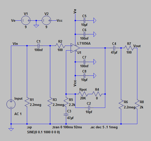

looking at the datasheet, one can see that the 2k loading has a 0.8ppm THD, whereas the 600r loading shows 1.5ppm THD.
That tells us that the amp is capable of driving a 600r load, but is starting to show it is reaching it's "comfortable" limit.
The 1k in the feedback and the 2k+220r as non reactive loads, adds up to 689r for total loading on the opamp.
I consider that too low to be "comfortable".
Add on some parasitic capacitances and the opamp will distort more.
Raising the NFB resistance values slightly will help a lot.
Try R5=R4=2k, Rpot=20k, R3=220k, R6=2M2, C1=470nF, C4=47uF, C2=open circuit, or <=33pF

Using the original values have you looked at what the peak currents from the opamp actually are, even with a 2k load and 1k feedback networks (pot at zero ohms). Its under -/+8ma, well within the capability of the device.
One real issue with the TL0 series opamps is that are not the best at swinging close to the rails under load when the rails are low to begin with... that is nothing to do with coming close to its peak output current, its just a characteristic of the device. The OPA134/2134 is much better in that regard.

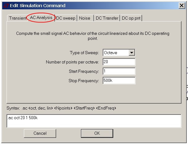

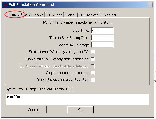

Very good idea, since you obviously want to know what the heck's going on in there. Look on YouTube, lots of LTspice videos there.
Preliminary Tips: the toolbar is seldom used, most of the action is in the F keys, and in the right-click menu.
And, of course, the R (resistor), C (capacitor), and G (ground) keys.
Ctrl + R rotates a component.
...see if I can get that ltspice thing working...
There's nothing "right" about these settings, only that they'll get you up and running. Right-click ~> Edit Simulation Cmd.
You have to provide settings for each circuit, but usually I save-as an existing circuit, which saves redoing the setup.

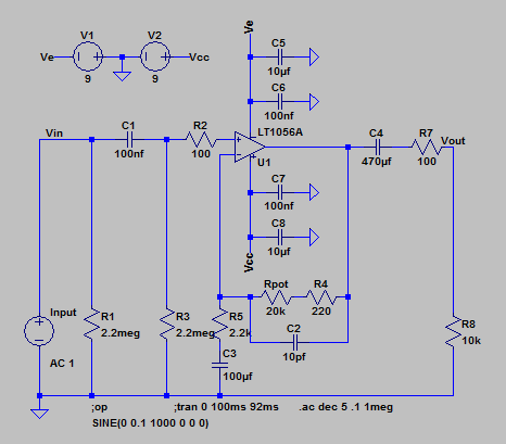

I've made a smattering of changes. I dig LT Spice. Very easy for drawing/editing schematics. Thanks for getting me initiated into that.
I attached what I have now (including decoupling caps). If it matters, the 9V+/- power will be travelling ~15 feet (through a 13 pin guitar cable) from the PSU to the buffer/amplifier board and these caps.

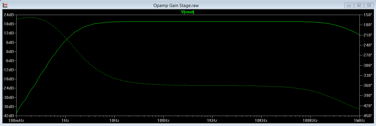

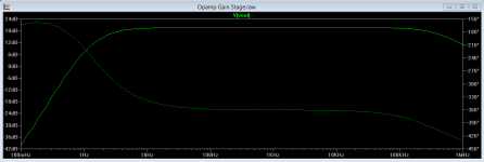

Simulation shows it with flat frequency response. Is there any way to check the distortion characteristics? I know it won't be exactly accurate since this is an LT opamp (and I'm using a Burr Brown), but still it would be nice to just test crudely that the design works. Same goes for noise floor.
What formula do I use to calculate the total load on the opamp like AndrewT was referencing? I want to make sure it is >2K to minimize distortion.
What is the point of increasing R6 so much (to 2M2)?
Lastly, I'm going into a soundcard with 10K input impedance. Should I change R8 to 10K then for accurate simulation?
Also thanks for pointing out I need R4 at 0 ohms (ie. removed) to enable 0 dB gain. Silly oversight. Fixed. Or would it be better for any reason to make R4 a negligable near zero number like 100 ohms just so there's always something there? I hope the 10 pF will still be fine in there with R4&Rpot at 0 ohms. Simulates fine with both of them at 0 ohms, at least for freq response.

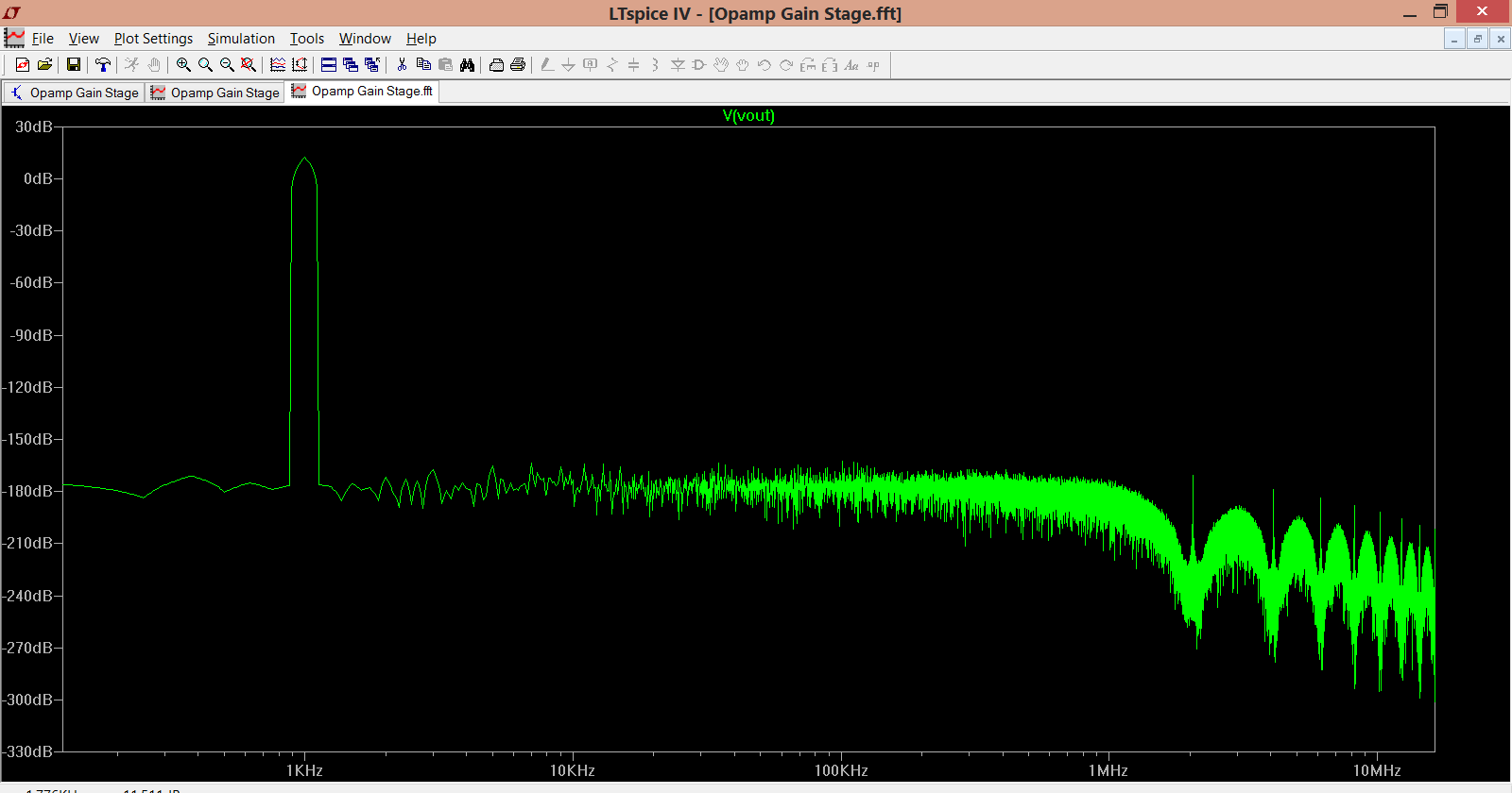

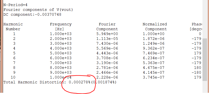

Looks like you are having fun 🙂 We can run a simulation of the distortion but unfortunately it doesn't tell us much simply because the opamp models do not exhibit the behaviour of a 'real' circuit made from all the individual transistors. The opamp models follows all the rules for an opamp and with some of the characteristics of the device chosen such as supply current and bandwidth.
These show the distortion... to good to be true.

The problem is with R4=R5, the minimum gain is 1 + 1 = 2 = 6dB. I want the minimum gain to be 0 dB or close to it. I can set R4 to say 220 ohms though as attached and if that improves stability rather than being 0 ohms in feedback that is fine. Frequency response seems fine that way.

Currently, the schematic plots razor straight frequency from 10 hz to ~80 khz. I'm wondering about the choices of cap size you suggested for C3/C4 though. I get an equally flat response going down to just 47 uF for both. Is it really a benefit using such large ones here?
Your circuit is fine although I'd question C4 at 470uf if you are feeding into a 10k load.

Also thanks for the distortion plot. Can you explain (or link to an explanation) that briefly says how you did that? What about noise floor plots? I imagine that would require entering detailed performance data on all the components like resistors and caps too which would be prohibitive.

Lastly, do you by any chance know how AndrewT calculated the total load on the opamp to be 289 ohms in #21? That would be useful formula for me right now just to see where I'm at...
The output pin feeds into the feedback and into the load.
These are both loads and are effectively in parallel.
Any cable parasitics are also in parallel.
1k for the NFB parallel to the series pair of 220r & 2k is calculated using the parallel resistor formula.
1/R = 1/R1 + 1/R2 +1/R... .... +1/Rn
1k||2220 = 689r441

Oh I see. You were calculating based on Mooly's #20.
Okay, so based on my most recent schem #34 (reattached here also), assuming a 10K input impedance of my soundcard input, my calculation is:
Series output: 10K (load) + 100 (R7) = 10100 ohms
In parallel with: A range of 220 ohms (R4) to 20220 ohms (R4+pot)
Gives: A range of 215 ohm to 6733 ohm opamp load
If I'm doing that right, that's a problem, because with the pot down to 0 ohms, my load is way too small (215 ohms). This problem can be solved by increasing the pot back to 100K, R4 to 2.2K, and R5 to 10k. But first I want to make sure I'm calculating this right.
Did I do that right? Also does R5 not figure in somewhere to this load calculation?
