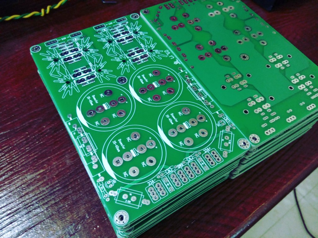

received another 50 CRC boards today.
For those as per above list and also anyone else, Please send me a PM with your name, address, postal code, Paypal address.

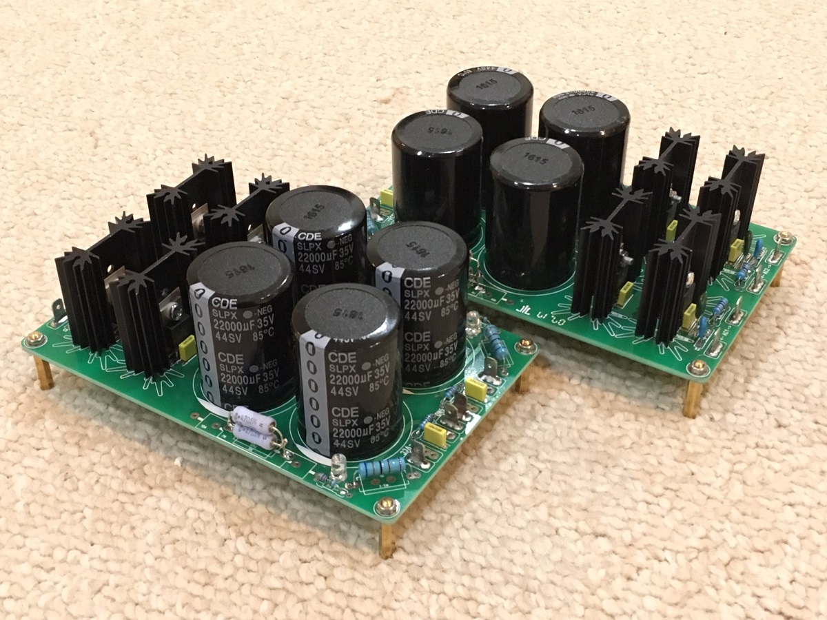

I just built up two more PSU's. This is the second gen layout and it works well. I am using 22mF 35v caps and 2x 0.47R Panasonic 3W metal film. Diodes are all MUR880's from Mouser. I have to say, these PSU's are just as complicated and time consuming to build as an amp. Nice PSU, but sure uses a lot of my stash of film caps!
attachment.php
I will probably use this for my main Class A PSU for various amps from here on out. M2, DLH, F5, Babelfish J, etc...
