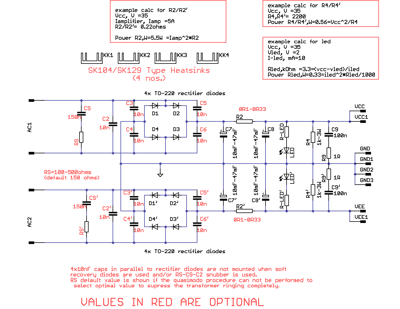

Hi all,
Somebody had suggested (Ades, I think) to make a generalized BoM for this PCB.
Attached is my attempt at the same. Its an excel 2010 document. The first sheet gives the schematic and silk outline. Second sheet gives the generalized BoM and third sheet gives the calculations (example) of power ratings of resistors for given assumed voltages and currents.
However I also should caution on using a generalized bom as it is just meant as a guideline and no absolute values from it to be used unless one assesses his requirements carefully and then selects the components accordingly.
Hope this is useful here to some of the beginners to ease out the component selection process. I would be glad if some one could take some time out and suggest improvements or point out mistakes.
I am also going to put this up on an online store here in India where I intend to sell pcb locally.

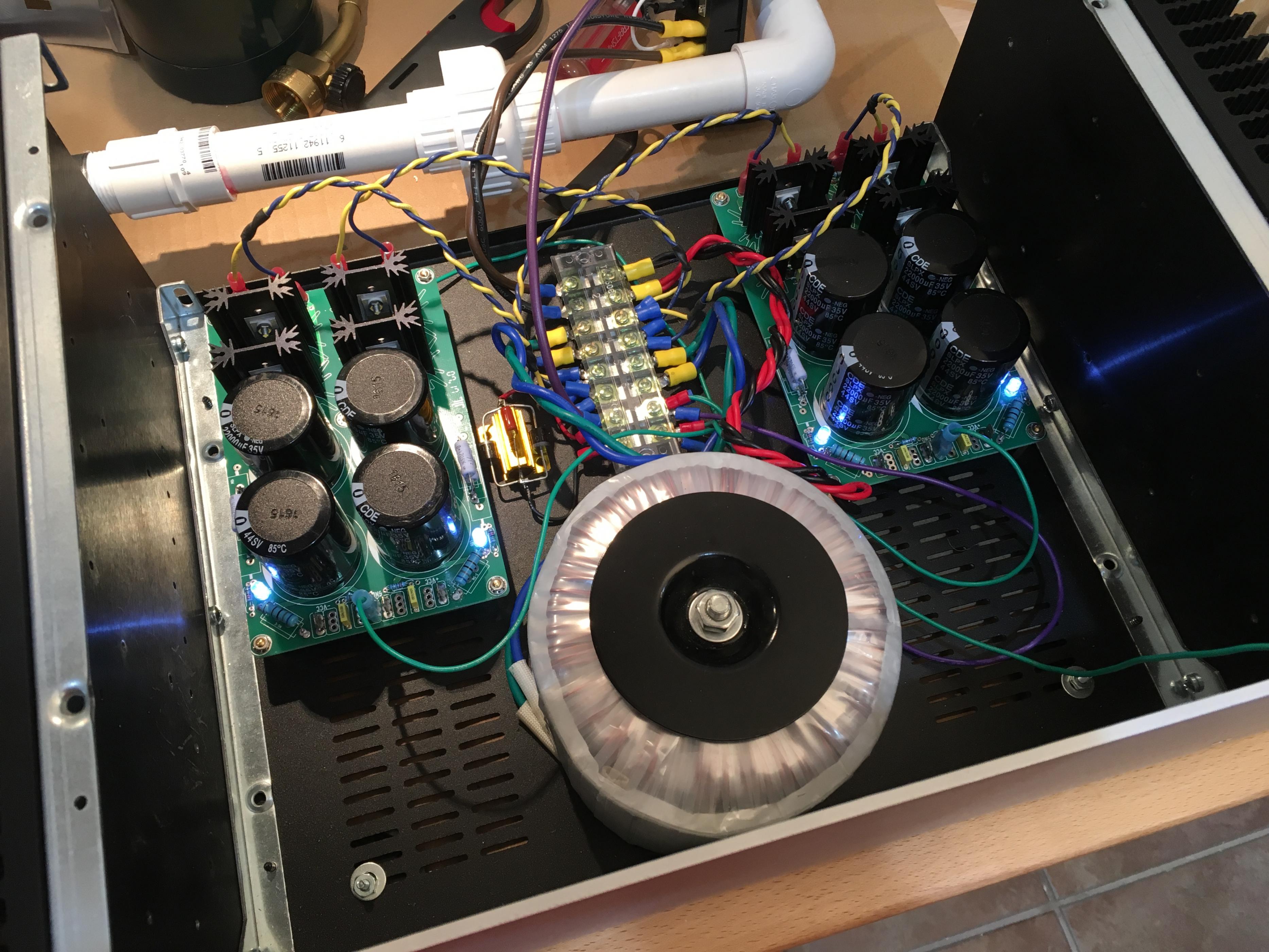

Dual CRC PSU's now in Babelfish J project. With 400VA Antek 18VAC I am getting 1mV ripple no load. Pretty good - let's see what happens when 1.25amps flow. Fits a 3U Dissipante case perfectly.

If you look at my pics above the way I am connecting 2 PSU boards is use a thick wire and solder the ground pins of each of the PSU boards together. Then on the lower board I connect one of the ground pin to the chassis paired with the ground loop breaker circuit. Absolutely no hum issues in this way as both the PSU boards will have only one ground connection to the ground loop breaker and to the chassis.

Schematic of PSU here below.

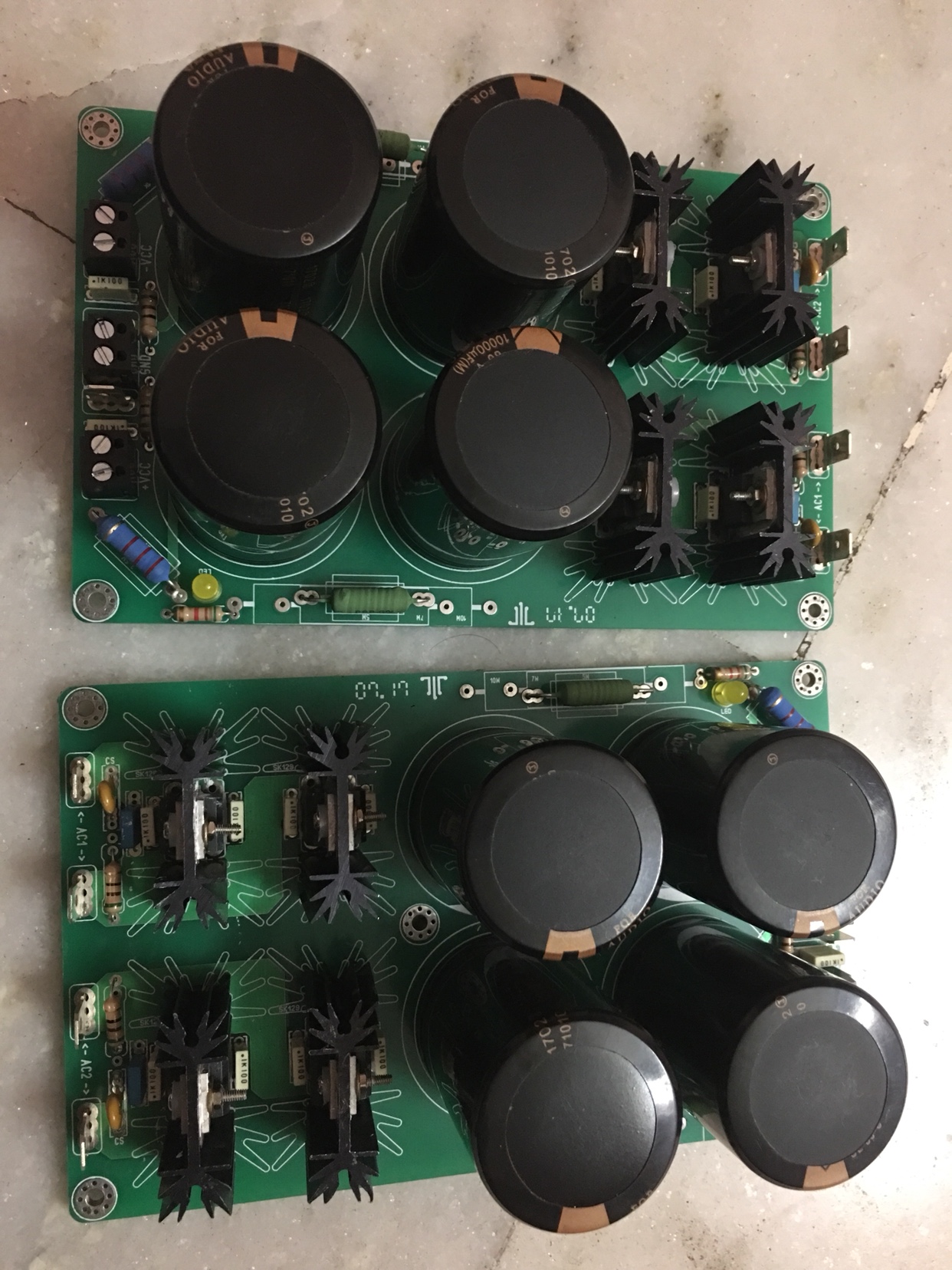

In my case

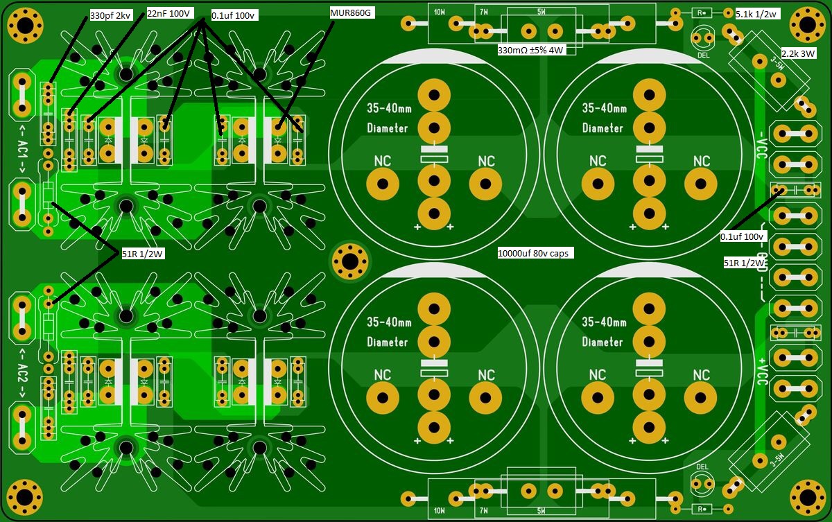

I have built two crc psu with mur860, 10kuf 80v. Snubber caps and resistors.
My transformer ratings are 0-35 8A and 0-35 8A.
When i connected single psu to the transformer it worked fine and the output dc voltages is around 48v
When i connected 2 psu from the single transformer diodes got blown [emoji20]
Have checked the wiring and there is nothing wrong like i pulled 2 wires from dual secondary and given it one input of each psu.

have you tested individual PSU for correct operation with the trafo?
also, is the heatsink isolated from both rectifier diodes?
If the heatsink is not isolated it would have blown on connecting single psu, btw i tested individual module for about 20 mind each to get confirmed nothing wrong before connecting to the amp boards.
If you have four secondaries you can use two sets of those 8 diode rectifiers to create two isolated supplies for two isolated amplifiers.
If you have two secondaries you will find that duplicating the PSU to feed two amplifiers creates a loop with the source's commoned signal return.
