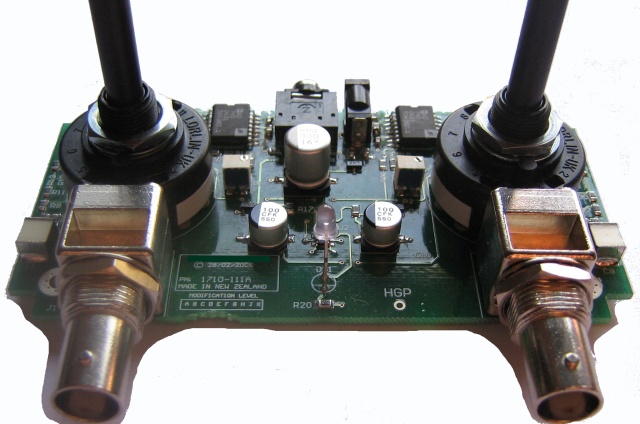

I assume you mean this thread:
http://www.diyaudio.com/forums/tubes-valves/155405-test-measurement-interface-soundcard.html
Link to Mr. Millet's site:
Soundcard Interface
Looks like he is just using a switched resistor divider and small signal clamping diodes? Is the attachment you provided something from here (diya)? I wouldn't want to blow my M-Audio FW Audiophile box up 😀
Soundcard Interface
Soundcard Interface
Yes
No. Just something I whipped up in an idle moment. By which I mean that there are many ways to provide an interface to your sound cardIs the attachment you provided something from here (diya)?
