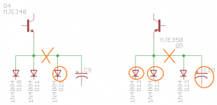

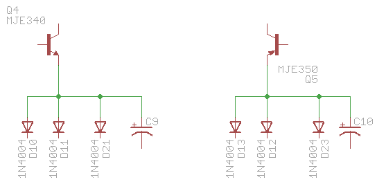

- junction A above is the connection between the emitter of Q4 and the anodes of D10/11?
- junction B is the connection between the emitter of Q5 and D12/13?
- the traces to be cut are the junctions and the 10R are inserted here (one between Q4 emitter and the diodes, the other between Q5 emitter and diodes)?
My apologies. My description had an error & was sloppy. See my version of your drawing. The circled components need to be reversed. The 'X' marks the point where the 10R resistors need to be inserted. D11 and D12 are 4.7V Zener diodes - 1N4732 which you may be able to read on the actual component.

I unbolted the heatsink for the repaired channel tonight as it is easier to see these parts with Q4/Q5 removed in that channel (as well as a couple of the diodes in question).
I cannot find a D21 or D23. C9 and C10 are there (just below the neg. fuseholder, directly above Q4/Q5). The appropriate legs of C9/C10 ohm out to D10/11 and D12/13 top ends.
Since C9 and C10 are directly above the pads for the two transistors, it might be risky drilling holes blind hoping I take out the proper trace, unless I ohm out the base and collector of each to see if it is likely that their traces are routed in the same area (likely, but who knows). Since I don't know what is connected to them, ???
Since I can't find D21 or D23, could I lift the appropriate lead of these and solder the resistor in there? Or are other components also connected to the caps?

I think I could lift the leads of C9/C10 and series the 10R here. Would I also need to add a diode for what you referred to as D21 and D23, and if so, what? From the "schematic" I drew up, I assume these would be in parallel with the caps? I also assume that D21/D23 would not be soldered on the bottom of the board, across the caps (C9/C10)?
Nope, I think you need to trace out the connections on one side. Work out what is connected (and where) to the base and emitter of Q4 and in/out of U5. Then i can figure out what the changes are. I think the difference is the addition of current limiting. Which would make sense.
