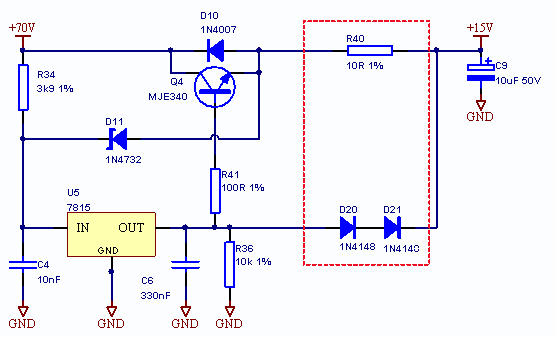

D10 goes from the emitter to the collector. R34 is in series with V+ to the regulator. The collector of Q4 comes straight from V+.

The attachment shows the circuit that you have (the components inside the dotted box are replaced by shorts) and the later circuit, where the 'boxed' components are fitted.

I would guess that C9 needs to stay in place if the 15V output comes off of it, so the trace between it and the anodes of D10/D11 would need to be cut. I'll need to check for an existing connection between the top junction of R36 and C9; if none, I can simply series the diodes between them. Otherwise, I'll need to cut that trace as well.
Are both D20 and D21 1N4148s? (D21 looks like 1N4140, or it is my eyes).
Both are 1N4148. Blame it on my dodgy eyesight when it came to editing the png file which I extracted from my ECAD system
I hadn't mentioned that there are a pair of Wimas directly below Q4/Q5 and a pair of disc caps above the regulators; these are probably C4/C6 and the corresponding neg reg caps.
The WIMAs will be the 330nF and the ceramic disc caps will be the 100nF caps.
EDIT: Also, R36 on my board measures ~4K5 or so. Does this need to be changed to a 10K?
It is probably 4k7 which is a 3mA load on the 7815. Assuming that these are OnSemi parts, then regulation is specified for load currents > 5mA. So, leave it as it is. The active circuitry probably makes up the difference.
As I had mentioned, R41 measures around 91R, and is shown on your drawing as 100R. Change this as well?
This value is non-critical. Leave it as it is.
I assume that for the negative regulator section, the diodes all get reversed. Ohming the circuit out from R36 to C9 + leg is inconclusive; it ohms out at ~14K either way. Switching to diode mode, it shows a junction type reading one direction, and around 1.7V the other. Guess I'll have to look. I'll proceed if my brother wants me to, and you think it best.
Your schematics look correct.
There may be residual damage. At least you now know what the final circuit should look like.
This was on the good channel, so there shouldn't be any damage. Looking at the schematic, I think this was the B-E junction of Q4 that I am seeing in diode mode. Red lead on R36 and black on C9 forward biases the junction (0.67V). Reversing leads, it shows 1.7V.

Pulled the output devices and went ahead and did the mods today. Still reinstalling the outputs, will let you know what happens when I fire it up 🙂

Traces cut, 10Rs installed. I decided it was easier to put these on the bottom.
Full mod complete. Used a bit of teflon tubing on the upper portions of the diode leads.

Went ahead and fired it up, first on the variac so I could verify the +/- 15V supplies and make sure I didn't zap a FET. FETs were using mica and grease BTW, so just reused the mica with fresh grease (most of it).
Everything seems fine, including going straight from the wall. I'll run it a bit tomorrow to verify biasing (I hadn't run it much when I decreased the bias from 450 to 425mA). I'll run a signal thru it as well. Otherwise, I think it is good to go.
