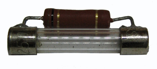

As far as 1R0 and 0R1 resistors for testing, what do I need to get? 2W?

Okay, so 2 watt 0.1 ohm resistors will be great. May as well put together some 1R0 "fuses" as well. I made mine using blown fuses, both AGC and GMA sizes. When you need one, they are invaluable.
1R0 1W - wired across the metal bits of a dead fuse. The 1R0 resistor replaces the fuse element and allows you to check supply current by measuring the voltage drop across the resistor. The deal is 1V = 1A so you don't need to do any mental gymnastics while you are holding probes, and generally watching ten things at once.
Don't go any bigger than 1W. The reason is that if anything is faulty there is a delightful curl of acrid smoke from that resistor that ever so gently suggests you should turn it off, NOW!
