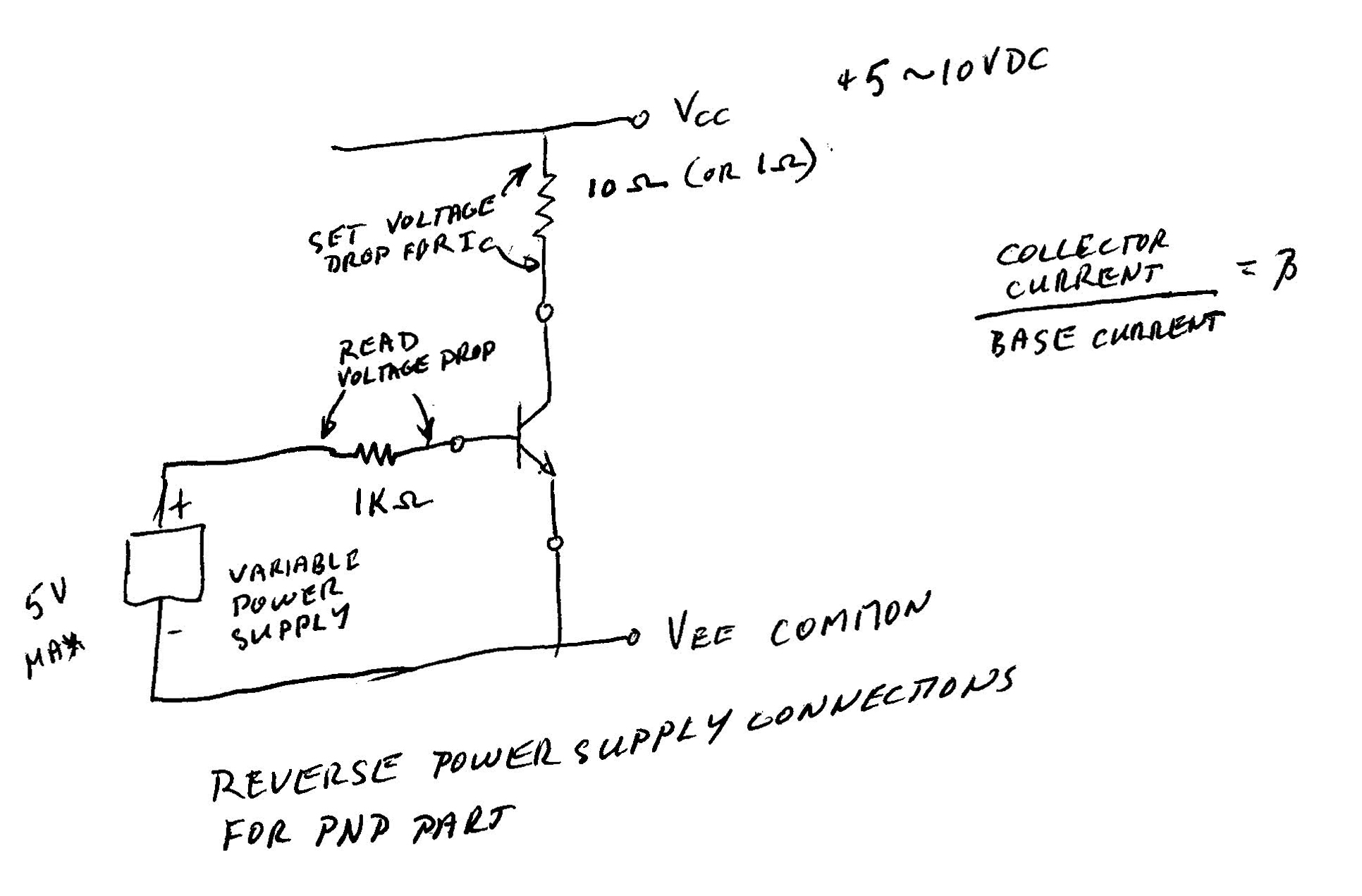

Testing and selecting a new set of outputs is a long and arduous job. Understand that there are no source resistors used at all. Also, these parts do not share current until the bias current reaches a couple amperes. So they hog current in the same way BJTs do. This means that your matching must produce extremely tight tolerance. I did this a few times myself, and it took me at least two full days each time. You need to start with 40 or so of each type. You will probably end up with one set for your 220, maybe two (great - a spare for the other side!), and maybe a few sets for SA-100 type amps. It's more difficult to get four in a tight match than it is to get two.
I discovered that:
What I would suggest you need to do this matching work:
You're going to set up what is basically an experiment. The first thing you're going to do is to group transistors according to gate voltage for about 100 mA flow (close to what your bias current will be). You can do this at a drain voltage of 10 VDC or so. A 20 VDC supply might be better, but keep an eye on the case temperature. You want to group all these when they are around the same case temperature. I find a touch of thermal compound on your temperature probe helps here.
Okay, all graded now? Good, time to match them. Mount four matching transistors on the heat sink and set for about 20 mA current flow. Run the drain voltage up to around 60 VDC to replicate conditions in the amp. Provide good air flow and try to keep the temperature down to 50 °C approx. You can use the drain voltage to regulate the temperature if need be, then measure the individual current flow through each transistor. Write this down on each transistor so you can't get them mixed up.
You should be able to end up with some very close matched parts, and some matched pairs as well. Understand that parts that don't match well are probably good in most other amp designs. Just look for source resistors to tell if you can use a looser matched set.
Let the fun begin!
- a good DVM that has a decent mV range and resistance function
- a power supply good for 6 VDC full scale,, or set it carefully with a meter
- a power supply good for 60 VDC, anything should work here within reason
- alternative, amp or receiver you can use a variac with
- a set of four matched 2 watt resistors, metal oxide suggested, at 1 ohm or up to 10 ohms depending on your meter mV scale
- four matched 1K00 resistors, 1/4 watt is fine, half watt is better
- electronic thermometer, I use a thermocouple bead, "J" type
- four "plastic" TO-3 (TO-204 now?) thermal pads
- heat sink drilled for four TO-3 devices, a good size so reduce temperatures
- two or more termnal strips to support the wire and resistors
- four TO-3 transistor sockets that can be attached to the heat sink
- heavy copper wire, #12
- lighter wire for base connections
Let the fun begin!
