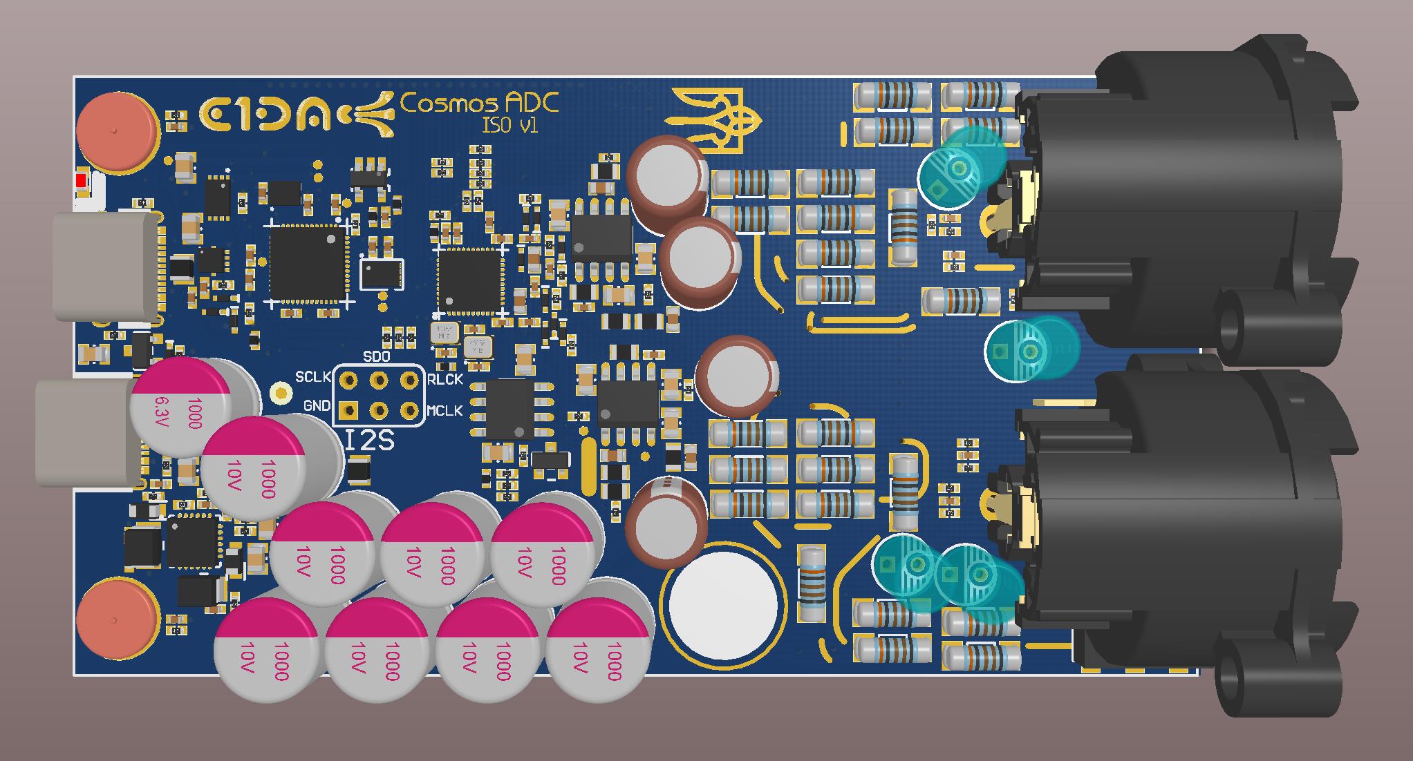

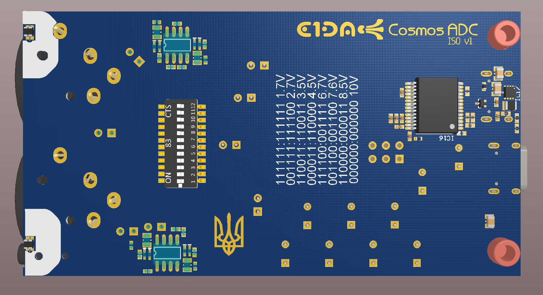

This is just a proto, I have no plan to add the buffer for a few reasons(*) but I'll probably keep these footprints for DIYers.
* reason #1 is the voltage limiting and power consumption(to get the same 10Vrms I need +/-16Vdc rails), the reason #2 is a high-impedance input protection which is more complex than just 2 diode clamps. Reason #3 is the cost of semiconductors. #4 I'd like to give smart people some advantages - more smart people around me = better life quality.
Also, a slightly improved crosstalk <-150db@1kHz(breathing around -153db, thanks to 4 layers PCB) when all unused inputs are terminated-shorted. And 10kHz H3@-.5db now is <-120db, if the H3 minimized for 1kHz. Two USB-C sockets, one for data, another for power. The ISO barrier + constructive capacitance(PCBA in the housing) is 9pF. Data USB-C cable with fixture! (thanks StaticV3 for the suggestion).

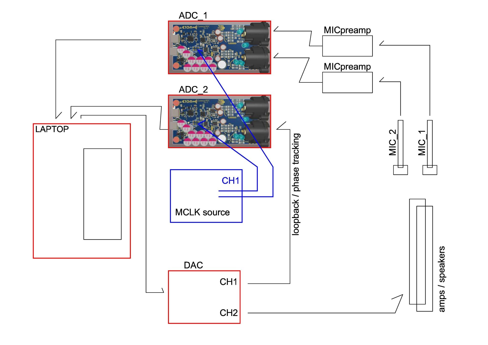

hi,
would it be possible to add "feature" to upcoming ADC? --> possibility to link two (or more) ADCs to sync them/ via MCLK (?
opt.A with external MCLK generator
apt.B connecting two boards with single wire for syncing (much easier from user perspective)
it would allow users option for using two or three measurement microphones and phase tracking (from DAC). i know REW can do acoustic timing, but this might expand funcionality a bit

At least two mics for differential measurement systems like ARTA. There is good reason to use a two mic system!
